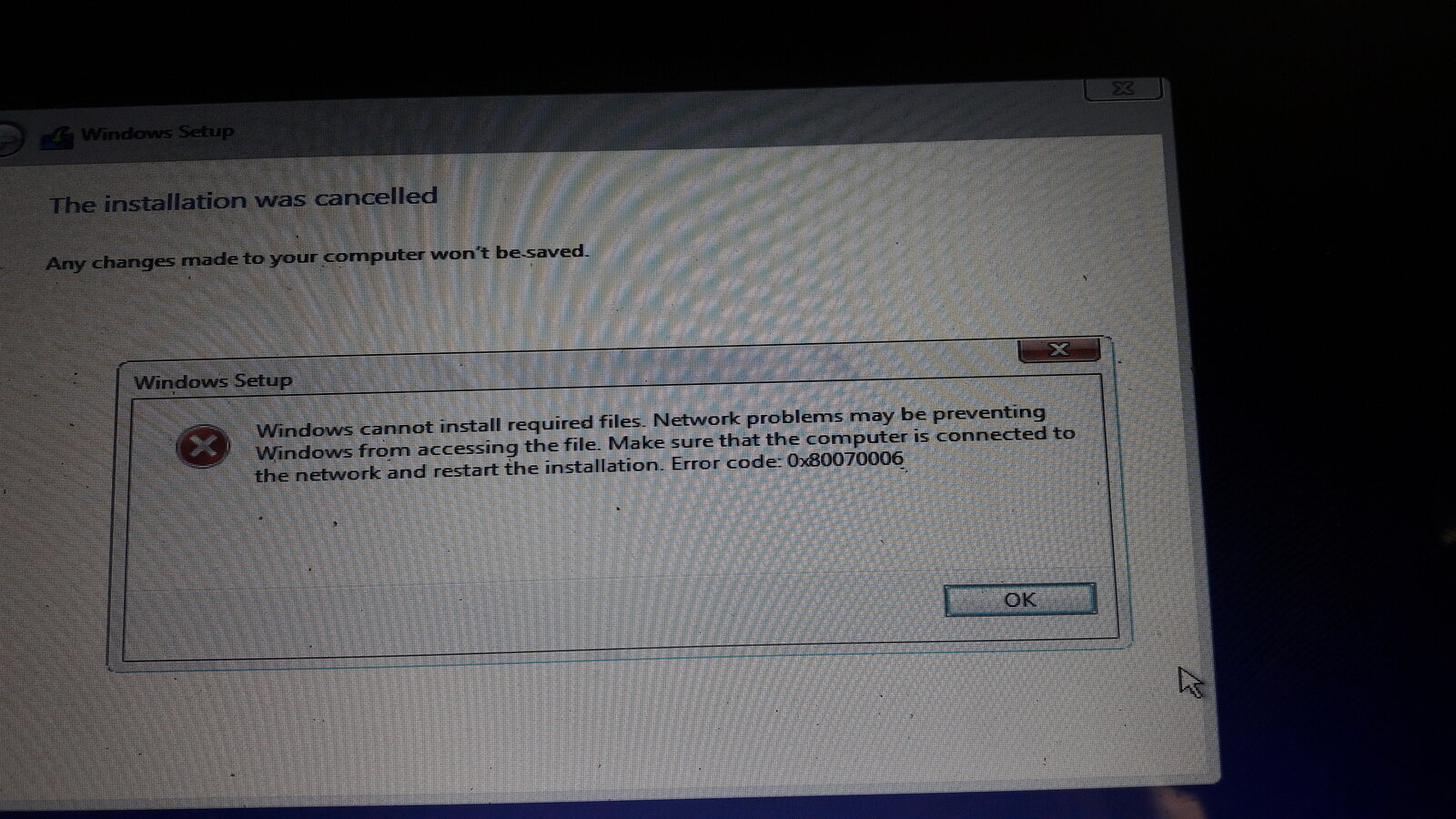

The repkacement laptop HD arrived today, so I installed it, switched the laptop on with the mem stick with the ISO tool loaded in and it seemed to be installing Windows fine until I got this message:
Should I have had an ethernet lead plugged in?
Thing is, the machine had gone thtough about a dozen cycles of installing 5G at a time which required me to key punch each time.
I'll give it another go with an ethernet plugged in but if anyone has any tips, I'm all ears.

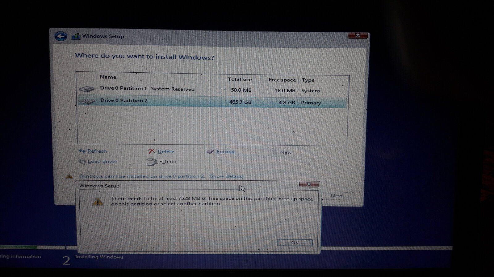

Plugged in an ethernet and Windows started installing again.
The machine has set 2 partitions. The first 'system' type installed v quickly but the 2nd 'primary' is a chore. It allocated 465.7GB and proceeded to install 6GB at a time, rebooting after each 6GB.
I am now in a position whereby the laptop tells me there is not enough free space on the partition it created. I am shorf by just under 3GB:
Can anyone help out here?
It's taken most of the day to get this far, I'd hate to have to start again.
If thats a new drive then why is there only 4.8gb free?
All my fault I'm afraid.
I had downloaded a 32bit version of Windows onto the memory stick and I think I was installing it multiple times, filling up the hard drive. I downloaded the 64bit version and it loaded perfectly.
