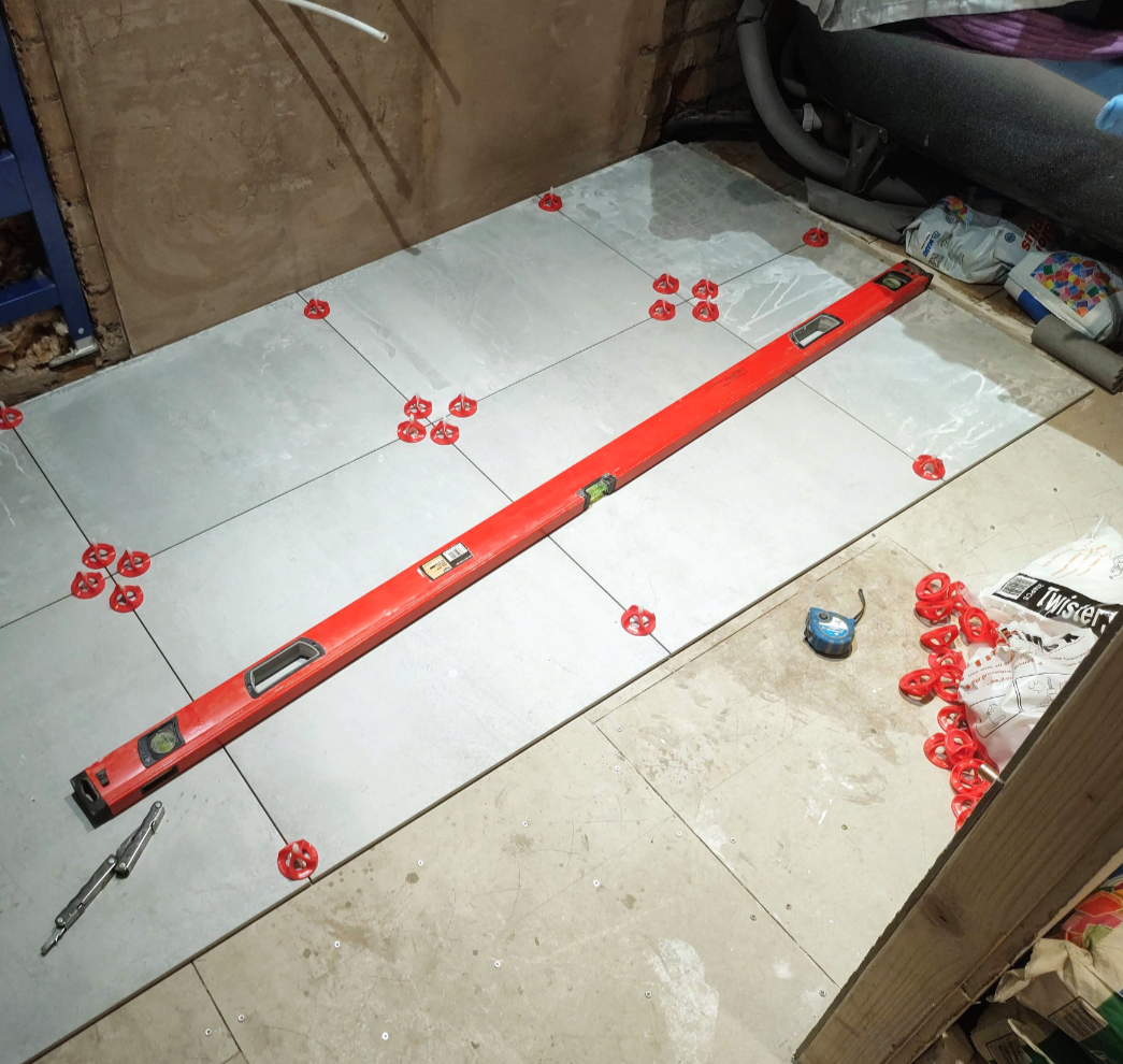

They will prep the floor so it is within the required tolerance of "levelness", they will use the correct adhesive bed thickness - determined by the flatness of the floor and the tile and will probably use a "tile levelling system".
This is my tiny bathroom and first time using tile levellers and it's gone pretty well - basically they hook under the tiles and using a screw or wedge system, pull the edges of the tiles flush with the adjacent ones, I think the adhesive acts like chewing gum and stretches a bit to accommodate the movement.
