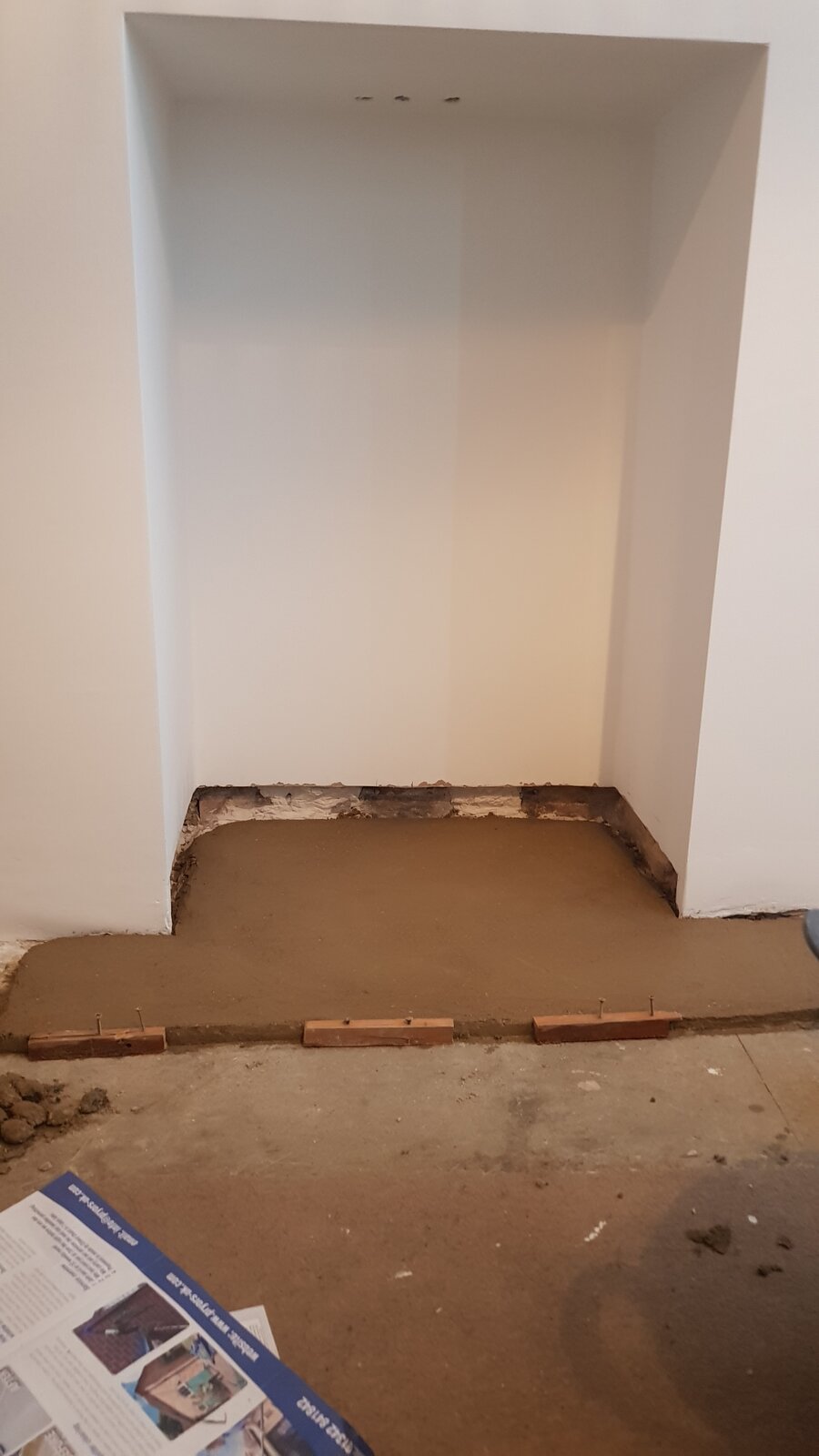

Hey guys,
I have a chunk of slate comming for my hearth, 30mm thick, I'm setting it above the laminate so I created a concrete bed around 2cm, so the boards will slide under to create a nice finish.
But I'm not sure what to use to stick it down, I want about 5mm, I was thinking flexible tile adhesive but not sure this correct?
I have concrete, sharp sand and nhl3.5 left, so I was thinking I could just lay it on some weak mortar mix?
What would be the correct way?

I have used gobbo to bed all types of hearths including Marble.

You should be fine - just use whatever you have to hand to mix a bulking up and adhesive mix.
Lightly butter the back of the slate before dropping it into place.
Presumably you've made a template and then dry fitted the slate?

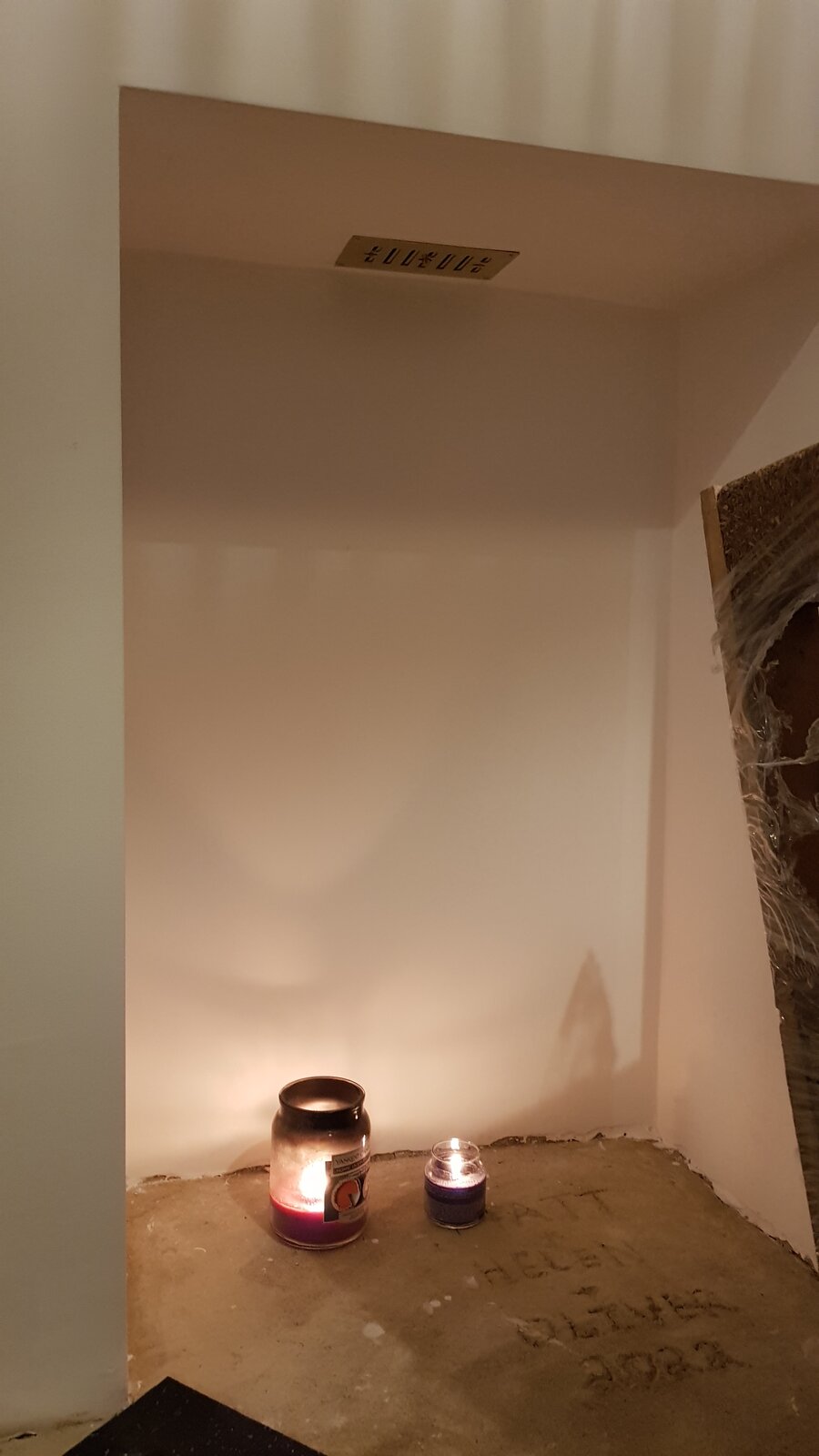

I notice 3 x holes in the fireplace soffit - are these holes for flue ventilation?

And yes the holes are for ventilation, I've got a bio burner going in there so I like the idea of some of it the co2 going up the chimney.

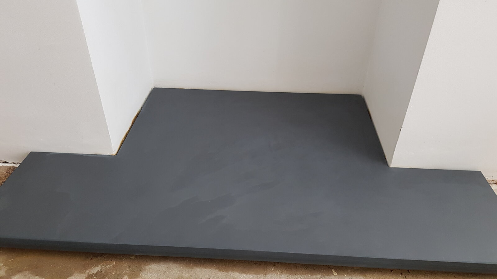

Shes down, cheers for the help guys. Was a nightmare tbh.
For anyone doing this the advice i would give is I make a wetter mix and super soak and concrete, the concrete was sucking the moisture out of the mortar even after soaking wet.
