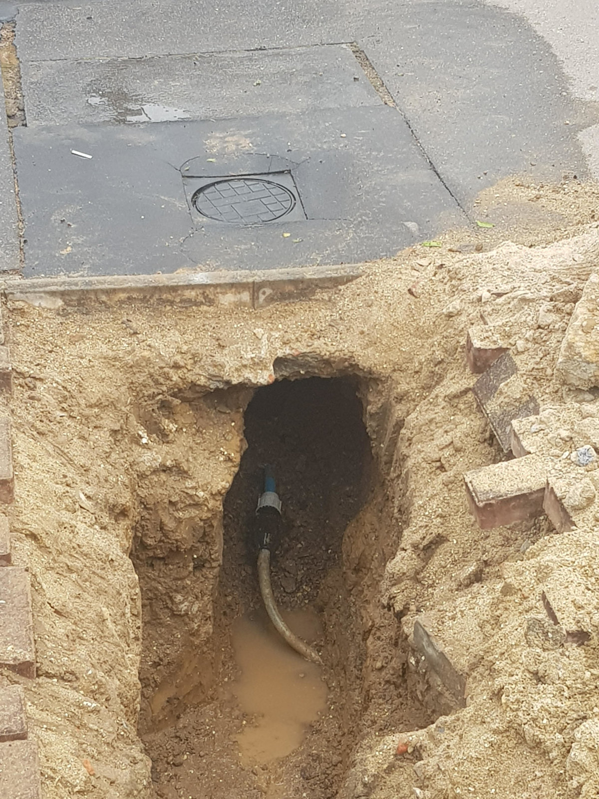

I have found the meter box and pipe. There is a circa 300mm length of 25mm plastic from the meter connecting to the lead as picture below. The connector is give or take on the boundary line.
So is it ok lay my new 32mm pipe and then swap the 25mm>lead connector for a 25mm>32mm. Then at the other end stick a 32mm/15mm stopcock to connect back into the household cold feed in the garage. When the internal plumbing gets replaced later in the year the stopcock can then be replaced with a 32>22mm/28mm once the plumber knows what is needed?
One other thing, the meter box in the street has sunk a bit which pools water. Is it ok just to jack it back up with a bar and pack out below then type 2 back to the boundary line.
Yes, that's ok.
Yep jack it up while at this stage, provided it can be. They will not know. You may want to make good the pavement around the box - it is you who walks on it suffering if not right. Get them to do it? Forget it. You will wait and wait.
I wouldn’t jack it up, I would just inform them that it’s sunk.
If you get a 25-32mm Plasson fitting you can use their white nut and it will make your connection easier.
Probably best to leave that to the Water Company to deal with. Jacking it up might cause the joint on the other side of the meter to fail and burst. If the Water Company do it they sort out the mess and costs. If you do it the the Water Company still have to sort out the mess but you then sort out their costs.
When a similar situation occurred near here the Water Company simply added another ring to the top of the meter chamber.
Under the National Roads and Streetworks Act, (NRSWA), Utility Companies 'own' their reinstatements. Given that the meter box is in the Public Highway, it is the Water Co's property and responsibility, and the reinstatement has failed, let them deal with it.
As said, if you attempt to alter it and it then gets damaged, or someone trips over it and sues, you may be billed for any remedial works/losses incurred. I'd leave well alone, just make sure your backfill is consolidated correctly, so they cant blame you for undermining the pavement.
