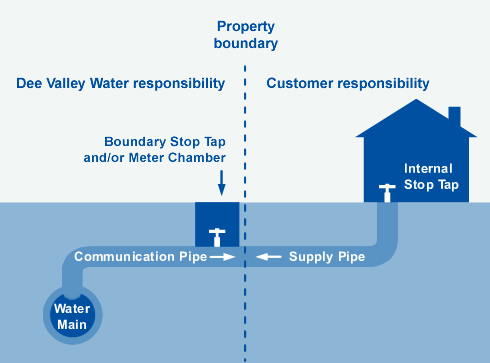

Query is should I get the communication pipe replaced which is almost certainly 15mm?
People generally seem not to and get much better flow just from the new 25mm pipe run.
Thames Water want £500+ to replace the communication pipe....
If its relevant I do have a water meter.
Thanks.
What do you mean by the communication pipe?
Its the pipe that runs from the water meter / stop cock to the water main in the street (see diagram below).
