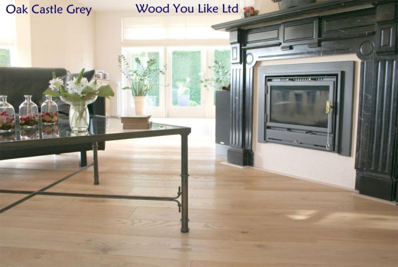

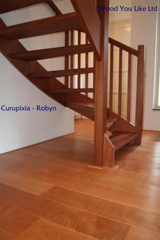

  6. WoodYouLike
    WoodYouLike
    Joined:
    14 Nov 2004
    Messages:
    7,710
    Thanks Received:
    215
    Location:
    Kent
    Country:
    Flat beading in front of skirting boards looks lovely! ;)
  7. mattysupra
    mattysupra
    Joined:
    30 Jan 2007
    Messages:
    2,256
    Thanks Received:
    50
    Location:
    West Midlands
    Country:
    Have you any pics of your flat beading installed? Would like to see ;)
  8. WoodYouLike
    WoodYouLike
    Joined:
    14 Nov 2004
    Messages:
    7,710
    Thanks Received:
    215
    Location:
    Kent
    Country:
    Hope this works.
