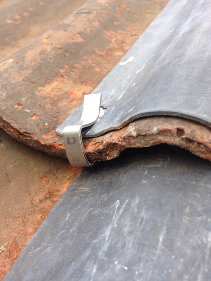

Does anyone know of a clip to hold down lead flashing onto the tile. I have a scenario where I could do with a sprung loaded 'C' clip to go on the bottom of the tile edge on a verge which will hold down the lead to stop high winds lifting it.
Google valley tile clips. These may help depending on the thickness of the tile. About £5 for 50 at your local roofing merchants. You can always pack out thinner tiles.
My tp branch had a bag in stock. I bent the end up and then squeeze them down and they fitted perfectly.
