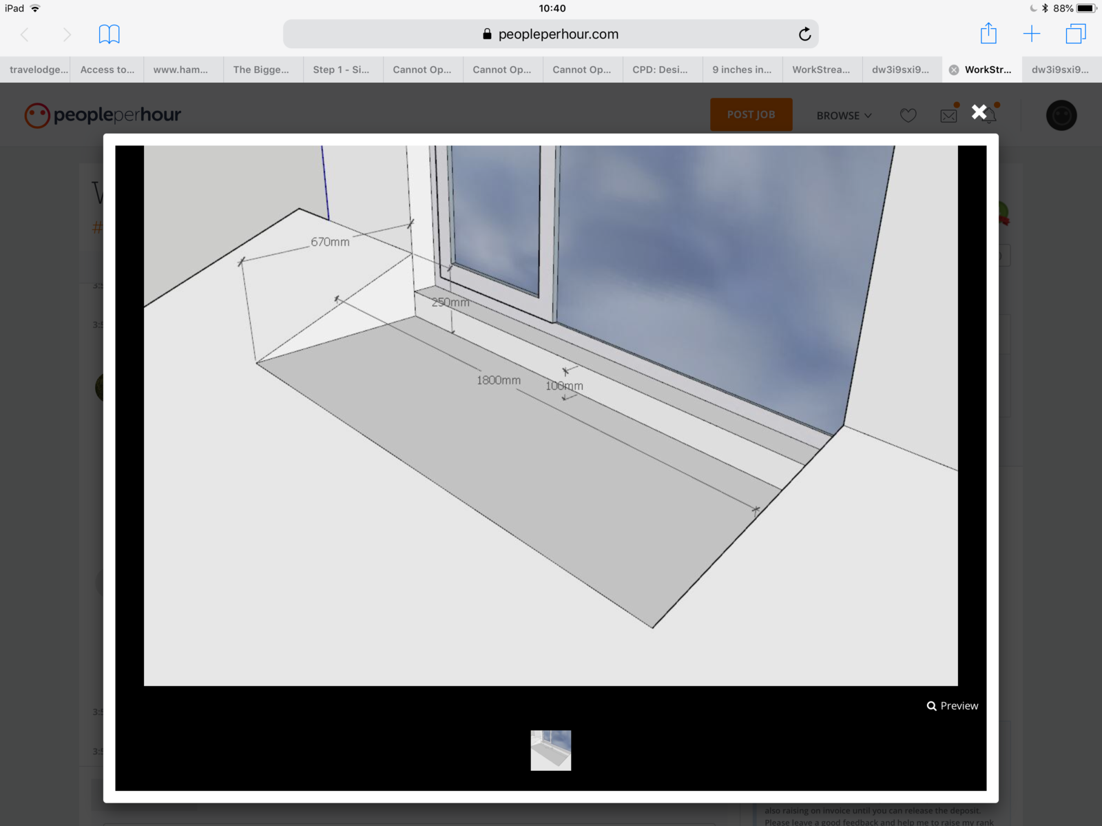

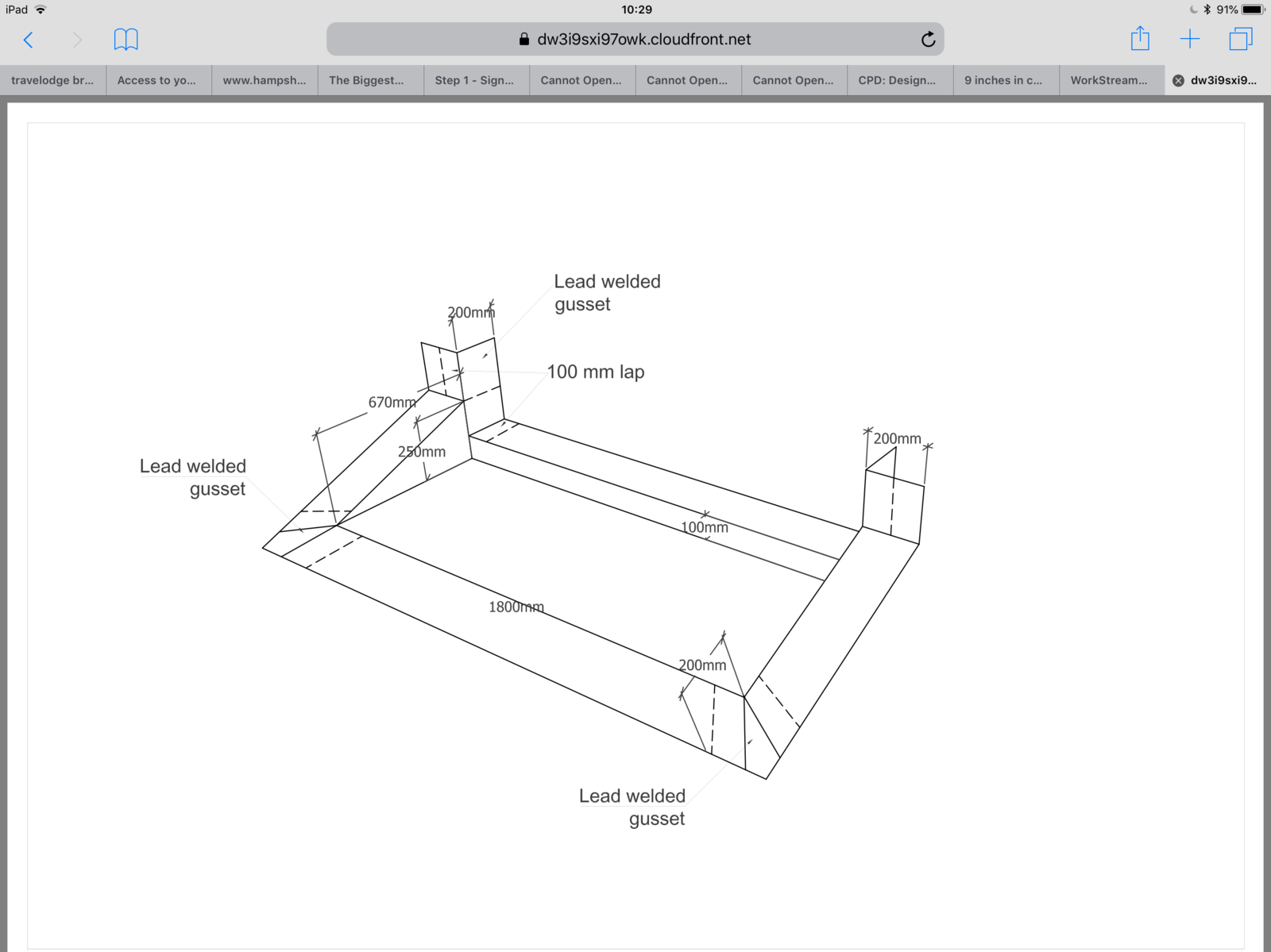

hopefully the pics uploaded. Trying to work out how many days it would take for this lead work for an inverted dormer. Is this more than amdays work plus materials? So I know if I am getting the correct quoted. So far quotes for other work have been so far different, no rhyme or eeason for same work. Quite happy to pay fair

Sorry yes, just wanted to know what was reasonable. 600 plus vat. In Southampton thank s
It sounds quite reasonable.
They will need to buy a 6m roll of 600mm code 5 lead,
Bidding felt, gas and oxygen,
Copper nails.
Maybe copper clip and also patination oil.
£600 for two is dirt cheap even with access provided.
everythin on site at 8 in the mornin an it would be done by 4:30 afternoon.
if anyone gave a price based on your info then they dont now what ther doin.
the list posted above is incomplete an irrelevant. all you need to now is what code they intend to use?
the diagrams wont work - thers a lot more detail needed. anyone workin off them would soon run into trouble.the lead worker, if ther any good, will now how to do it
two things.
thats always a tricky dormerdesign detail an best avoided if at all possible.
leads the best material but ther are other cheapermaterials besides lead can be used esp if theft is possible.
