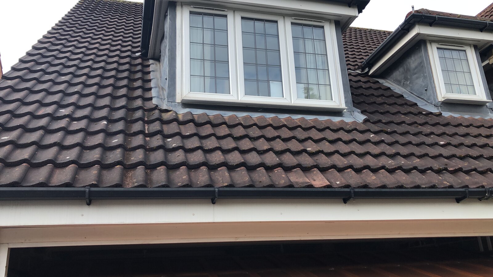

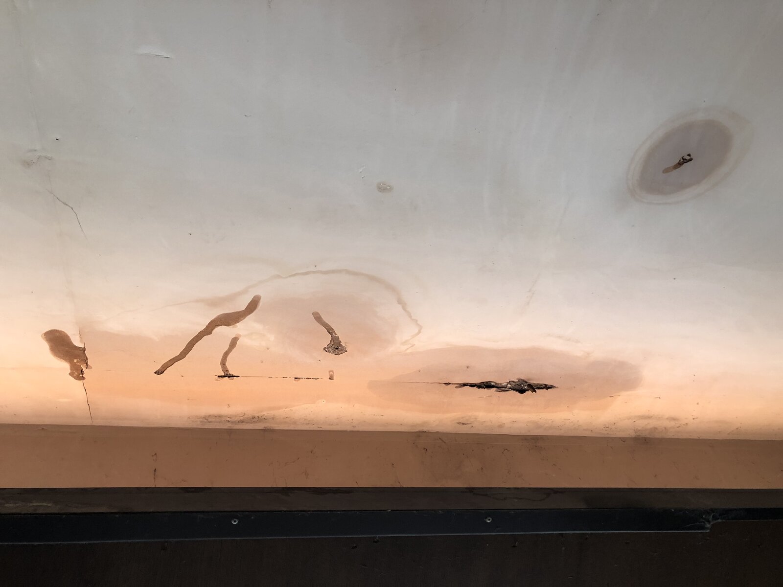

Hi I noticed today a leak above the garage not sure why as the tiles look good and the flashing looks ok. Any ideas please

Have a look in the roofing forum for similar posts related to defective eaves felt and see if the conditions match.
as others have said left side of dormer bottom corner tile is broken
lead to side cheek is in trouble
