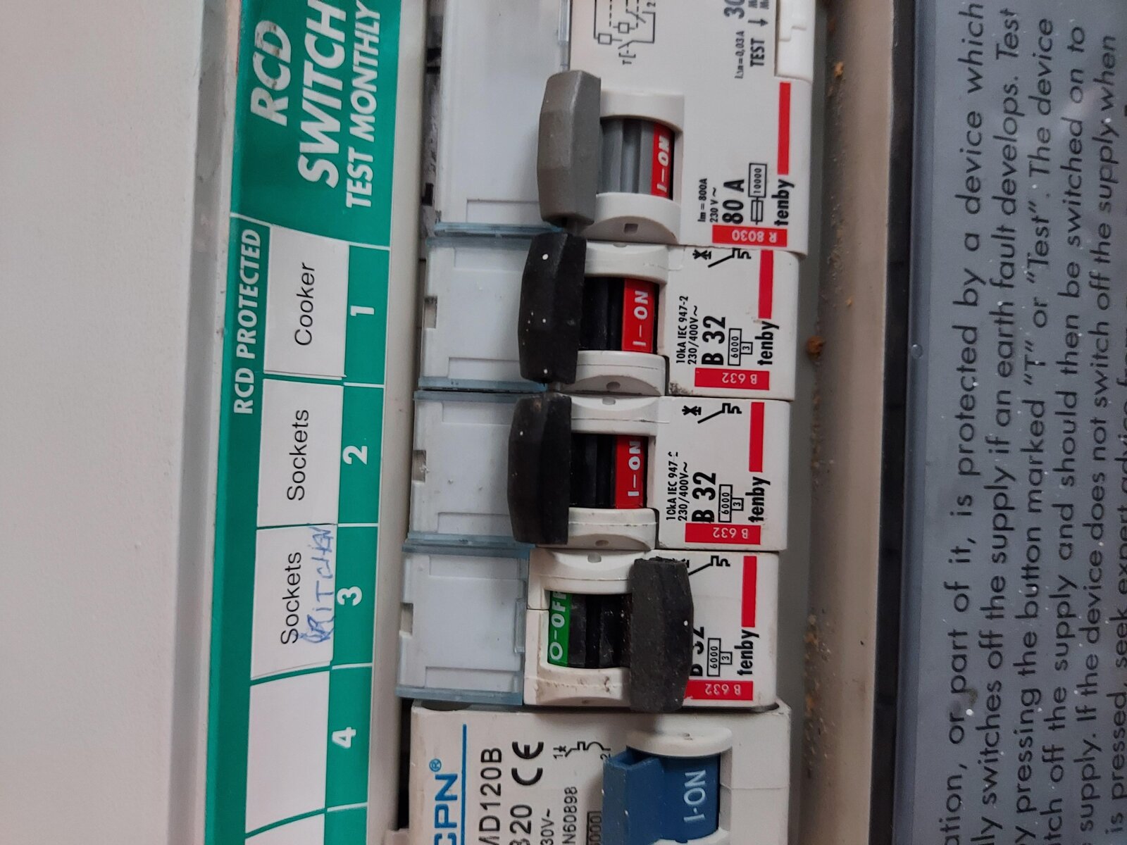

It's not clear from your posts how many socket circuits you have; which are protected by an RCD, and which have stopped working.
post some photos of your consumer unit, close enough to read the labels.

All of these currently not working because they must be using the circuit marked sockets (kitchen). When I try to switch this back on it trips.
2 sockets near cooker - which happen to be near where there used to be a wall. So I assume these are from the standard "sockets" circuit because I guess this used to be in the dining room.
Cooker working too.
Sounds a bit dodgy to me ?
Number 3, "sockets kitchen" has tripped on a short circuit or overload. I see no RCD tripped.
