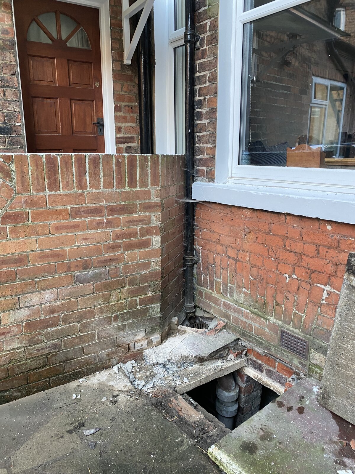

I have a rear gully which is leaking and I think is responsible for the damp on an internal spine wall.
I need to dig out the gully and want to move it to the right so it is a bit more away from that corner.
This house was converted into flats in 1965 so I think the drain set up was changed then. Originally there was a door into the cellar next to the old clay pipe.
Question: what coupling do I use to connect into the clay pipe. I want to connect when it is in the vertical position and then I will add backwards in plastic. I will probably do the last leg of the downpipe in plastic as well and angle it at 45 degrees to the right.
My other worry is, could the soil pipe wedged in the corner also connect into this gully and so use the large clay pipe? Or will that go all the way to the bottom and hit the floor with its own pipe?

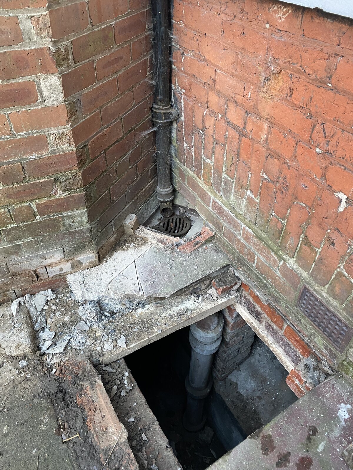

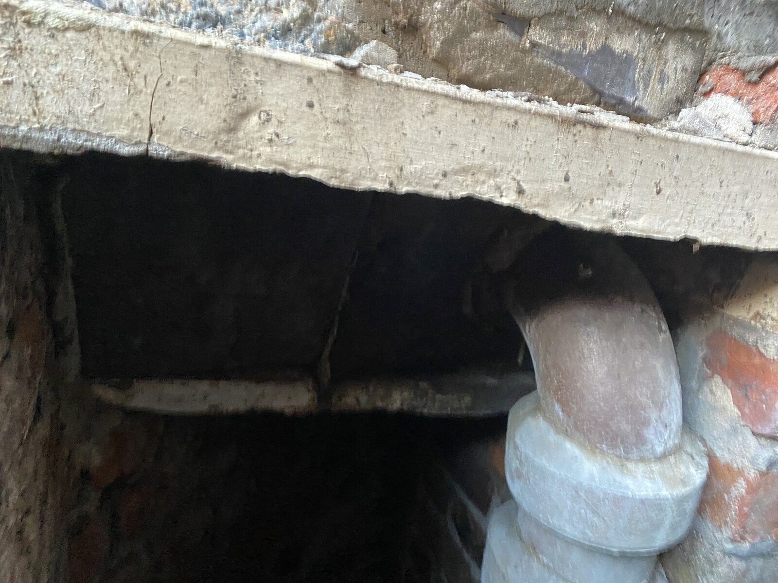

anyone know the size of this clay pipe and what product i would use to adapt it to plastic. Ideally I would use an adapter which pushes into the clay pipe rather than the rubber adapters with clips.
I only know the fernco type adaptors. I've used a couple in my time. Seem pretty robust. I guess eventually they will crack but they are used very widely.
You need to measure outside circumference like with a string or flexible tape measure, convert to diameter. Usually 120 to 130mm range.
Have you considered the gully is not your problem? Where is it leaking. How does the garden separation wall abutt the brickwork, looks like that would be a place of focus to me. Is damp visible in that area inside?
I can see the water coming out underneath when we put a hose in the gully. So def an issue with the gully or the pipe coming off it
There is no damp on that back wall. You have to go into the building and it’s the spine wall in the middle which is affected. It’s all just been tanked again as was done in 2008
I am a new owner of my top flat so doing some investigations and now found this rear drain is leaking. I can’t say this is the source of the issue but I must fix it first and then wait I suppose
You get a couple -
Mcalpine do a finned one - It's a DC1
Polypipe do one too - UG459/486/487
The other mains soil/drain pipe specialist will have their own (OSMA etc)
The original bend will need to be cut out carefully, or cut below the bell end (ooer) but can't really see if that's another coupled end below it too?
I would presume the rainwater down pipe would use the same gully yes, you may have to repipe that somewhat too, to allow it to drain as well.

Looking down there we have now seen this gully leaking a lot into that gap area left to protect the clay drain pipe. So every time 2 flats above have a bath or use the sinks water comes into this area. Plus the roof water goes down here when raining.
