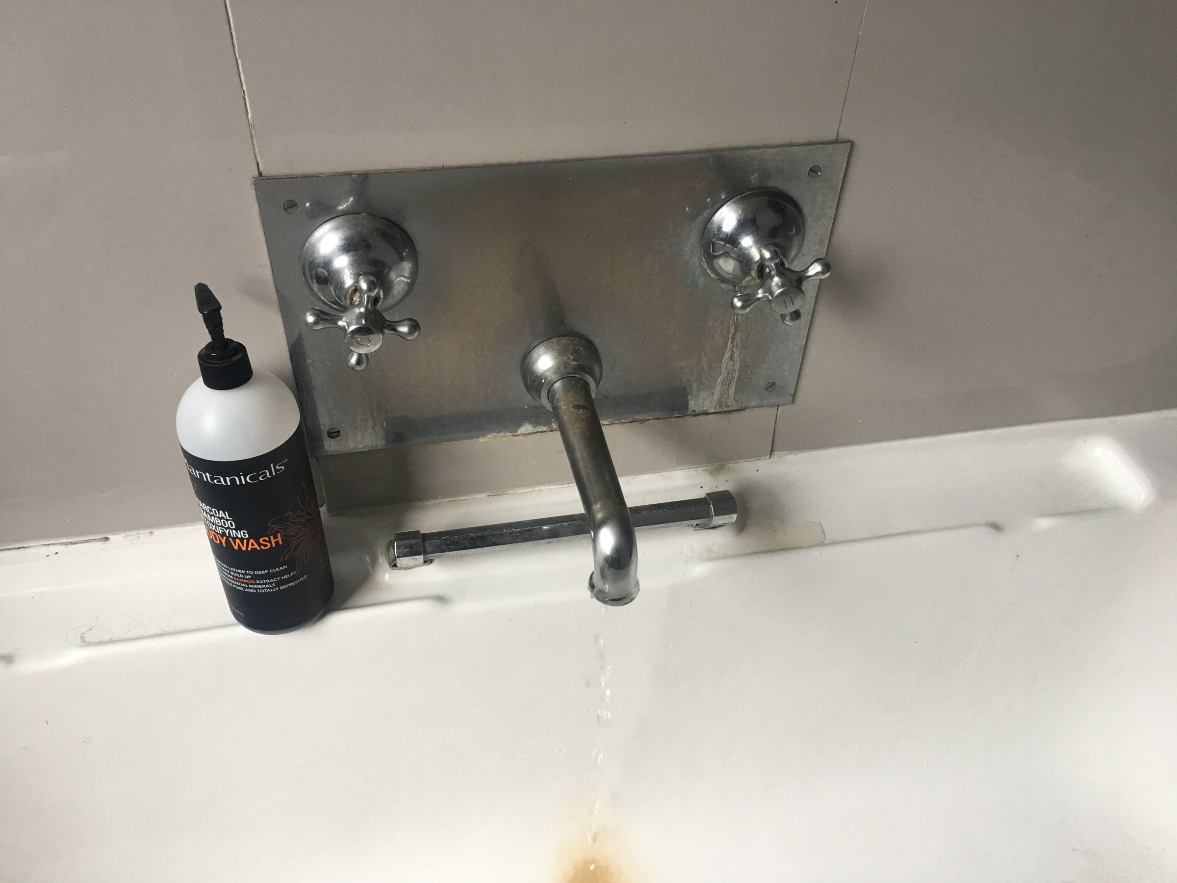

dont really do a lot of this type of work. The tap is leaking pretty bad, guessing just removing the bell shaped cover will expose the tap and then hopefully file flat and replace the washer?
full
Yes, take the cross head off, remove the shroud and that should let you into the valve. Undo that and replace the washers.
After you've turned the water off of course.
Put the plug in the bath as well (saves you having to strip the trap when you drop the teeny screw holding the taphead on) and a towel in the bottom of the bath stops you damaging the enamel when you drop your spanner :)
Reckon a replacement cartridge would be a standard fit or is there a standard washer size?
I take it it is a screw down tap, not 1/4 turn? if so then it wont be a cartridge, it'll just be a 1/2" rubber washer but you get different types depending on the jumper type so you want to take it out to take with you to match it up. Do remember it'll be well over compressed so the new washer may look nothing like the old one but the supplier should be able to advise.
you can buy packs of black rubber washers in 3/8, 1/2 an 3/4, an with both flat an beveled surface washers.all incl in one cheap pack.
but first, as above, remove the old washers.
after pullin the valves shine a light in to examine the state of the tap seats.
the taps are badged wrong - the hot should be on the left but maybe the valves been piped wrong, chesck it out?
it might be worth takin off the cover plate an seein whats goin on behind it - thers probly a small allen/grub screw underneath the spout collar.
