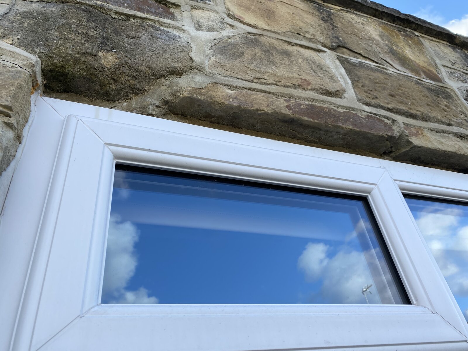

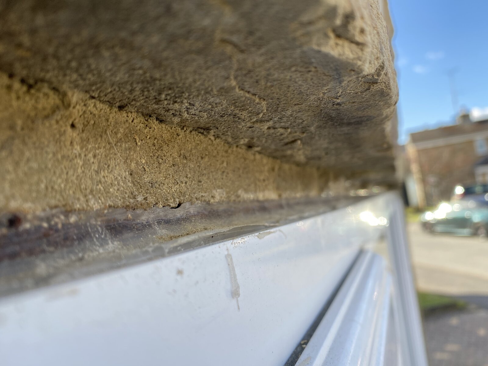

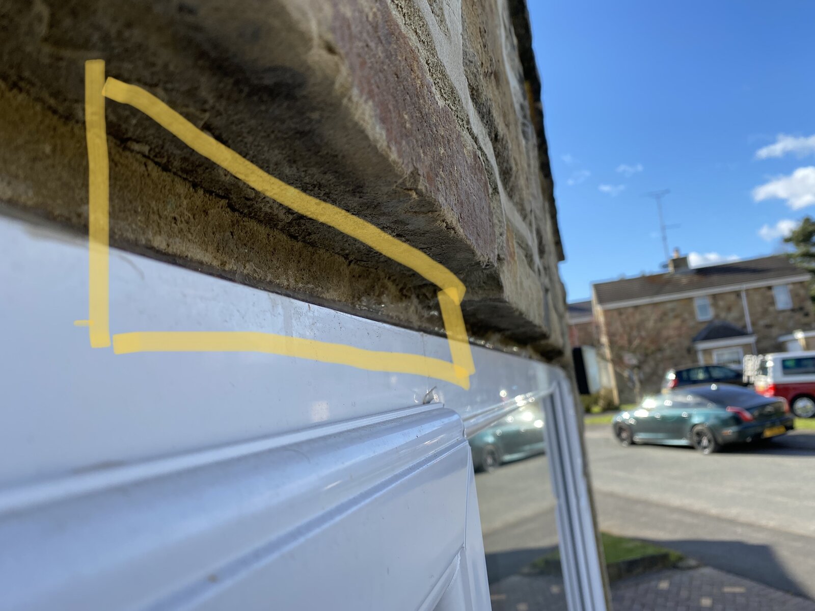

Hi, could anyone advise on the best way to stop this window leaking at the top please? It’s not been fitted very well and so water seems to be running down the outside wall and then it gathers on top of the frame itself.
I was thinking a flat piece of trim stuck to the top of the window and pushed up against the bottom of the overlapping stone above and then sealed with silicone but would appreciate any suggestions.
Cheers!

Is that window sitting proud of that concrete filler? If so that's a poor job by the fitter!.. yes a bit of vertical trim from window up, covering concrete fillet should be fine

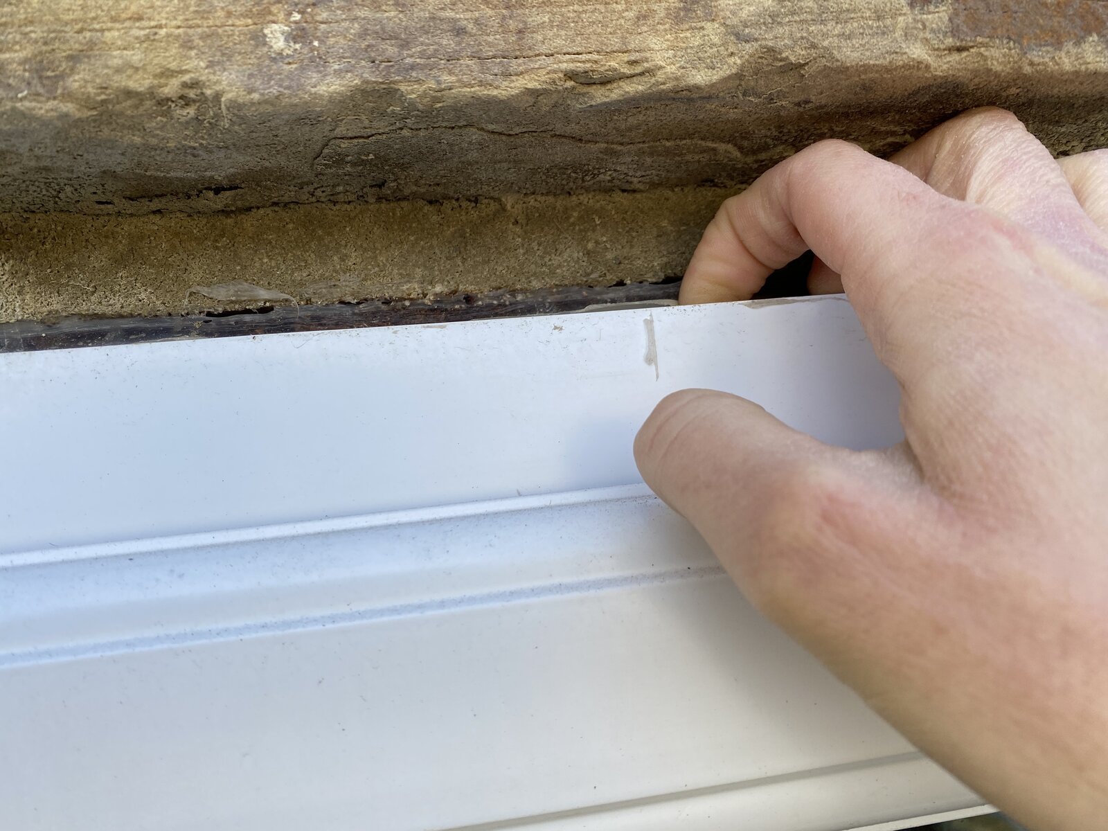

Yes I’m afraid so and to compound matters there are points all along where I can easily push my finger past the silicone they’ve used to try and fill the gap and touch the window frame.
Thanks for your reply, I’ll get that sorted ASAP.
