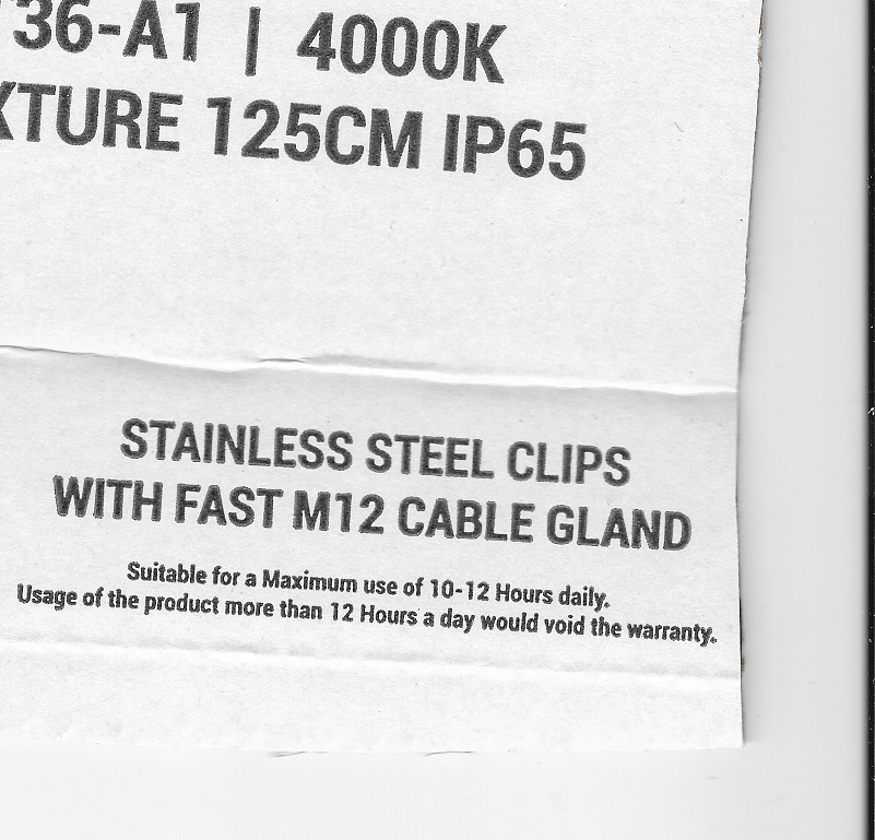

I installed two LED battens last week, disposing of the cardboard today I found this "limitation of use" printed on the box.
I will be notifying the supplier.

The item has a rated life time of 25,000 hours.
This "rating" is almost certainly the Mean Time Before Failure (MTBF) for the items Some items will have a (Time Before Failure ) TBF much shorter than 25,000 hours while others will have a longer TBF
"" LONG LASTING: 25,000 hour rating with a 2 year guarantee. ""
The 25,000 hour rating is probably the mean of the TBF ( Time Before Failure ) values for a large quantity of the item.
Maybe the manufacturer is setting conditions of use that ensure lamps with a TBF at the lower end of the range of TBF will remain working until after the guarantee period has expired.
Being "ON" for 24 hours a day for two years would be 17,520 hours. 17,600 hours could easily be the lower end of the range of TBFs
Being "ON" for 12 hours a day for two years would be 8,760 hours. A lower end TBF of 8,700 hours for some of the units is not impossible but I would consider it to be too short.
