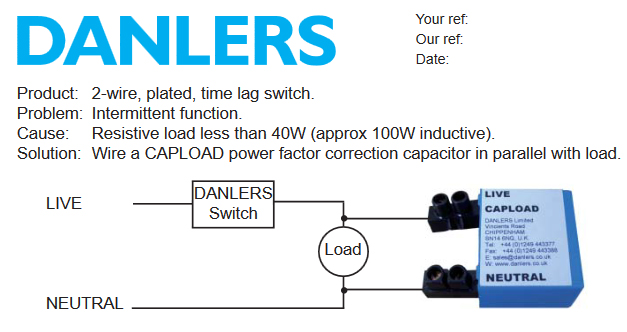

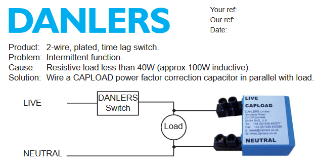

To work some electronic switches, not only dimming switches, a very small current is passed through the bulb even when off to work the electronics, if the by-pass resistor in the bulbs is not large enough, then the bulbs will flash.
Way to stop it is a capacitor across the bulb contacts load-capacitor.jpgor different bulbs, or a dimmer/switch which uses the neutral, or has a battery in it, or simply use smart bulbs and remove the dimmer.
Way to stop it is a capacitor across the bulb contacts View attachment 419113or different bulbs, or a dimmer/switch which uses the neutral, or has a battery in it, or simply use smart bulbs and remove the dimmer.

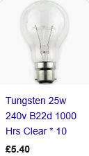

Likely a tungsten bulb will work, and if mine, that's what I would do, for the amount of time the lamp is on, cost or heat unlikely to be a problem, just use a tungsten bulb.

You can still get tungsten bulbs 1785054383393.pngthey are more expensive to getting a smart bulb, but that's the easy way out.
I know I still have a draw full of them, should really put them in the bin. Do you live anywhere near me? Can't really post them.

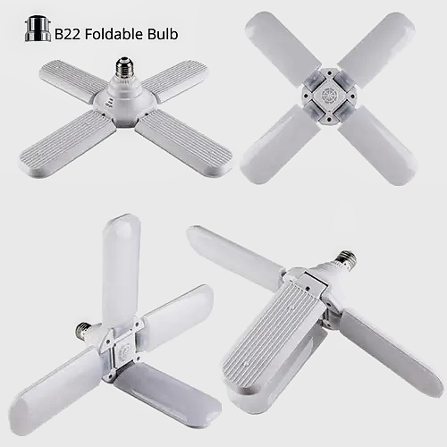

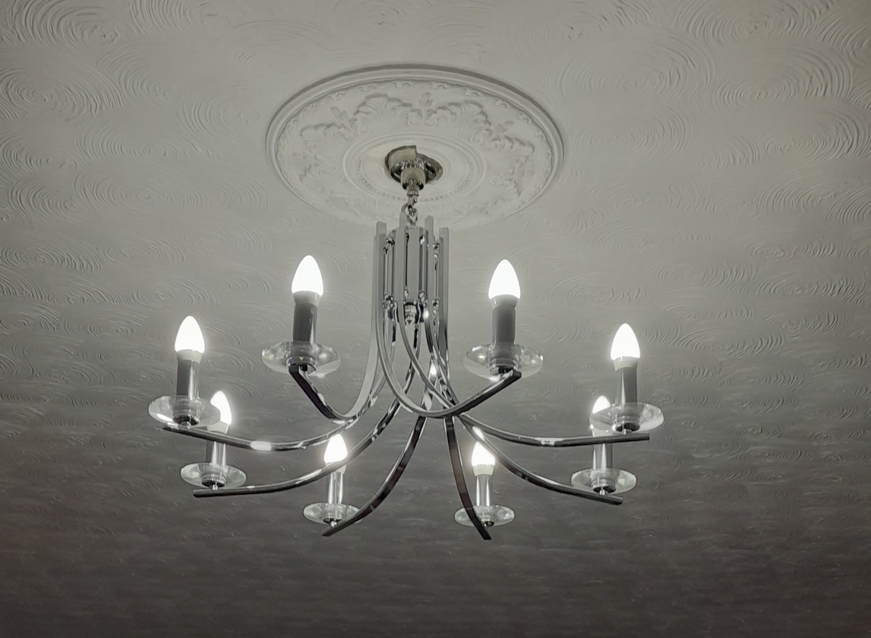

Come on, be fair, we have all been caught out with LED lights, big 60 watt written on the packet, only when you read small print do you see 12 watt really, when I moved in here, clearly had been a 100 watt, or even 150 watt pendent lamp, since found bulbs with wings at 40 watt, Folding bulb.jpg but a 12 watt bulb sending all the light away from the base, so nothing reflected from ceiling, so forced to get a multi bulb chandelier Ceiling light.jpg to get anywhere need to lighting the room.

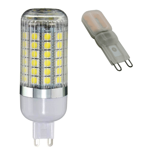

My wife getting a G9 chandelier for her bedroom was a nightmare, in the end we did find bulbs that worked G9-comp.jpgbut the covers no longer fit.
