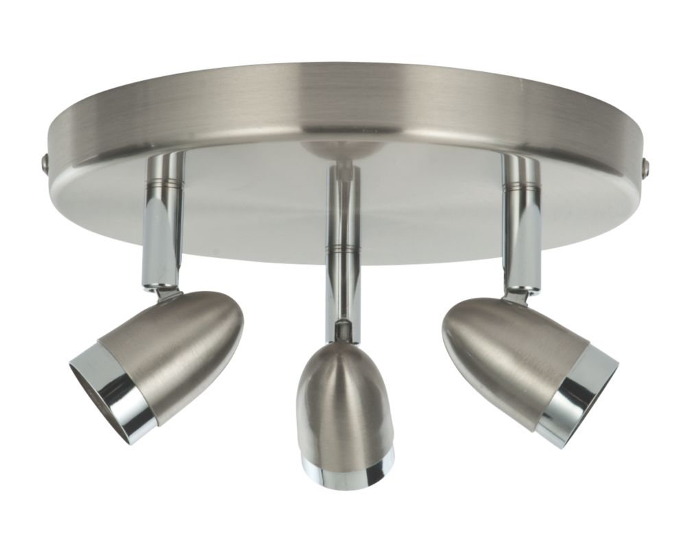

Point to note with those multi fitting ceiling lamp efforts- I've just put one in my bathroom (3 LED things on stalks on a plate)- the stalks are adjustable to quite a high degree which is handy, it is pretty good for its primary purpose (light for washing and shaving and similar uses) but rubbish for secondary purpose (allowing me to read when lolling in the bath). The low-rent pendant 100w equivalent lightbulb with a shade on it was good for both...
Possibly the LED "spots" do not have a very good beam? Many have a very wide flood, just the basic 120 degree LED spread, which aren't great for reading in the bath. I've found the prehistoric R63 spots to be good for this. Of course an alternative is just to fill the whole room with plenty of light.
From the other angle, proper spots with a beam angle below about 40 degrees are poor for lighting the whole room unless you have quite a lot of them. Three isn't really enough unless you use flood or wide flood bulbs (some LEDs, old R80, etc.) or have very high ceilings to let the light spread. Quality bulbs help. Some spots have a terrible spread, dark spots in the middle, or rings of light and dark. Low voltage halogen MR16s are usually very good with an even tight beam over a reasonable angle, but LED versions are all over the place.
