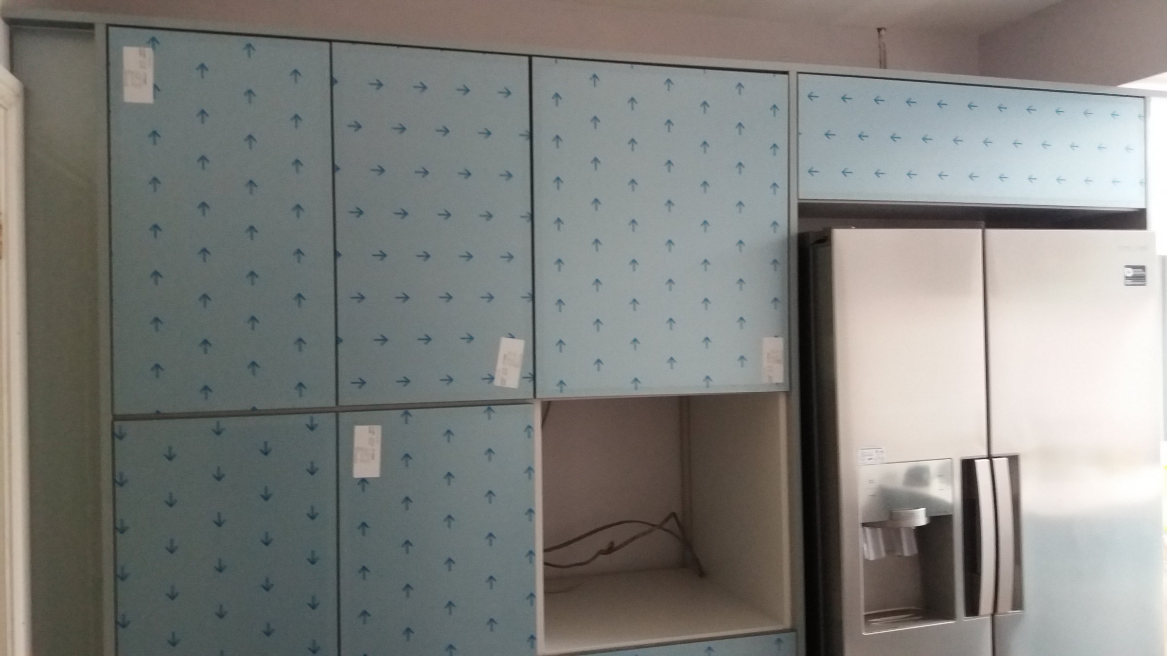

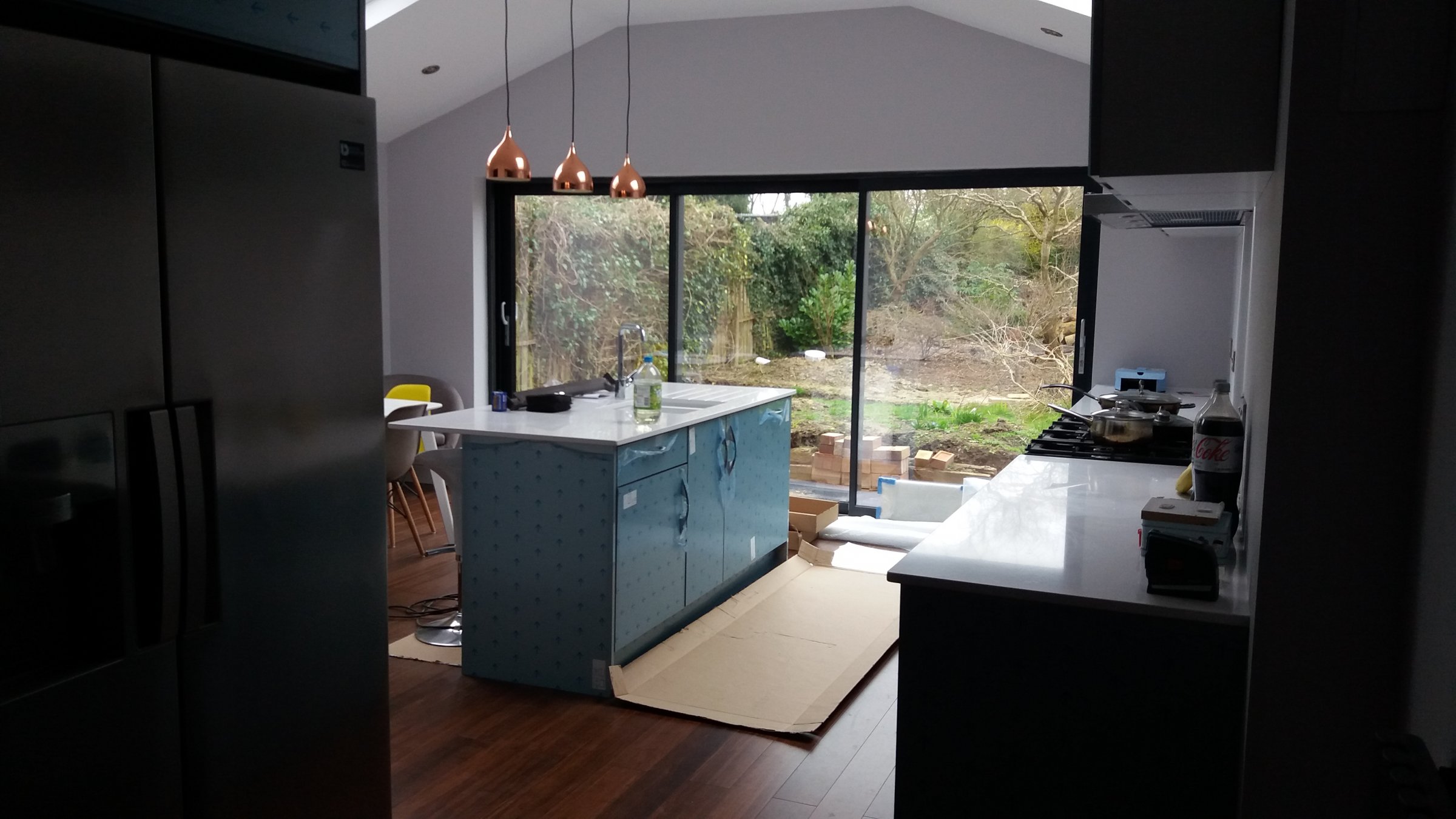

Hi, we have fitted a new kitchen and wanted to install LED striplights inside a couple of wall cabinets, as plinth lights on base units and under a worktop on the island. The wiring has been put in place by an electrician but we are installing the lights.
Can you buy one large roll of striplights and the drivers separately and make them up? I've looked into kits (which is what the electrician buys) but they would work out quite expensive as we would need at least 6 because of the way the kitchen is set up (2 x 1.6m run either side of cooker, island, separate 1.4m run tall cabinets, 2 separate wall cupboards). I'll post some photos up, any advice on best way to do the lights or opinions on whether we are going a bit overboard with them. There is also a dining/seating area and we wanted to be able to have soft lighting for relaxing in the evening!
