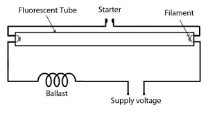

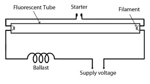

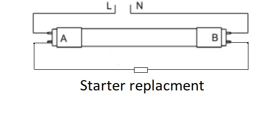

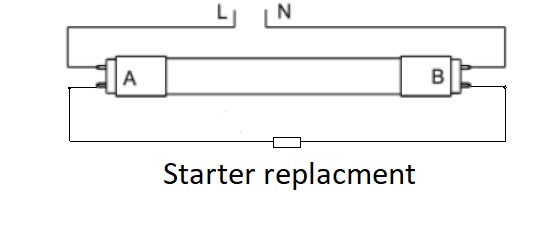

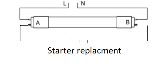

LED tube wiring.jpg The tube only needs power at one end, but unless wired in series as shown, putting the LED tube in the wrong way around would be a direct short, the ballast could be left in, it will get a little warm, so clearly using energy, so better if removed, but only when it has a HF ballast does it need removing.

View attachment 398397View attachment 398396 The tube only needs power at one end, but unless wired in series as shown, putting the LED tube in the wrong way around would be a direct short, the ballast could be left in, it will get a little warm, so clearly using energy, so better if removed, but only when it has a HF ballast does it need removing.
By virtue of the fact that the bulb is working, does that mean that it was inserted in the correct orientation (by chance- 50/50)? Or with the type B does it not matter which way around the bulb is orientated?
