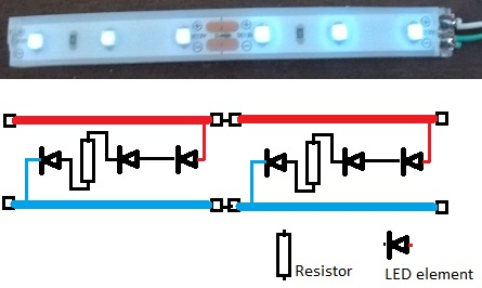

My route when I am finally forced to use LED lighting will be based on the method used for LED strips
Three elements in a cluster and a suitable resister.
Dimming can be easily achieved by varying the DC voltage supplied to the cluster.
By under running the LED elements ( lower current through them ) increases the life of the elements. Running 12 Volt strips on 9 Volts still gives plenty of light and at the same time assures minimal migrations in the semiconductor structure of the LED elements.

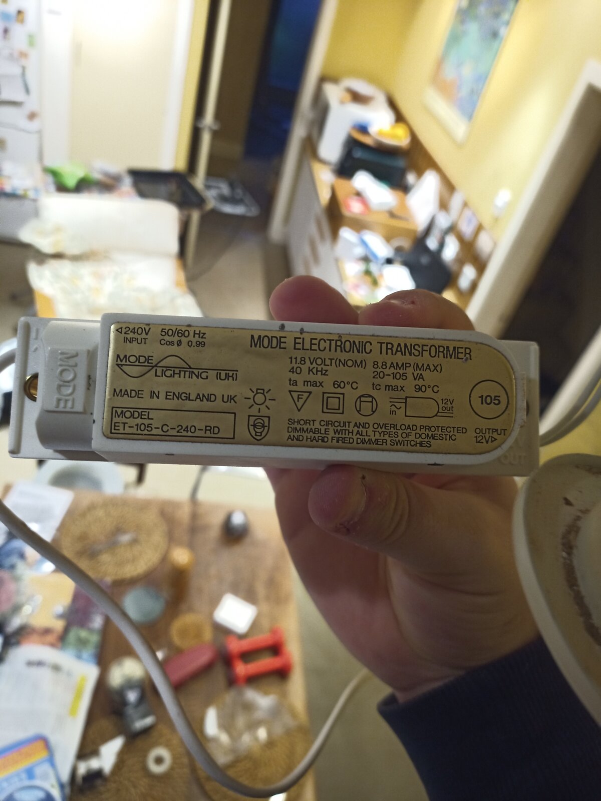

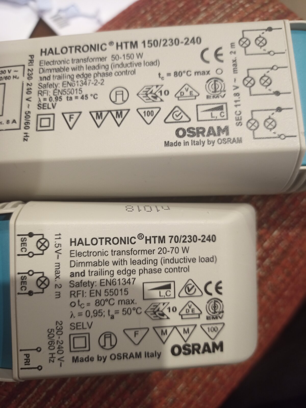

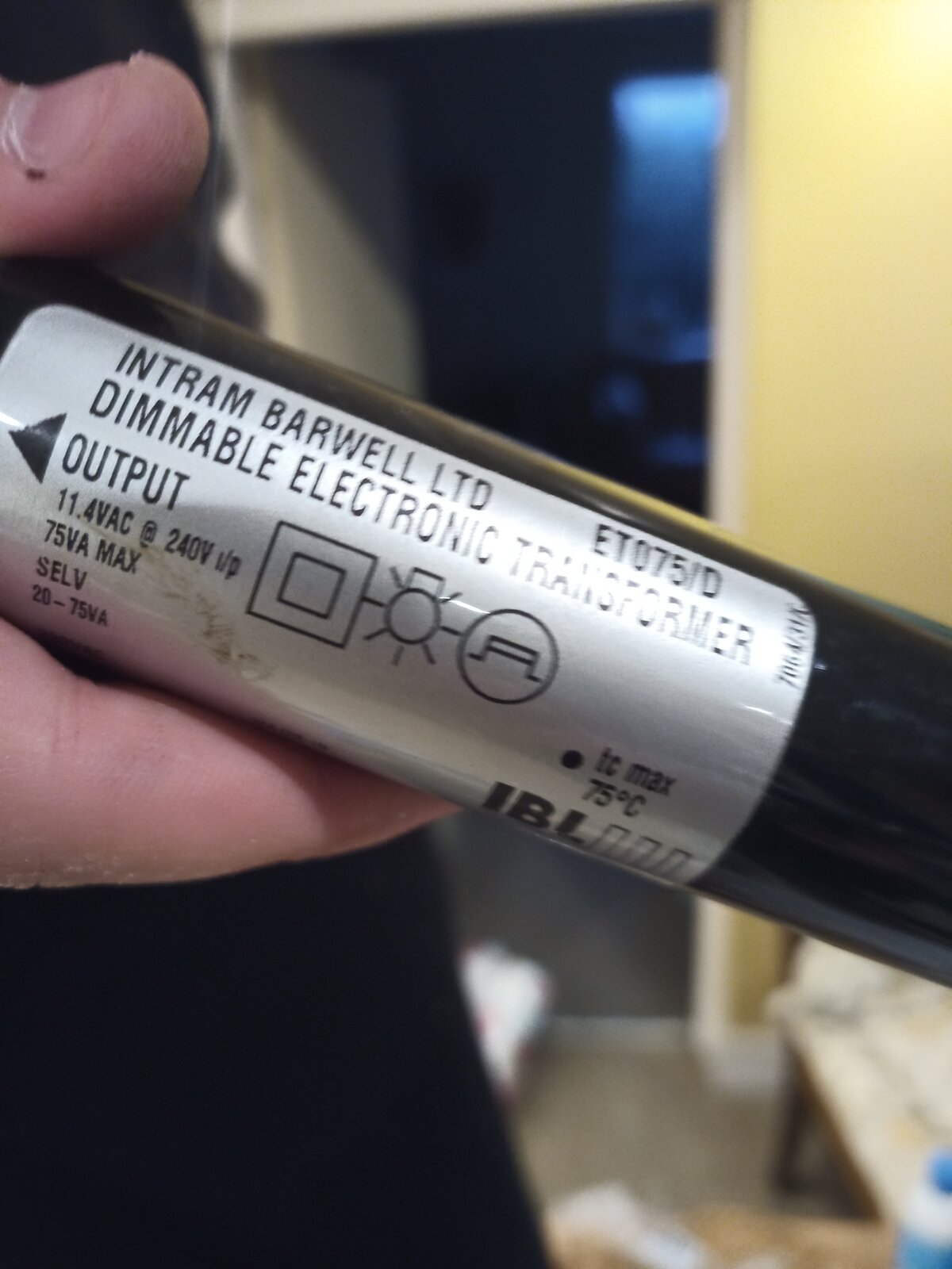

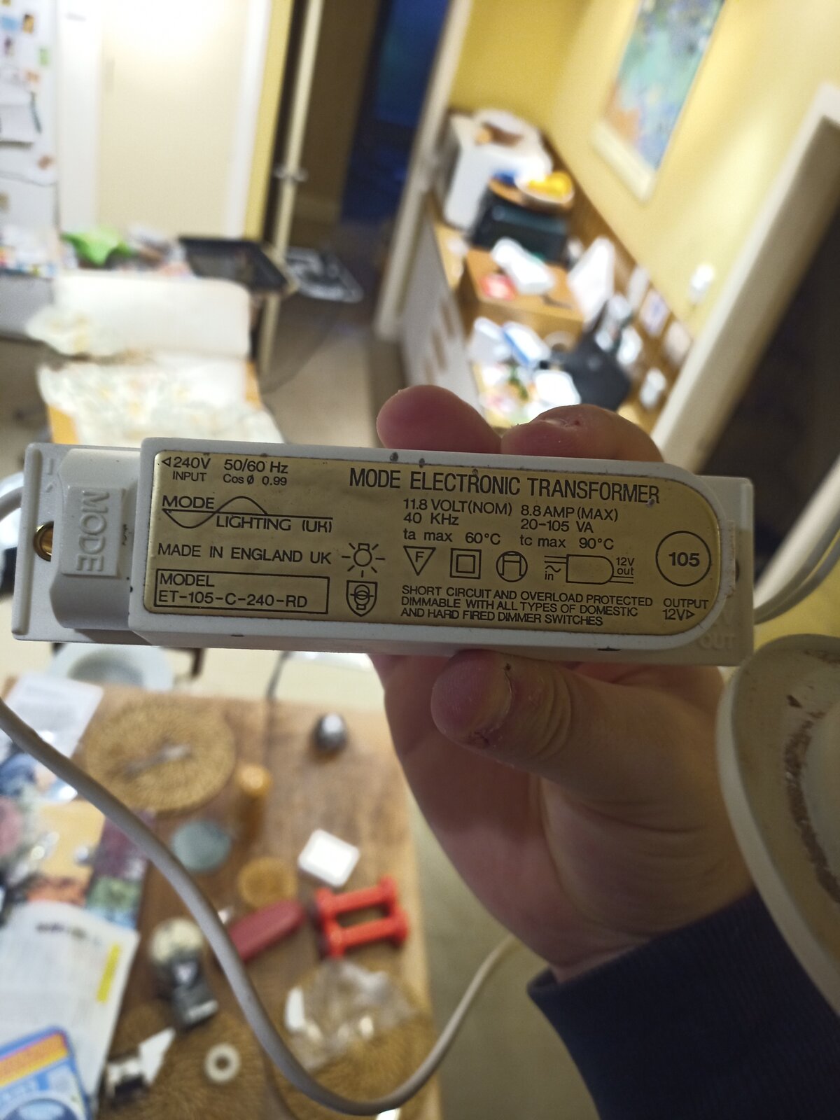

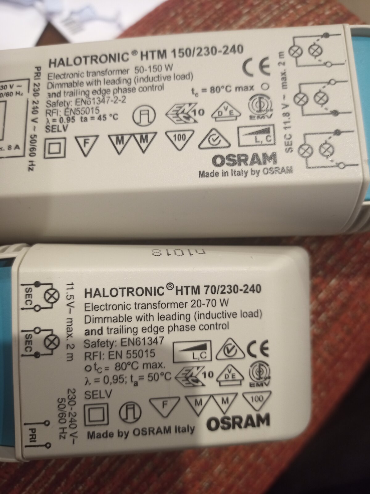

There is one of three types of tranny:
Mode Lighting
IBL (Intram Barwell Limited)
Osram Halotronic
There are some lights in the lounge using "old-fashioned" Thorn steel-cased toroidal trannies, but they're not part of this job.
Mode Lighting
Osram HalotronicView attachment 232135

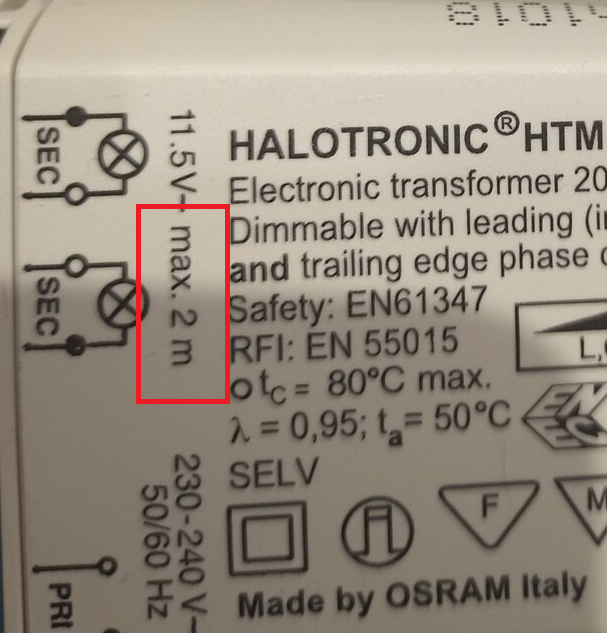

They are all switch mode supplies not suitable for LEDs.
1. LEDs don’t meet the minimum load requirement.
2. LEDs usually state 50/60Hz or DC. Those SMPS operate at 10s of KHz.
You need to get proper LED power supplies or a real (wire wound) transformer.
Even better replace with 240v GU10 LEDs.
