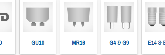

Some of the choices on the Screwfix website:
Even the graphic is not accurate.
Never assume those in charge know what they are doing.
How long before GU5.3 actually becomes MR16 because of democratic inaccuracy.
GU10 becoming MR16 would probably be more likely :-) However, given that GUxx and MRxx have specific, well-defined and totally different meanings, I don't think that 'democracy' will ever alter that - i.e. the attributions which are currently incorrect will probably always be incorrect!
Kind Regards, John
