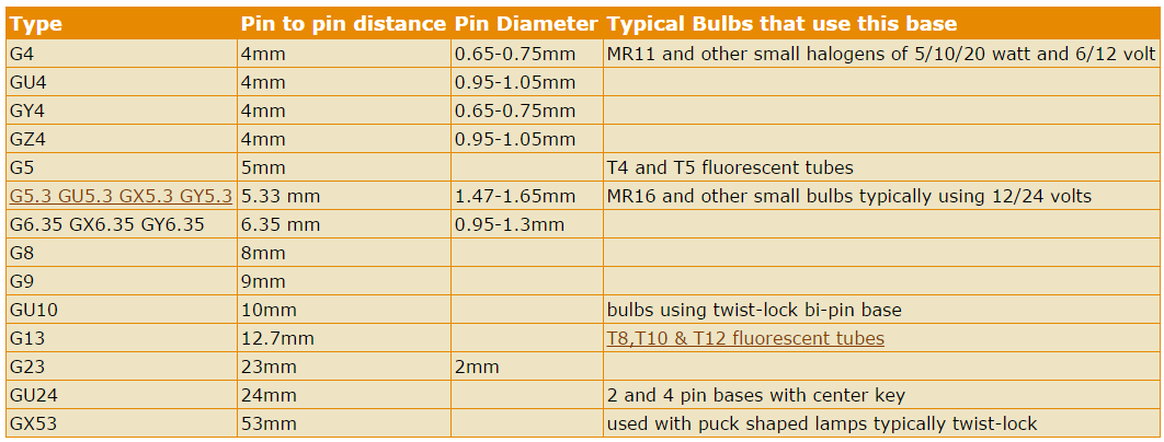

GU5.3 12v or 240v - how to identfy
I cannot find a definitive description of all the types - perhaps no one knows.
Same problem here - I was rather surprised!
No second letter or U, X, Y or Z is the base shape - but doesn't say what shapes.
Maybe - but the meaning of "U" I quoted came from some on-line source (which I can no longer find!). I've found no explanations about Y or Z, but is seems that X may in indicate 'special', whatever that means!

Some clues - but not comprehensive.
http://www.eaglelight.com/category/lighting_tutorials.bulb_base_types/
Yes, I found that one, and others like it, but they all lump together G3.5 and GU3.5 (and also GX5.3 and GY5.3), hence don't really help in trying to work out what (if anything!) is the difference!

I think, as I found and said earlier, the second letter is the shape of the base - although I still cannot find a site which describes that shape.
No second letter, as above G5.3 G4, appear to have no base - logical.
There are some HERE which show some GX and GY and they do have different bases.
There appear to be also some mistakes - as in the first in the list of GU10.
