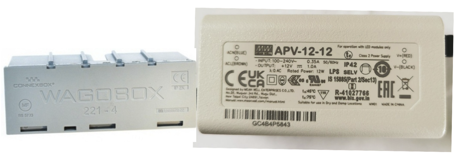

Looks like something thrown together from parts with no consideration as to how the whole assembly is supposed to comply with any known standards.
But as you say the meanwell datasheet states "Cooling by free air convection"
That said I guess that means all LED drivers shouldn't be stuffed in the ceiling void, but I bet most are installed in the ceiling void or some other air tight location.
So basically the proper way would be mount this box/driver outside the bathroom i.e the landing ceiling or top of wall to allow airflow / heat dissipation

If it were me, I'd fix the supply to a ceiling joist and put a junction box hard up against it to enclose the unsheathed mains cables.
It's a 12W power supply. If it's 60% efficient, that means it is dissipating 8W itself. (It should be better than that.)
If it were me, I'd investigate opening it up and replacing the existing unsheathed wires with T&E.

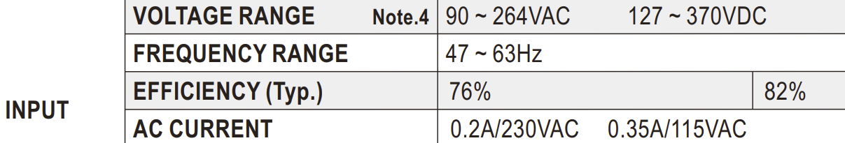

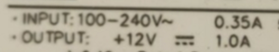

I'd be amazed if a SMPS typically stated as efficiency of 82% could run at 34% efficient or even that any SMPS could be designed and/or built to be only 34% efficient.Assuming that 0.35A is the worst case, i.e. with an input voltage of 100V, doesn't this mean that it consumes 35W for an output of 12W?
Well, yeah, but the maker's spec sheet does say:I'd be amazed if a SMPS typically stated as efficiency of 82% could run at 34% efficient or even that any SMPS could be designed and/or built to be only 34% efficient.
But this is a MeanWell product, not some eebyjeeby parc from Aliexpress.Well, yeah, but the maker's spec sheet does say:
Also, having watched a number of Big Clive's videos I'm no longer amazed at how shoite some products can be.
Yes totally accepted, if taken to the 'no load' situation the efficiency has to be zero by simple definition. I did go through some experimentation a while back when a previous member insisted the efficiency of SMPSs was constant across input voltages. I don't believe I kept a no load record but do recall it was very dependant on supply voltage.It can do if the load is low; the quoted efficiency is at full load.
If you’re running at half load, you’re losing the same amount of power in the gate capacitance of the MOSFET as at full power; other components are similar. The moral is not to use power supplies that are substantially larger than needed.
