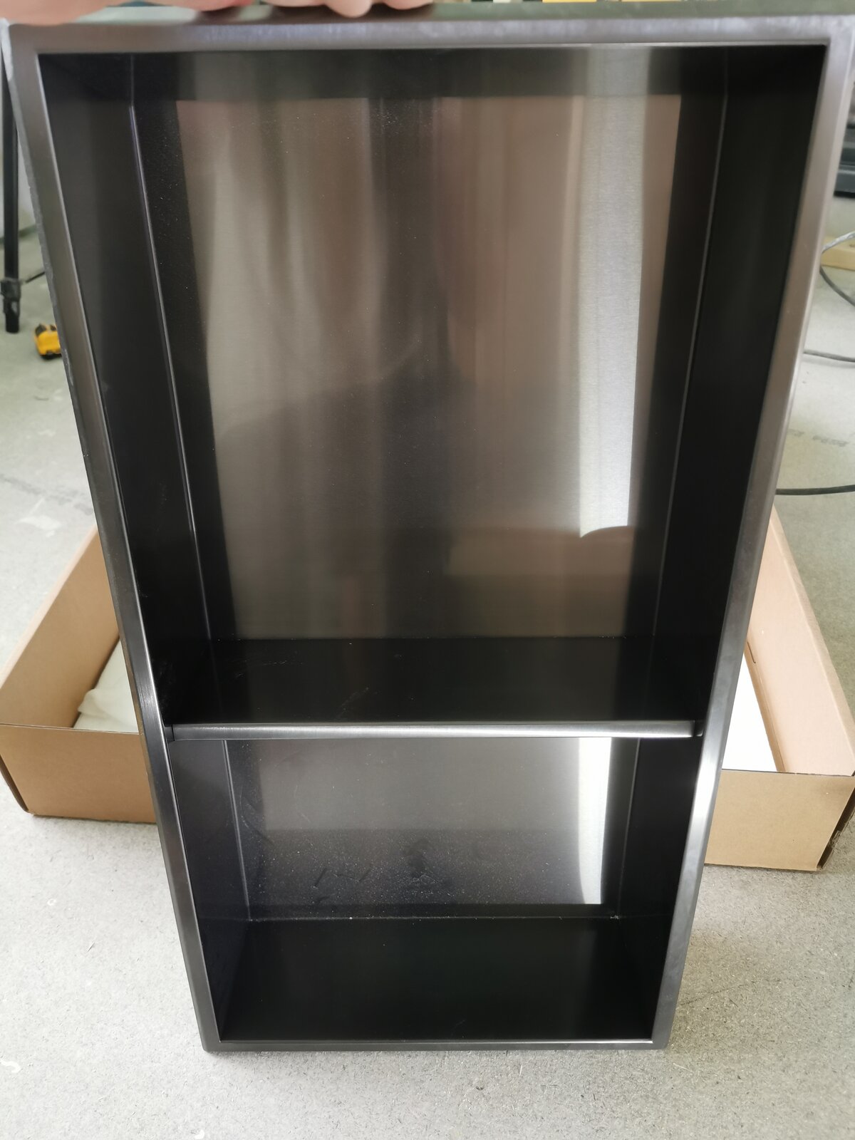

Hi all,
Looking for some guidance with a stainless steel niche I've recently bought.
Have some concerns about this kit, it is branded (Thermopanel) and bought from a reputable company (wetroom store)

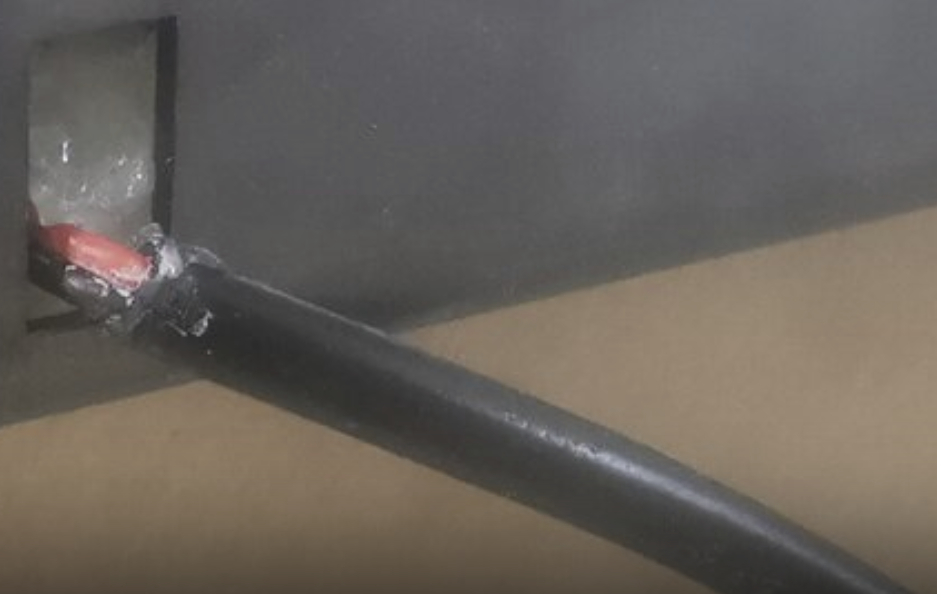

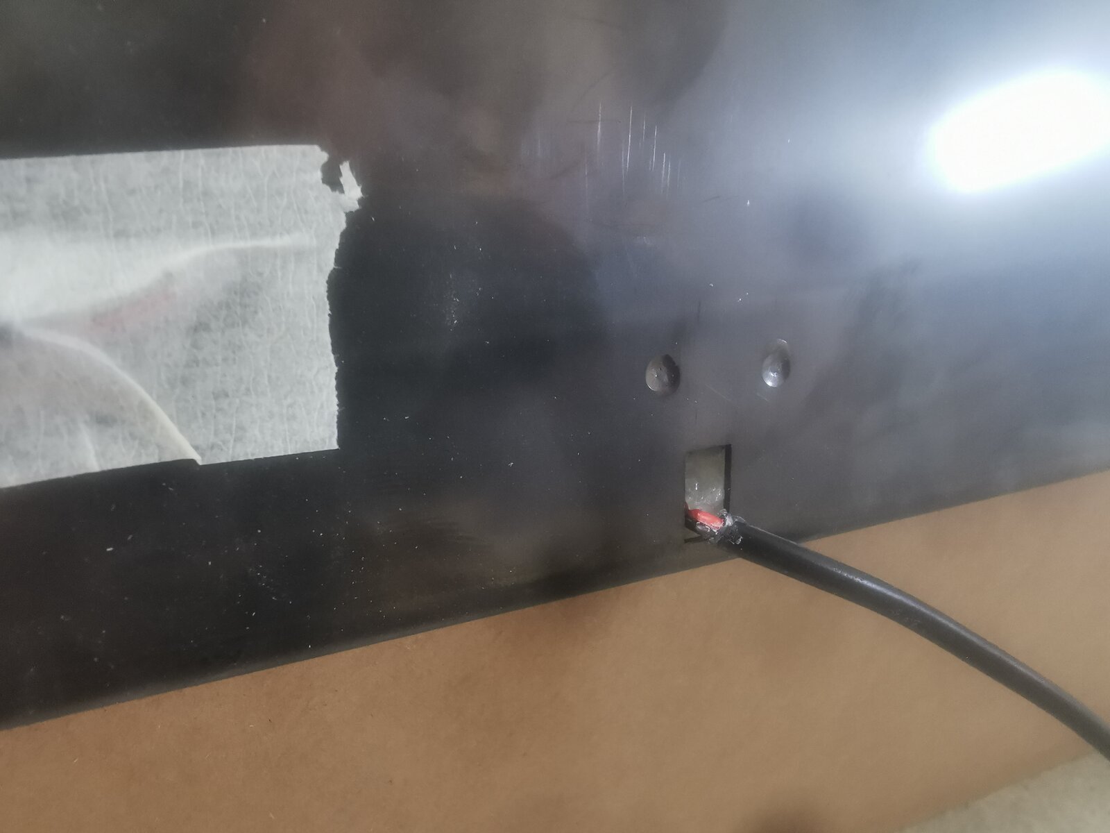

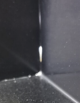

What I noticed is the middle shelf, the shelf drain is near the 12v cable entry, water is going to drain past/near these cables, looks a bit dodgy, or am I over worrying about it?
There is no mention of the IP rating of the LEDs themselves. Niche is going to be installed in Zone 1.
House is getting rewired soon with new CU will be protected with RCD, just getting everything ready for the electrician.
Cheers for any advice

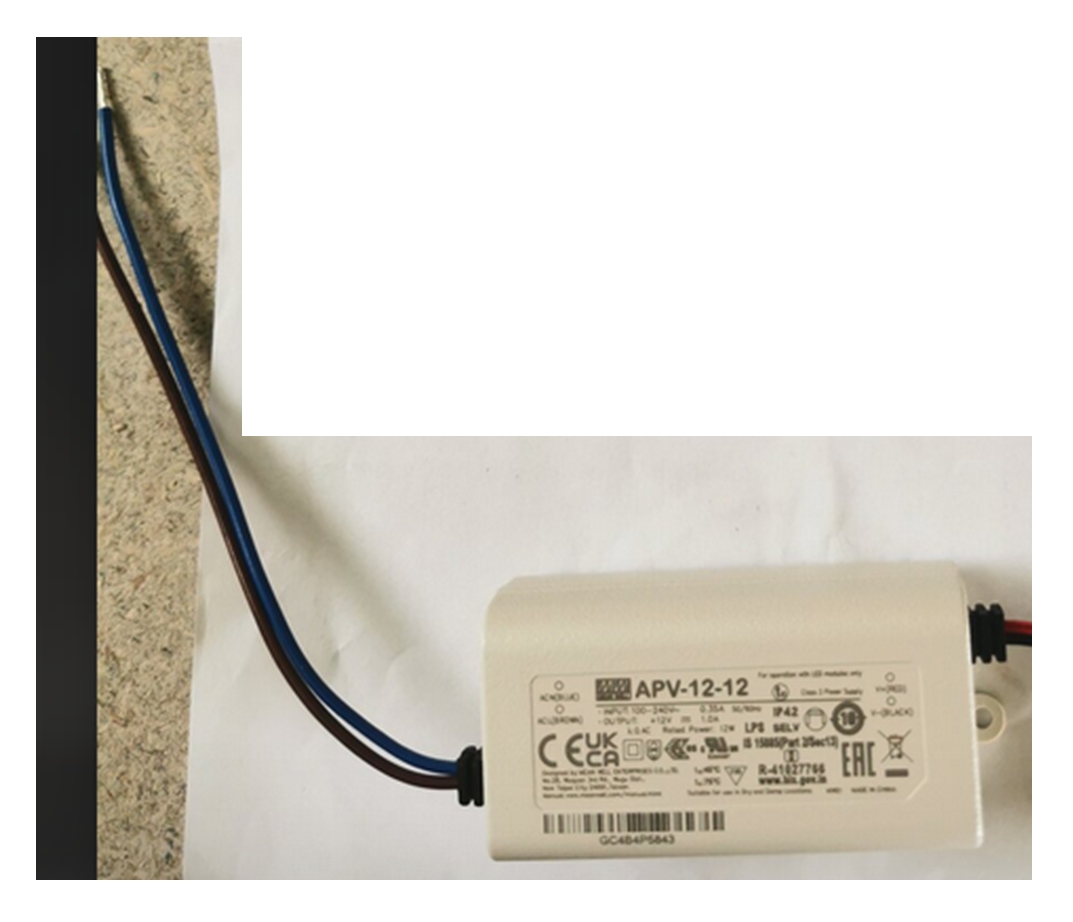

Looks like something thrown together from parts with no consideration as to how the whole assembly is supposed to comply with any known standards.
Where do they intend the LED power supply to be mounted? That along with the wiring should be inside another enclosure.
Thanks for the help,
Yeah I thought it was a bit concerning with the cables rubbing against the metal, wasn't cheap either at £150,
So basically it's not fit for purpose,

So this is one of the 12V cables for the LEDs?
Also I don't think you're allowed unsheathed wires like this for 240V:

Yes that's one of the 12v cables to LED.
Good point on the unsheathed 240v cables, its all crap / dangerous.
Shame as the niche itself is good quality.

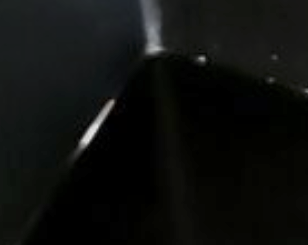

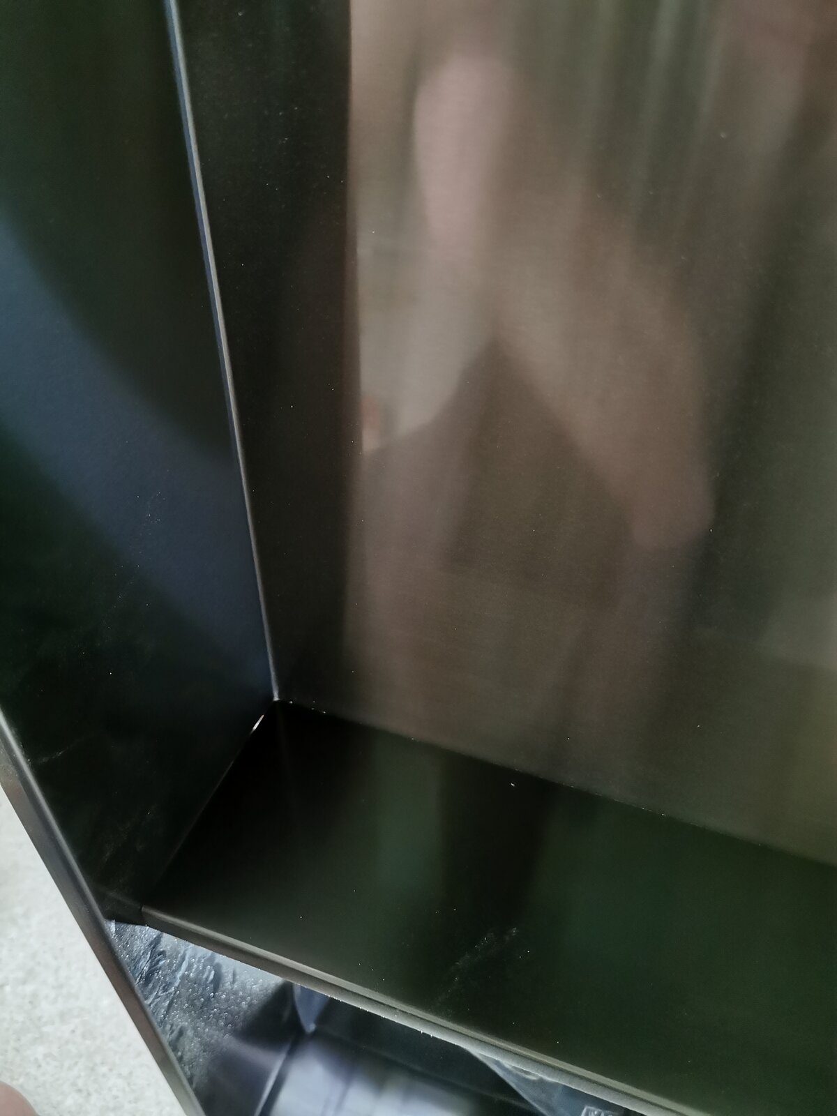

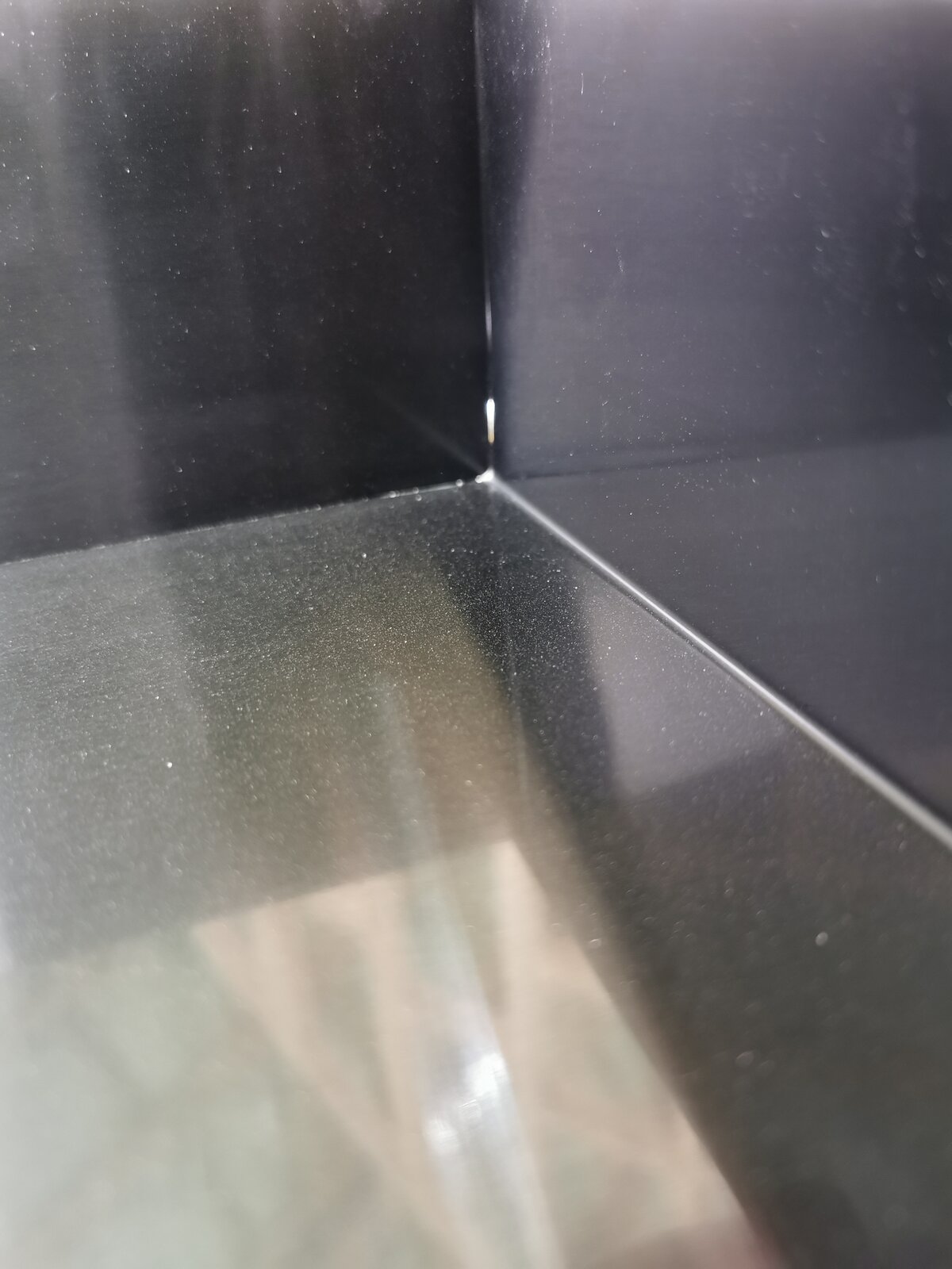

The bottom pic... Yes that's light shining through to show the gaps on the middle shelf
I guess either they purposely left gaps for drainage or it's poor welding.

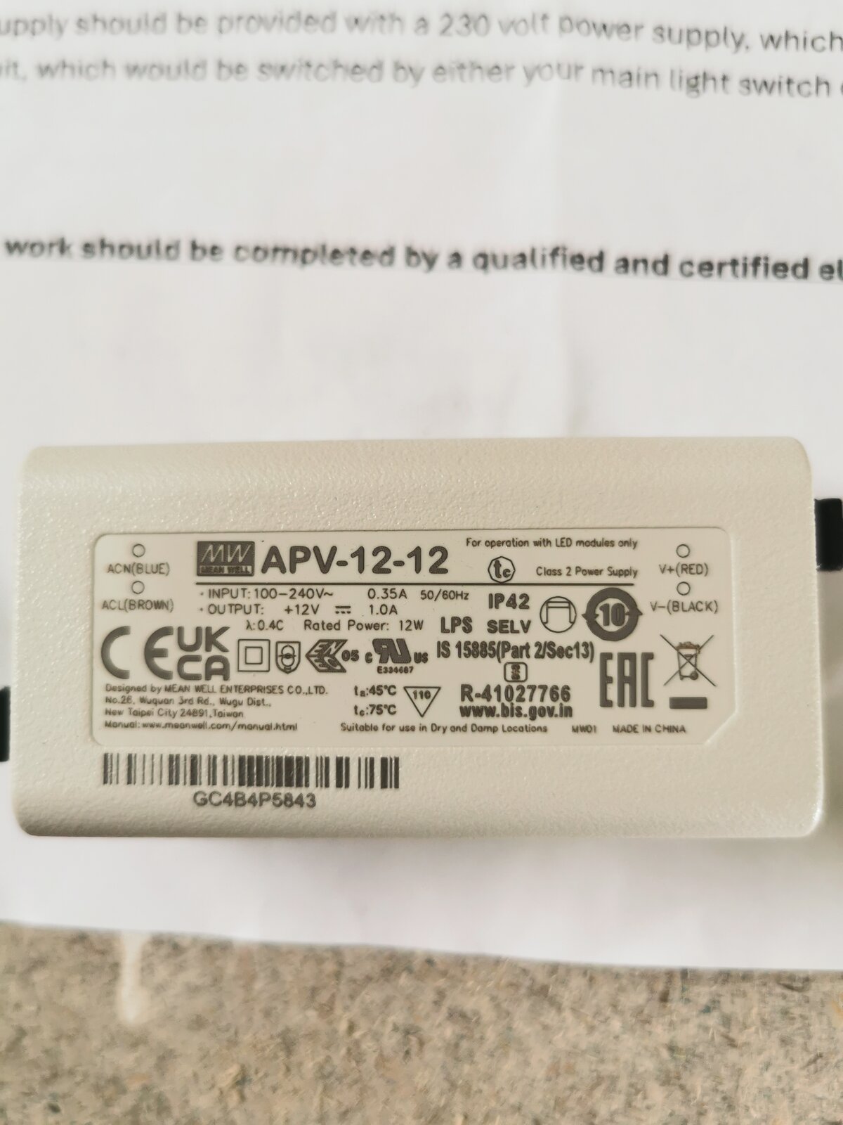

The wiring of that very good quality MeanWell power supply is acceptable, and Flameport has already pointed out it will be/should be mounted in an enclosure, either something provided specifically for it or built into a fitting.
He also pointed out
As for it being in an enclosure, etc:
Do we know what Thermopanel "intend"? morg - what do the installation instructions say?
We should note that the manufacturer of the power supply say it needs cooling by free air convection. It also says
I wonder what the end user is expected to do to get a compliant installation.

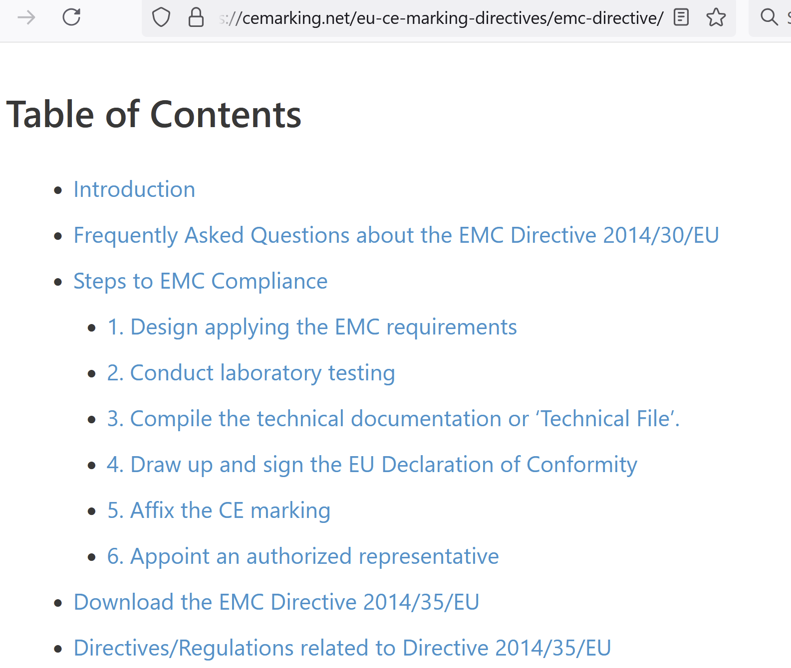

Who would generate the paperwork making it compliant at completion.
So can all "qualified and certified electricians" carry out EMC testing and certify compliance with the appropriate directive(s), or only some?
Can any of the "qualified and certified electricians" who are members here confirm that they could do it if required?
