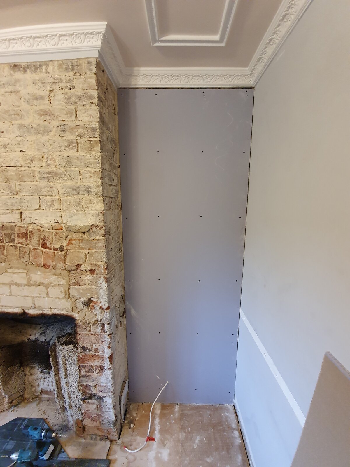

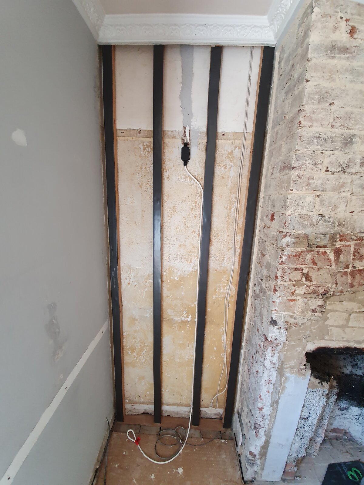

As description; I had two awful sconce lights either side of my chimney breast. I needed to re-plasterboard the wall so i took the opportunity to remove them.

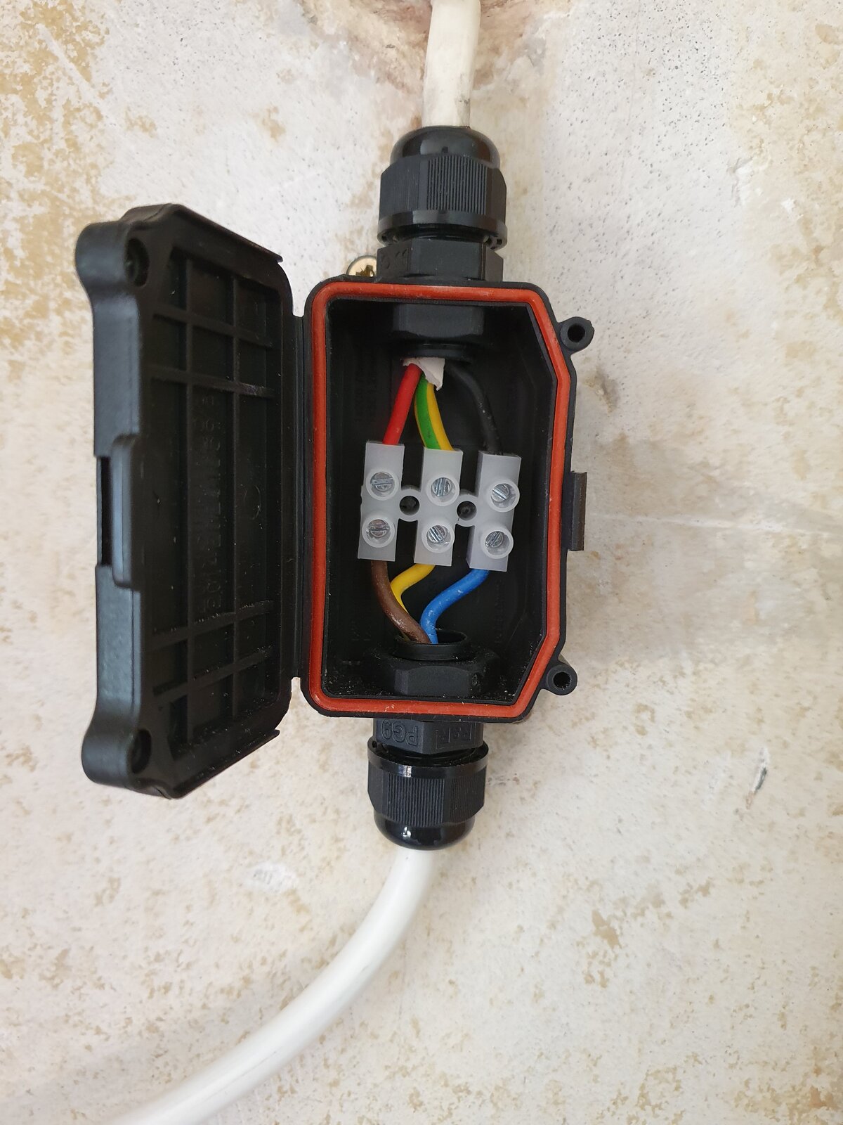

In their place I screwed a junction box between the stud and extended the LNE wiring in 1.5mm 3 core down to a hole in the plaster at the bottom at floor level.
I'm now getting built in storage to the bottom (which houses my newly extended live feed as described above) and shelving.
The plan is to power LED strips to backlight my splendid new shelves.
My question - is it as simple as fitting a transformer to the extended feed thus running my 3x LED strips?
Further, will the switch on the opposite wall that switched the sconces now activate my new LEDS? (Pretty sure I know the answer to this already...)
What are the potential risks? I'm a competent DIY'r but as a new homeowner I'm a careful novice with Electrics. I'm past the sticking-my-finger-in-light-fittings stage...but not much.

If the third picture is the junction box behind the plaster board your first job is to remove your new plaster board and replace the junction box with a maintenance free one. Sorry, but that is the rules.
Better still would be get rid of the junction box altogether and put a new length of cable in using 1.0mm twin and earth.

Thanks for your insight - you learn something new every day, I had no idea about maintenance free JB's!
In that case, this isn't the end of the world as I do also have two gang sockets either side of the breast within my cupboards so I can run my prospective LEDs off these.
Now that i'm going to get my electrician to safely isolate this circuit i'm still left wondering what could have been, so I fall back on my original question; IF I had continued, could I have wired my LED transformers to the 3core switched feed that used to power my sconces?
Yes no reason not to wire them to a switched feed.

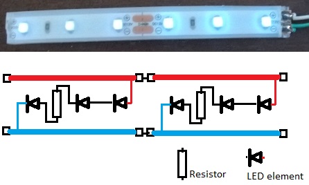

If you are intending to use LED strips like these you need a 12 volt DC power supply. The resistors in the strip determine how much current that flows through the LED elements.
An LED driver determines how much current flows through the LED element(s) it is driving.
An LED driver will be rated as having a current output and not a voltage output. 300mA is a common rating.
The words "LED driver" and "power supply" are frequently mis-used.
