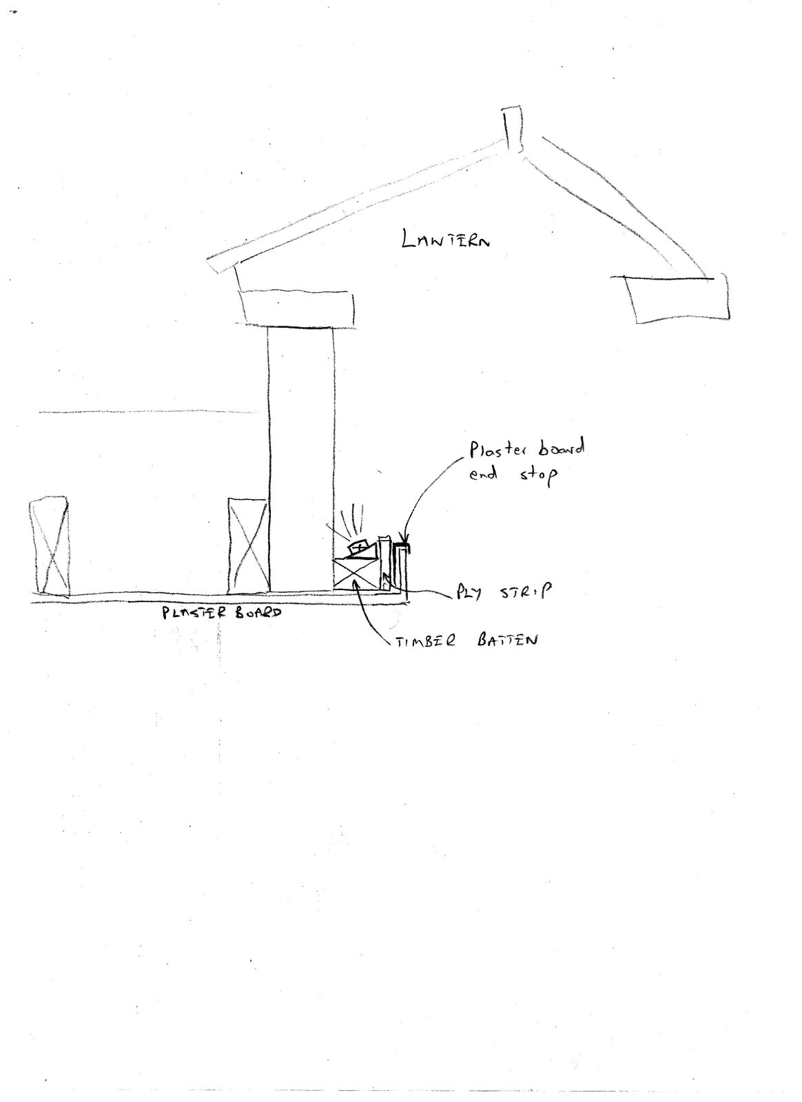

Thanks @Notch7. I am not entirely sure what you mean about forming a rebate. Is there any chance you could sketch this out with some sizes of the batten and wood strip so that I can show this to my builder?

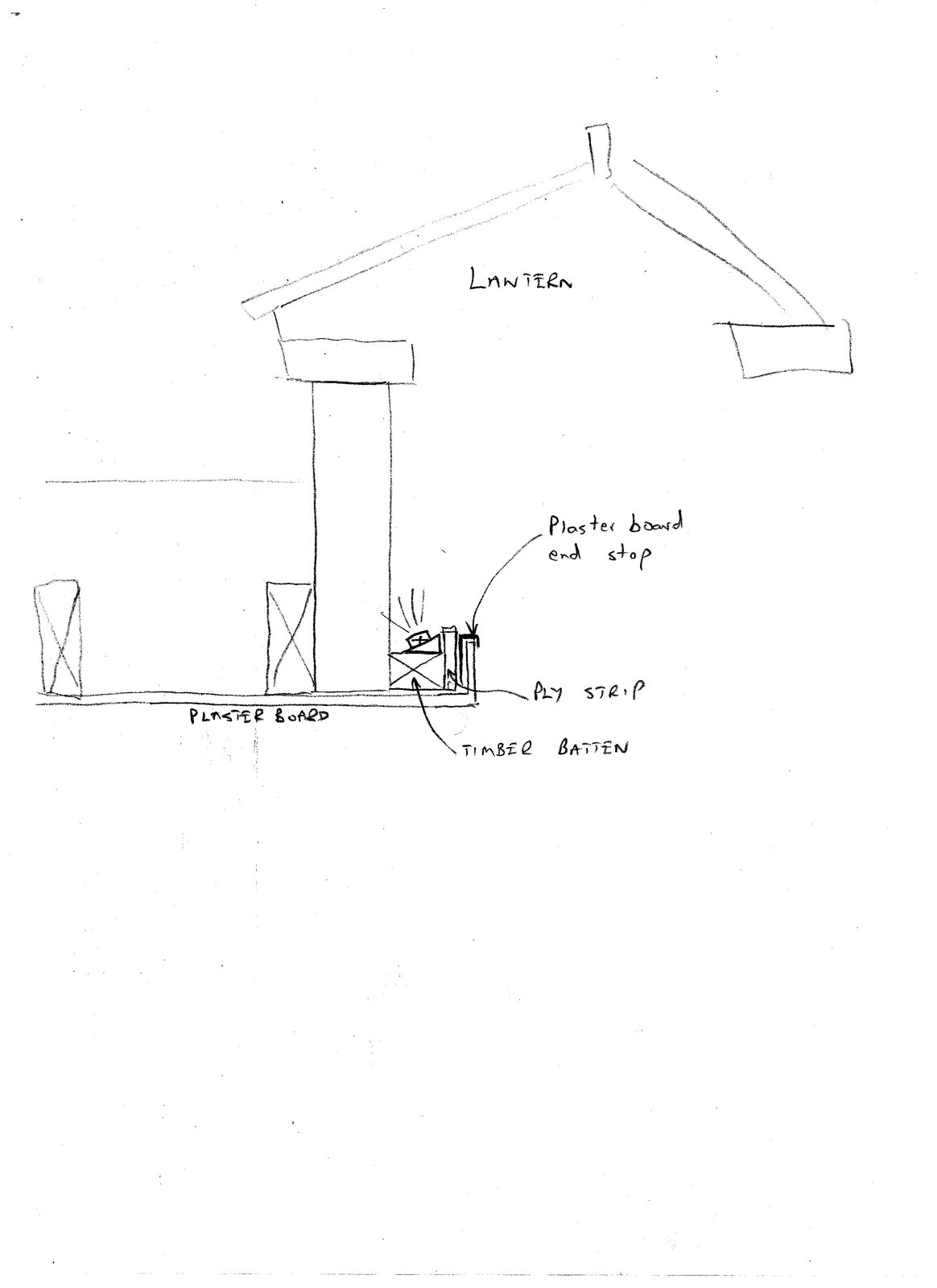

I cant remember the size of batten I used -maybe 38 x 25 or something
to get the plaster return the height needs to be enough to fit a plaster stop bead on and the corner bead
it does work well because you cant see the tray looking up as the ceiling is continuous and it adds a wash of light onto the lantern reveals rather than the lantern
Many thanks @Notch7.

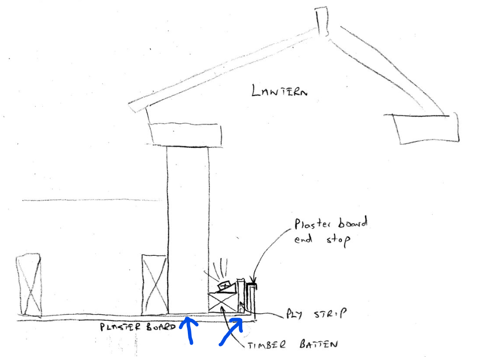

Is the plasterboard (shown by the 2 blue arrows) a continuation of the same plasterboard from the ceiling? If so, this may be a problem as the plasterboard that is going to be fitted is a 50mm insulated plasterboard.
Is this the Stop Bead you are referring to? https://www.wickes.co.uk/Wickes-Thin-Coat-Stop-Bead---3mm-x-3m/p/224660
yesw its a continuation.
ah okay, I hadnt realised its a cold roof -I hope the roof construction allows full airflow -its a bit tricky with a lantern generally
it might not be possible with insulated plasterboard -is the lantern reveal going to have insulated board too?
you would need to talk to your builder about what is possible -I dont know your roof construction so cant advice on this
the ply gets pinned to the batten to form the light recess, then the stop bead gets pinned to the plywood.
yes the LED aly profile holder would work well
