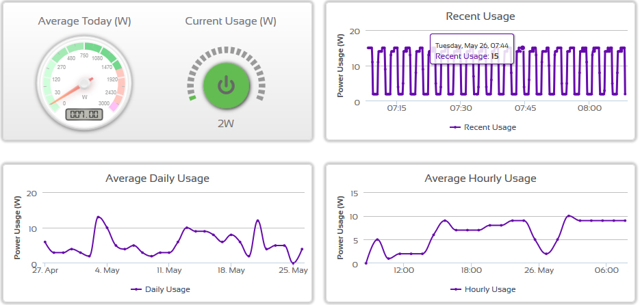

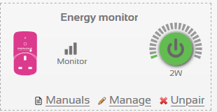

I did design some thing similar to switch to a spare extractor fan and turn off the plant should both fail, as long as the motor has an overload that will open if the motor stalls, then the current monitoring only needs to be on/off, however today I use battery chargers, air conditioning units, and all sorts of other equipment where I want to monitor what is going on. I use one of these
may be not the best one for you, but for me it means a very easy method of seeing what is going on from my bedroom so at the moment I am charging a battery together with other devices when starting firefox I see
and clicking on monitor with other bits I get this
As a result I can work out what has happened, there are IFTTT options to set alerts so I could set an alarm, the patterns shown don't matter, but clearly you would know the normal power used and would see by using a web browser if it is using normal amount of power, at the moment I have a sulphated battery being charged, when the charge rate drops to zero I will know it has recovered.
In your case if the pump gets dirty likely the power used will climb showing it needs cleaning, it would show very high if stalled, and too low if a shaft breaks etc, and very quickly you would get to know the normal use.

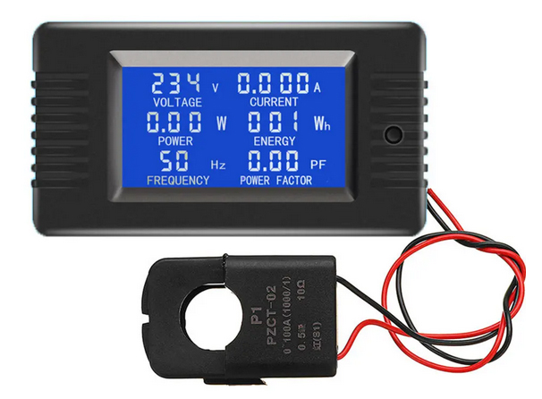

I also have an old meter given free by Scottish power some years ago which measures power used but does not record, I noted this
at £12.47 again may be not idea as need mounting in something, but it would show power being used, and so show both over and under current. I would not think your system would not have an overload which would trip on stalling, many overloads have aux contacts to allow fitting a light or buzzer once triggered, in other words there are many ways to monitor, but since it would be good to see some thing before it fails, the ammeter is likely the best option.
