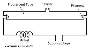

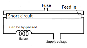

The LED tube I got sends out light in one direction only, 90º to direction of the two pins, I remember my father-in-laws old house with recessed fluorescent fittings and I am assuming you have the same problem as he would have had in that the tube faces in the wrong direction.
The fluorescent is wired like this
when you fit a LED it is like this
the ballast just warms up and does nothing, so better simply shorted out, many show feed to one end only

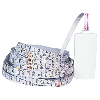

but this means if tube fitted wrong way around it is a short circuit. I would think a strip light would work better, these 1711278210965.png can be placed so light is in correct direction I assume 1711278340865.png your looking for something like this? However my problem was the driver or power supply is often built into a plug.
I had a problem lighting my living room, and I have a collection of lights from ceiling to display cabinet, to up-lighters and reading lamps, and using a number of lights together there is enough light, but clearly when entering or leaving the room one wants to turn multi lamps on/off, I got around the problem by using smart controls, but it was not cheap.
I have two of these 1711279028461.png at 17 watt, £25, 1500 lumen each colour changing but the 5 foot fluorescent is around 5500 lumen so to get that amount of light takes some doing. My son replaced one 5 foot fluorescent with 14 down lights, I would think around 3.5 watt each, so 49 watt instead of 58 watt, not much of a saving.

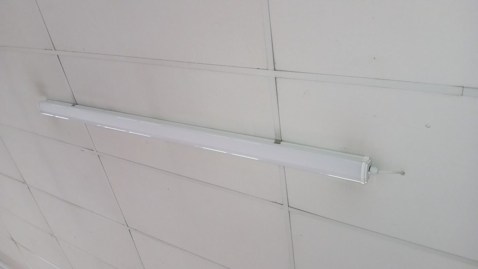

I got a couple of these Lidi-Smart-strip lamp.jpg from Lidi and they seem very good, but never seen them for sale again.
