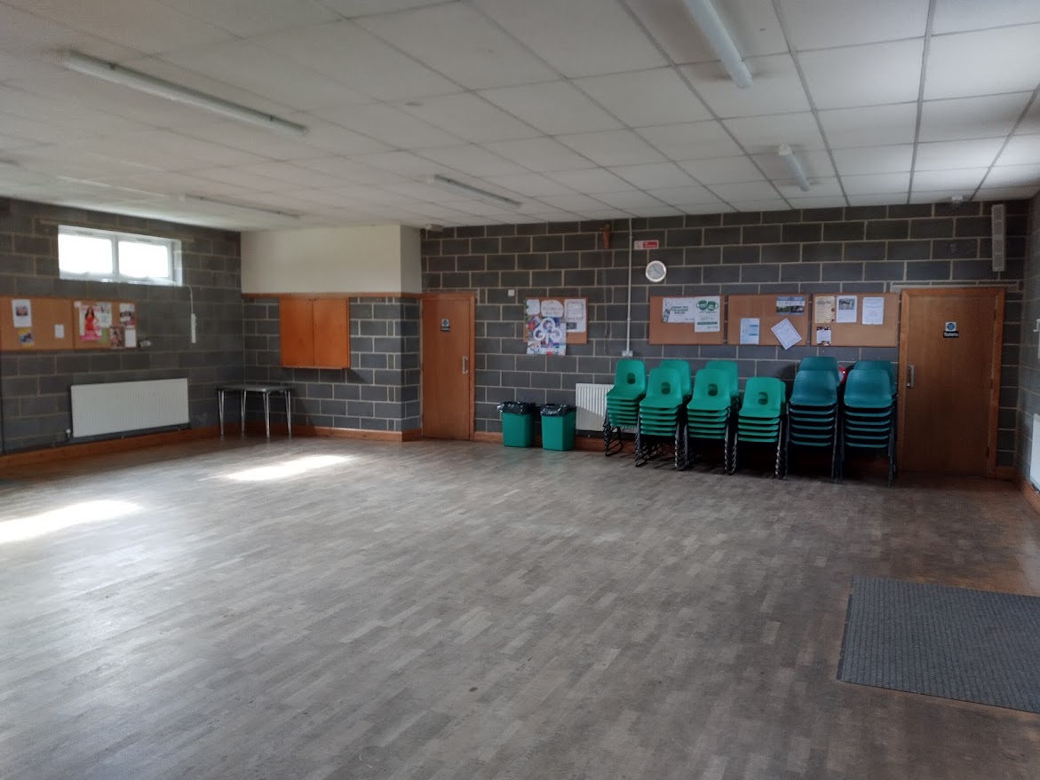

Yesterday I went with a colleague to a church hall, as it happens one I am familiar with which I suspect is why I was asked to go along. For 2 years people have been complaining about the lighting and just recently they lost the final day time booking because of it. Regular bookings have dropped from 22 to 10 per week and the suggestion is due to lights. The hall is 12x10m and lit by 9 6ft LED self contained battens, as recommended by some sort of churchs energy inspection to replace the 9 6ft flou fittings.View attachment 339237
The complaints started as soon as the change was made. Even one of the church craft groups who used to get the space FOC now pay to use a different hall as they say they can't see to thread the needles. This pic was taken a year ago on a bright May day and as can be seen there are high level windows both sides (I think 3 one side 2 t'other) yesterday was a dull day and switching the lights on didn't make a dramatic difference but suspending a 4ft fluo batten half way between 2 of those did. We had the local church administrator and someone from the energy incection team there and both made an unenthusiastic sound when it was switched on.

I can't help thinking the hall could do with painting White rather than be left as Grey block work as light would reflect off the walls.
Maybe as suggested by Frodo installing panels would give a more even spread of light but it is a different quality of light compared to old style Fluorescent.
Yes you are probably right but with the fluo's there was never an issue and a simple demonstration of suspending a 4ft flou between 2 of the LED battens absolutely blew away shadow created by the LEDs.

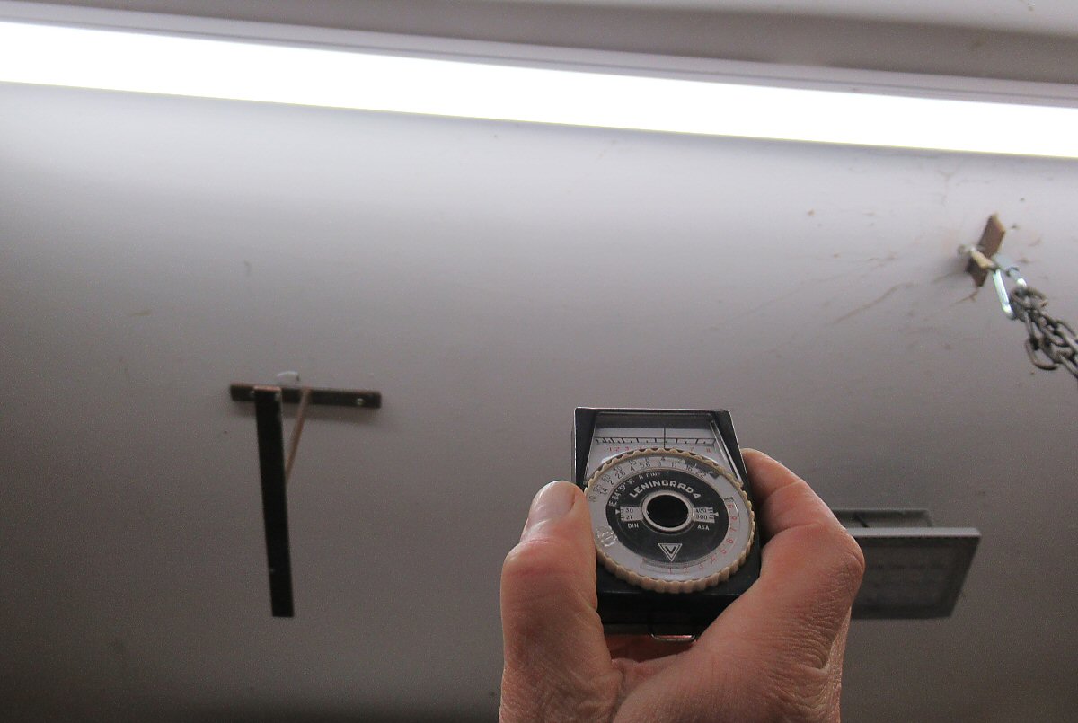

how could i put a figure on it - what might I have that measures light ?
found an old light meter, did some tests, from about two foot away, the old fluorescents gave a reading of 6 (all 3 gave the same reading) the all new LED with its claimed 'same brightness', gave a reading of 5.6
GPT tell me these are very linear scales so it is reasonable to assume that the fluorescents are 7% brighter.
change of subject - the light meter that I didn't know i still had, doubt I have seen it this century. A "Leningrad 4" a real relic from the cold war. they made things well back then, still working after 50 + years
