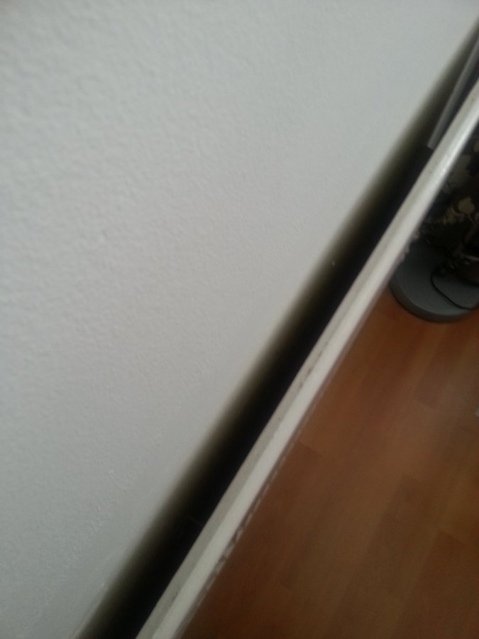

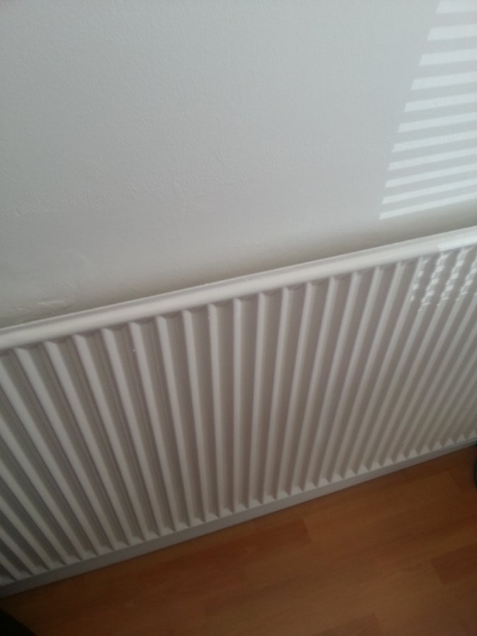

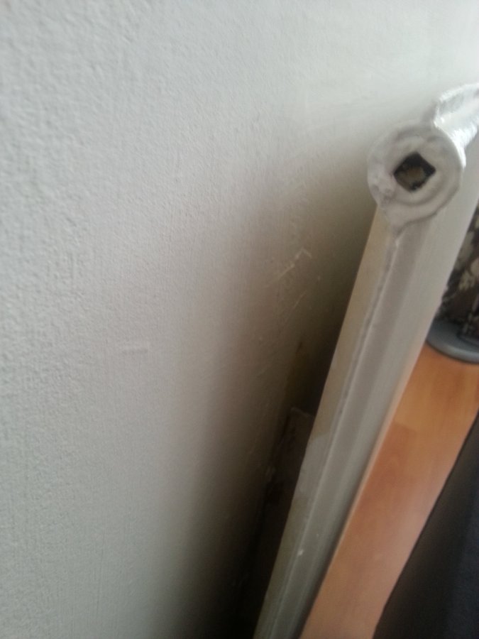

I just thought that for the benefit of this thread (as it has now been replied to many times), i would upload a few photos of what the current radiators look like. :)
I hope that next year, adding new radiators (plus TRVs to secure the building reg cert) to complement my new boiler will be worthwhile overall.

Look like the old Potterton rads or Penrads I think.
Look at it differently, did you move in before last winter? If so were you cold? If not the rads are big enough. Efficiency doesn't come into the equation if they're big enough. Cleaned, for the boilers sake of course, they will only give out more heat than you get at the moment which is sufficient.
Don't change them unless the appearance offends your eye. If they're not large enough no problem. TRV's are generally a waste of time for efficiency, use them for comfort.
