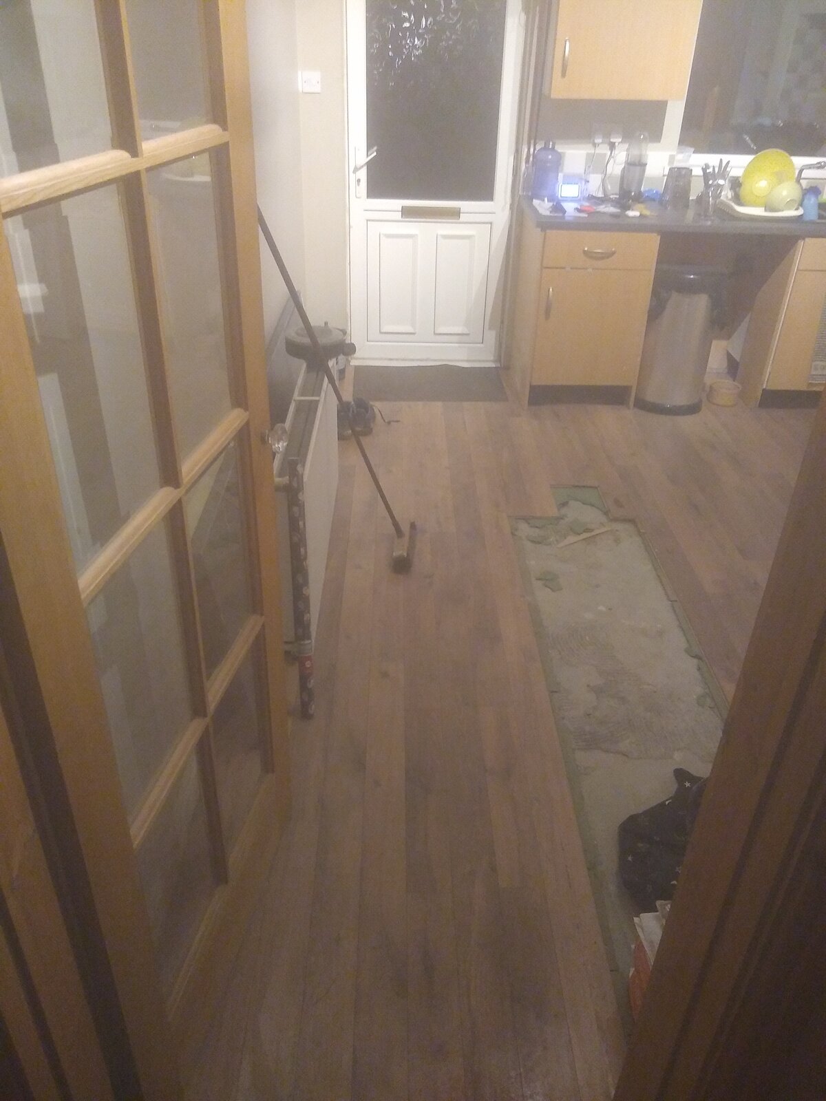

This is the floor I'll be levelling.
It slopes towards the door and is 8cm slope in total from entrance to kitchen to the white door in pic

Will the door open after you've added 80mm to the floor.
Has the cause of the sloping floor been identified and ongoing movement stopped.
You need modified screed to level that floor, not messing about with this and that, hoping that something might do
Hi, no the door won't open, as a temporary measure i'm going to cut the bottom of the door, until i get a new door. That's another issue, i will need to raise the door, probably putting a course of bricks in under the frame.
What do you mean by modified screed? Modified in what way? i just think normal screed will do? 4:1 mix of sharp sand:cement....
I will put battons into the walls on edges and use these to run a straight edge over therefore giving a near enough level finish. To finish it off, i'll put some SLC over it in a few weeks time.
