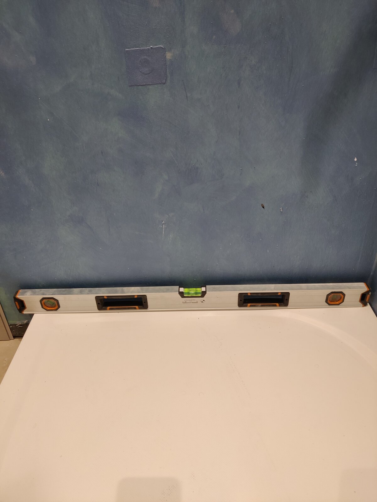

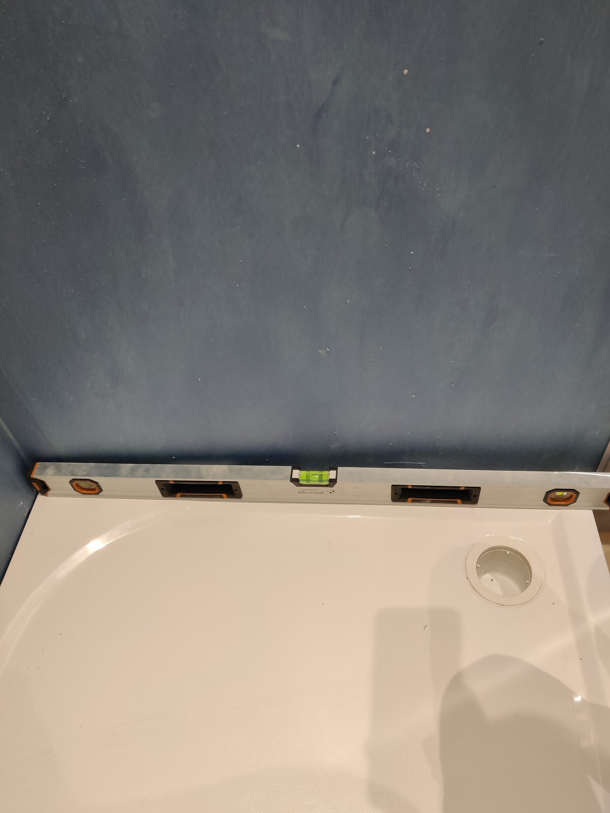

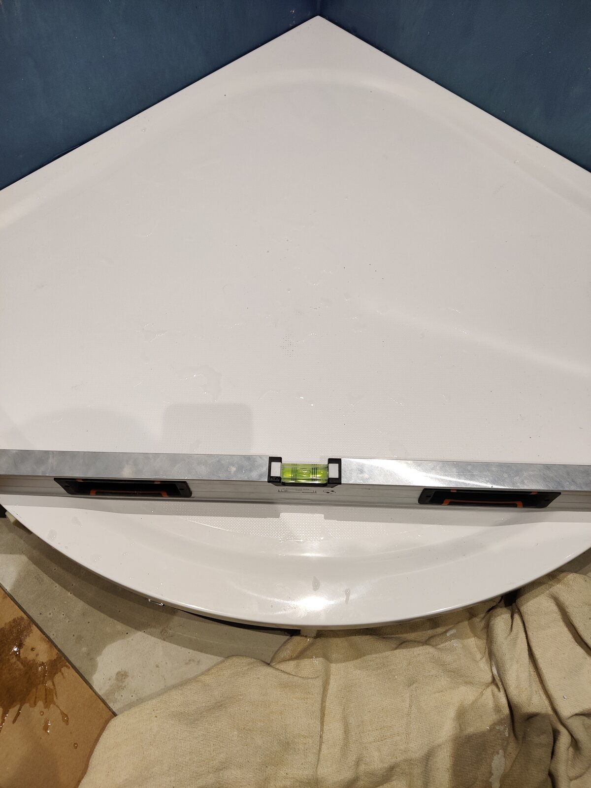

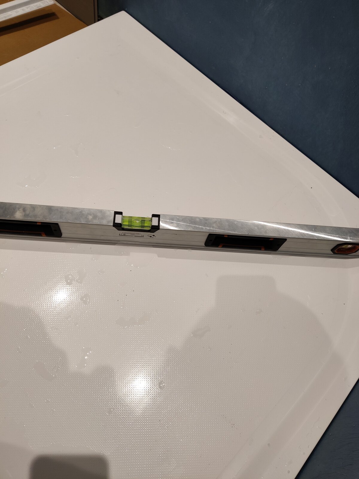

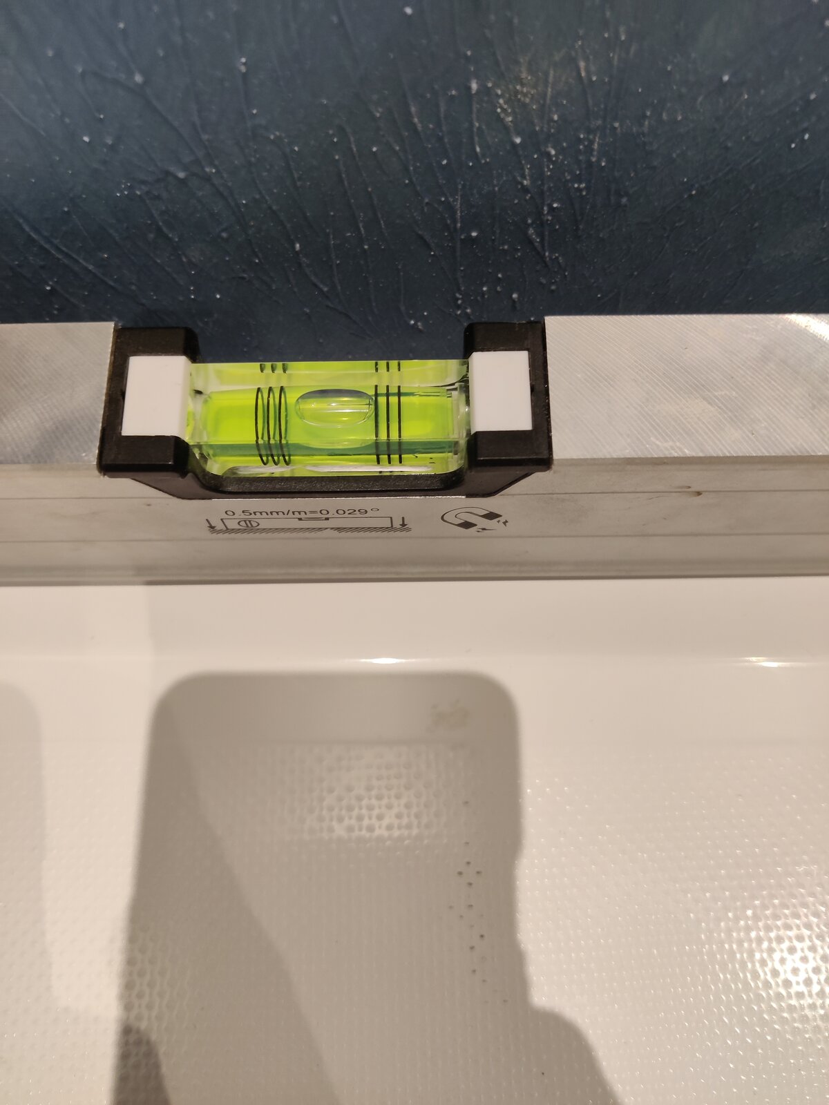

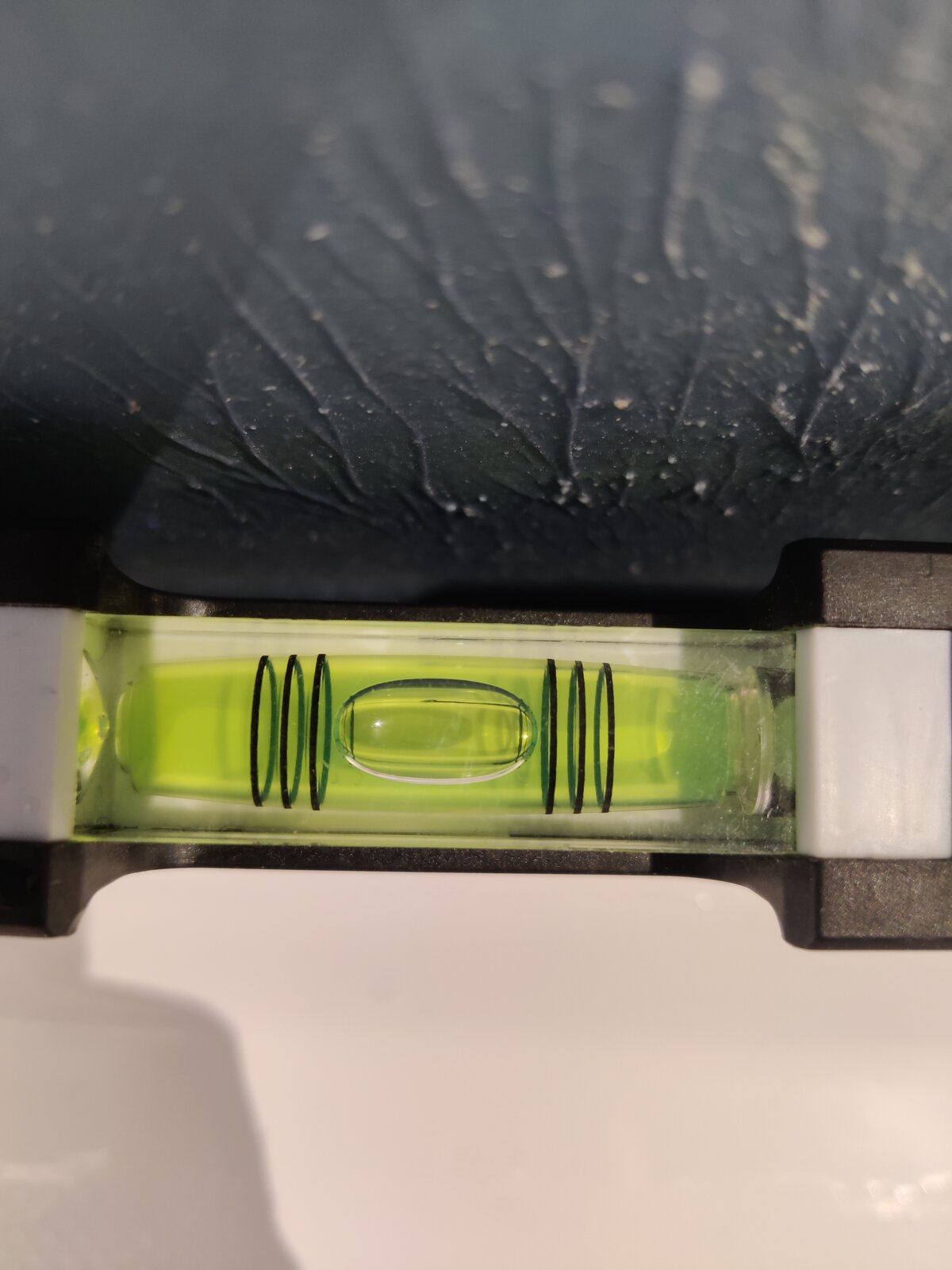

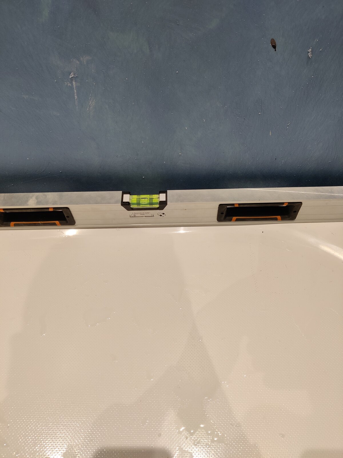

Hi all I'm new to this forum I'm trying level my shower tray which is on a riser kit this is as close as I can get it question is is this acceptable ps I have not stuck it to the walls yet

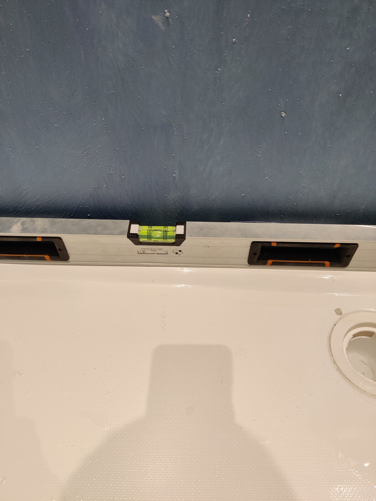

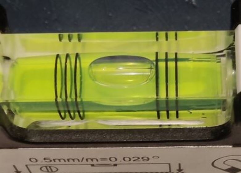

This is a close up of last image it's the run from back wall to waste

Yes, nothing wrong with that, close enough as long as there is a suitable fall inbuilt into the tray, test it with some water slow poured from a bucket.
The only thing I would say is that I would recommend you don't use a riser kit. They aren't very good long term and have a tendency to move/shift.
Thanks for your quick reply yeah I was worried about using the kit but as a diyer I wasn't confident enough to start digging up the concrete floor and going down this road I no I could easily inspects the waste
No need to dig up the concrete, easy to fit a wooden plinth down onto concrete with a hammer drill, plugs and screws to secure the batons down.
Ultimately it's your call of course and what your happiest with.

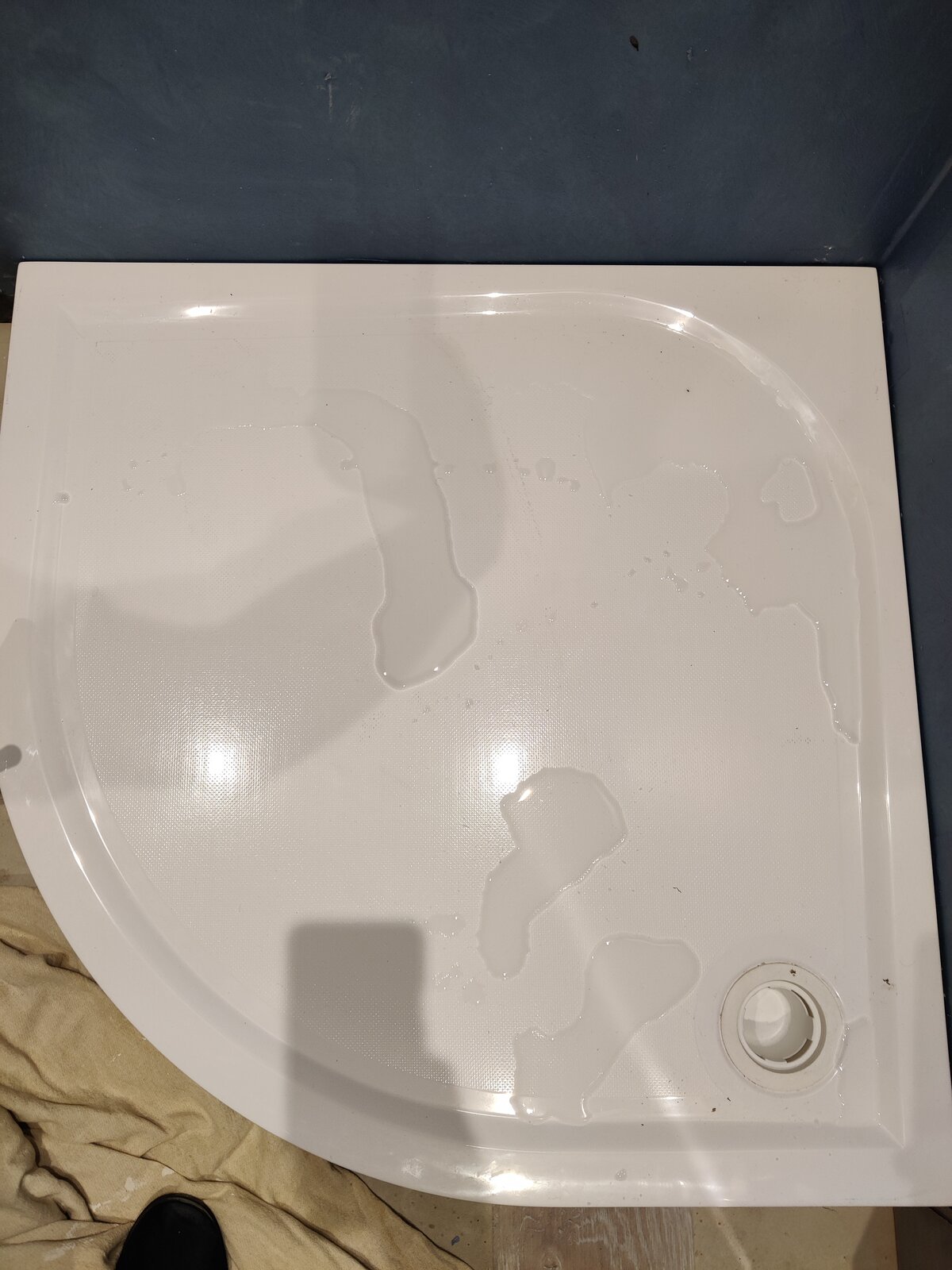

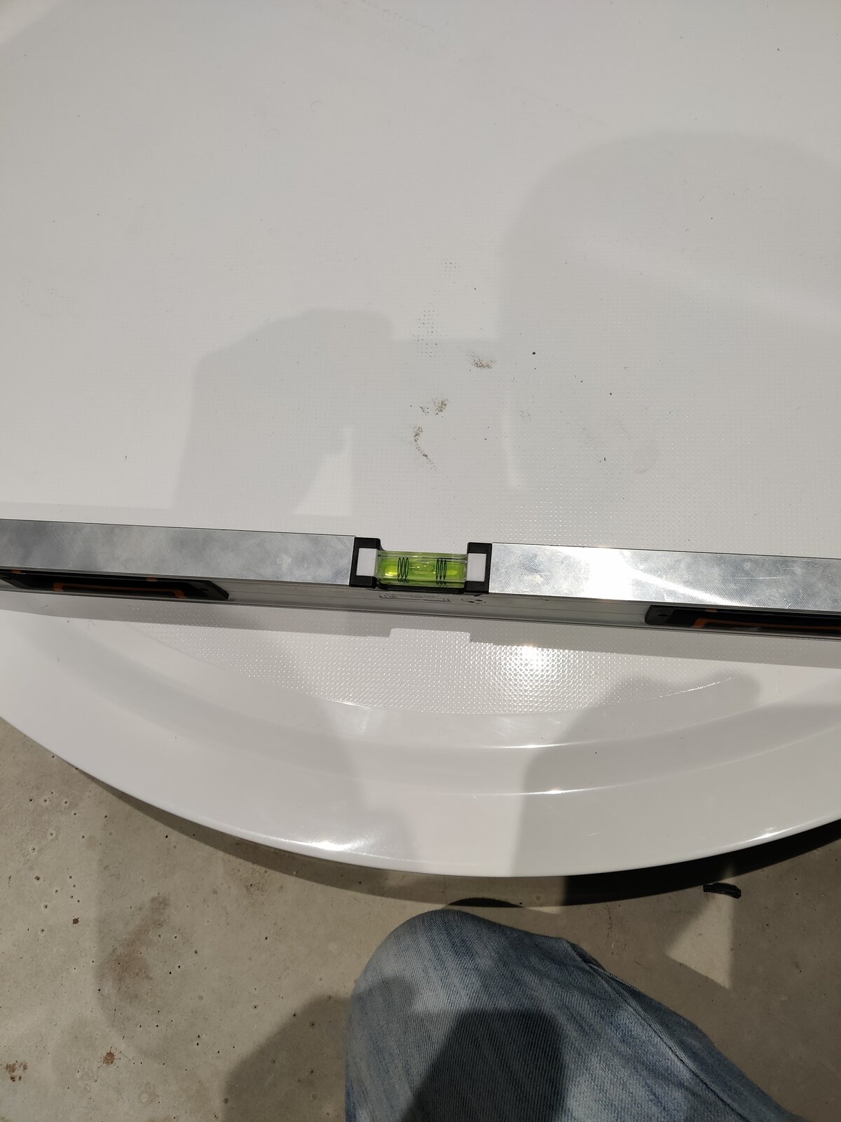

Thanks as I have everything in place I'll stick with the legs .So done a water test n it's seam to be taking it's time finding the waste

wouldnt be good enough for me.
Nothing worse than having to pack up the first row of tiles because the tray isn’t 100%. presuming it’s being tiled and the first row is down to the tray.
Doing my head in lol Im planning on fitting a cladseal strip and the continue with the wall panels would it do any harm on putting a very slight slope so it's runs better to the waste

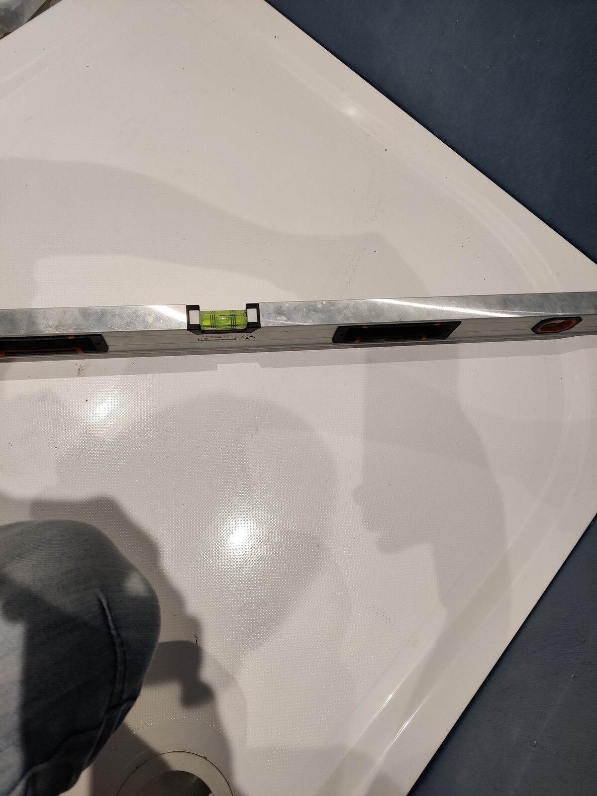

Cheers for the criticism Jim i have now got it to this ( see pic ) water going a bit quicker now but I'm still scared of it pooling once it's installed
That's as good as you're going to get (remember to offer the level up the other way to make sure it's reading true) :)
