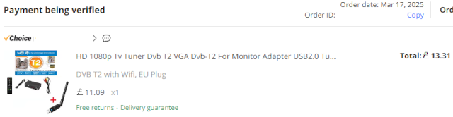

The TV works fine with signal coming through scart and RGB sockets. So, the solution is a china set top box, with WIFI!!!!
So not just something that switches on and watch. Switch Tv on with TV remote. Switch China set box on with China set top box remote, choose channel with China set top box remote. Adjust volume with TV remote. Change channel with China set to box remote. Yeah, hassle free. :rolleyes:
How would you know how the china box works? I will get it and see. Possibly you are not used to advanced TVs. For this unit, after power on, it goes straight to the last selected input. Everything will be controlled by a power remote. In the worst case, power remote on, then china remote choose channel. When done, power remote off, go nap.

It does now, with the china box. It's working better than planned. Power on and watch. Both TV and box can tolerate external power control and continue where they left off. Gained the ability to play from USB and record to USB. Didn't gain play from youtube because the supplied wifi dongle wasn't compatible with the box.
