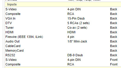

Here's structural description of the plasma TV. I place my problem at the mainboard where all the input connectors are.

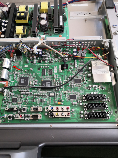

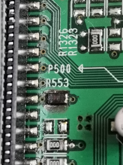

Sorted, sort off. The main board comprises two halves. Aerial on left half and other input sockets on right half. The right half appears to generate TV signals and send back to the aerial thingy on the left. A micro resistor was blown at the ribbon cable bridge joining the two halves. This would account for aerial signals not getting through. It's not yet verified the other sockets depend on the aerial thingy to produce their video output.

There is a slight chance the other sockets don't depend on the aerial thingy. In that case, the aerial input can be ignored, and TV can be viewed via other sockets.
Left:
Right:
Blown resistor:
