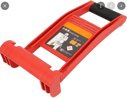

Also, there is nearly always a way of moving things without the need for brute force. Using the right tools and some thought will usually get the job done. I.e. you could think about a board dolly:
https://www.racking.com/product/board-panel-dolly-1076
Something could easily be cobbled up from scraps?
Thanks RandomGrinch, that's a good idea, never thought to look for something like that. My driveway is on a hill so I was dreaming up some kind of panel dragging winch system, something like this could really work though.
Alternatively, if you were storing the boards in an upright rack in the garage, just put some (braked) castors on the rack!
Along these lines?
...but heavier to handle up the hill.
