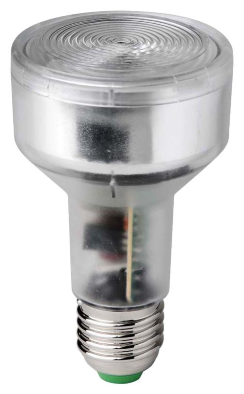

Time to return to earth. He is talking about 6 lamps. How do you expect to really work out any average with just 6 items? It's far more to do with luck.
If you use 100 lamps then selecting a manufacturer who claims 20,000 rather than 10,000 hours may pay but with 6 it's just luck. Also since it's a spot lamp rather than a plain bulb the look of the bulb will also be important.
This
4892657006322_001c_v001_zp
looks very different to this
and unlike with my plain bulbous shaped lamp selecting a decorative one is not just a matter of fitting and wattage but also what it looks like.
At £10 per lamp they are not cheap 15,000 hours at 6 hours a day = 6 years but at 24 hours a day = 1.7 years and of course the seller has no way to know how long the lights are on per day. So I would not consider replacing any lamp bought in April 2009. And that does not take into account any voltage problems. Clearly lost of neutral with a PME supply claims would be made to electric supplier not bulb manufacturer although I am sure that has not happened running lamps at 253 volt would reduce their life yet would still be within spec. Also spikes could affect the electronics within the lamps and to replace is mainly a good will gesture rather than something that could be forced.
