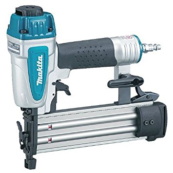

Ordered myself the Makita AF505 18ga. I think it should be about right for what I'm trying. Might also consider a crown stapler down the line.
Find a compressor is now the goal. Seem to be a lot of 'cheap' compressors around the 25/50l capacity mark over 9CFM. Will they last is the real question.
