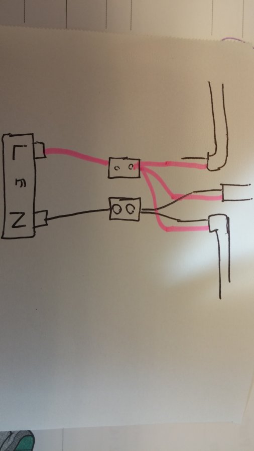

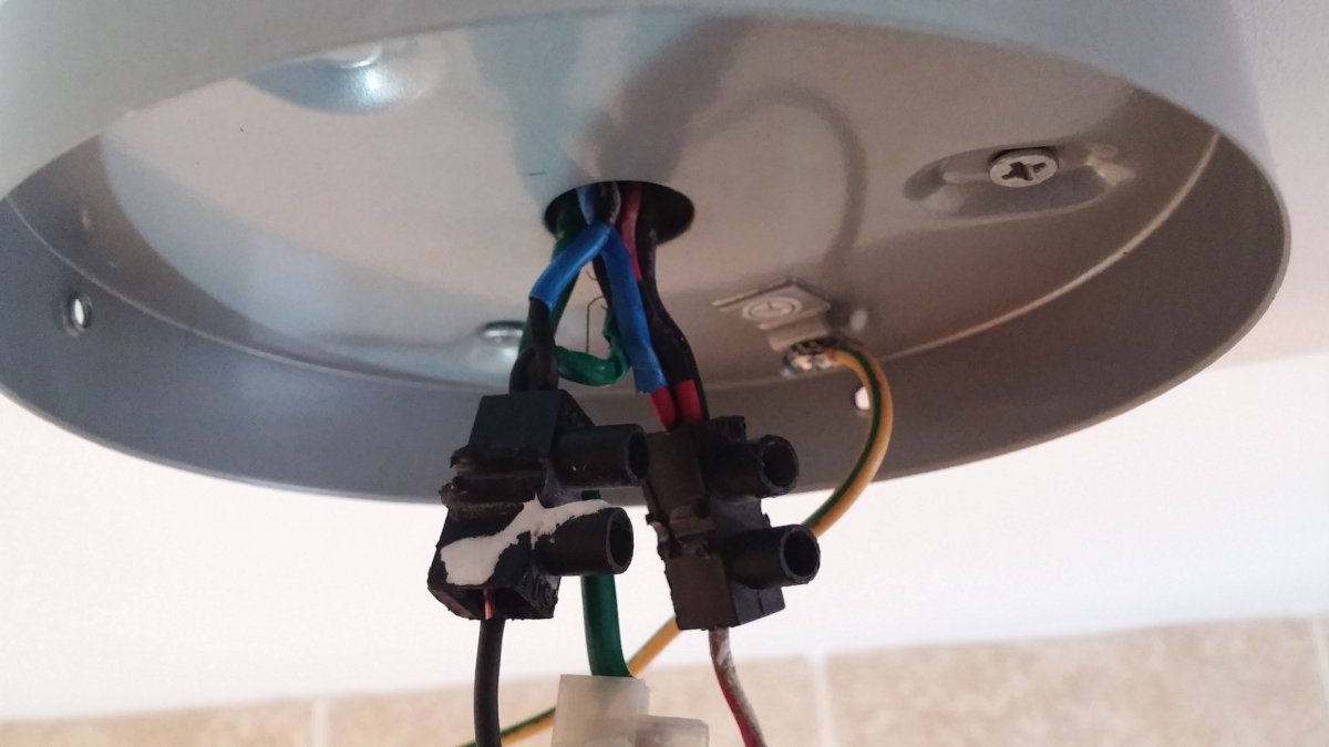

Hey,
Tried looking through to find answers to my problem but as i'm a complete novice in regards to electrics I found it hard going.
So i'm replacing a light that someone took down, no cables marked, and I'm struggling to get it all back up and running.
I've got 3 red and 3 black cables to sort, which will run kitchen/hall/utility room lights, and one light fitting for them to all go into!
Currently i have 3 red into the live connector and 2 black into the neutral. This gives power to all lights but the utility light won't turn on/off. Wherever i put the remaining black results in no change or it trips the fuse, utterly at a loss.
So my question is "can someone offer advice as to where to put all these cables?"

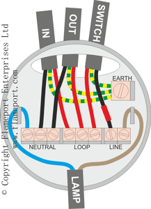

Obviously it is not possible to tell from here which of the blacks are neutral and which is switched live.
If you are not certain the two blacks are the correct two then please get an electrician.
You need to do this:
Note the three reds are connected together but not to anything else.

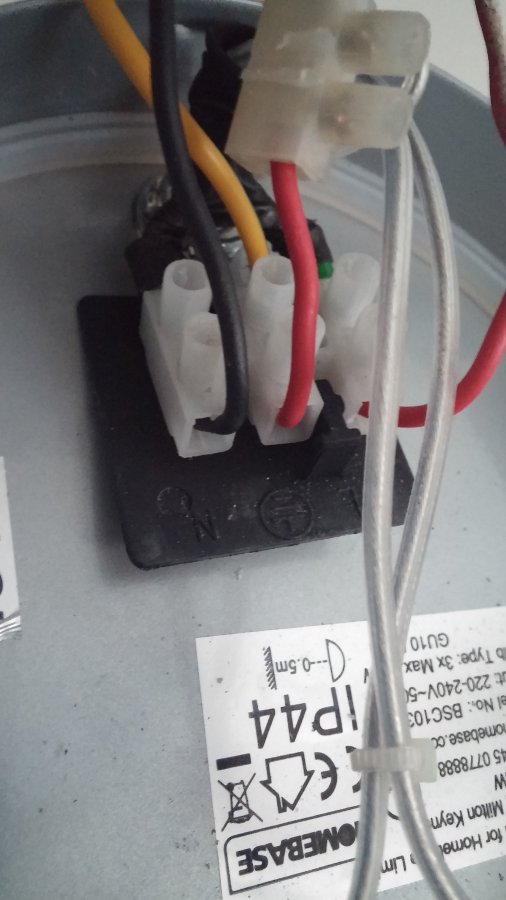

Thanks for the response. I'm trying to become a little bit less useless on the housing repairs front, already becoming passably decent at plastering/joinery, hence trying to sort this out myself. I'm getting a multimeter tomorrow, to try and figure out the cables.
The light fitting literally just has one part for each Live/Neutral/Earth. Which is why i'm having a bit of a hard time figuring this one out as all the diagrams I've found don't really show this.

Just like to say a big thanks guys, the images/documentation you linked me to have really helped. Problem all sorted and functioning lights that work as intended!
And this page is exactly what you have, and needed to follow
http://www.diynot.com/wiki/Electrics:Lighting-Rose
Don't be confused by the switch cable having two red wires.
