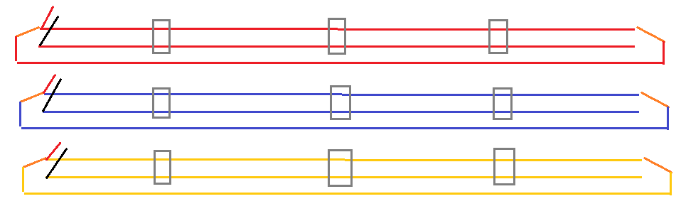

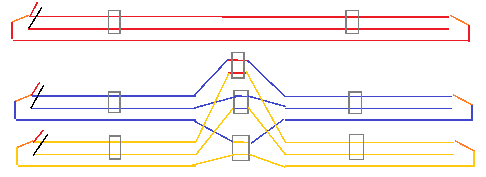

Totally agree. The only time I've ever described the chosen colour scheme as wrong was for 3x 2 way circuits with multiple intermediates wired in 3C&E where the installer had chosen to use all reds for one circuit, all blues etc
It made fault finding very tricky when the site maintenance guy replaced a broken 3Gang switch and wired it the 'proper way'.
SOMETHING LIKE THIS POSSIBLY:
