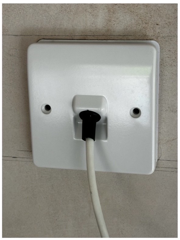

I’m having some lights installed in a kitchen.
So far only the first fix is in - I’ve got T+E popping out through plasterboard in roughly the right areas.
I need to get some surface mounted wires up onto a couple of beams where it would be easier to install white round 0.75mm flex.
Once on top of the beam, they’ll be out of sight - but there will be maybe 12” or so visible to get the flex up there from first fix point.
I’m wondering about fitting dry lining back-boxes to conceal the (Wago) termination of the T+E to flex.
Then run the flex out through a flex outlet plate - but I can’t find anything suitable.
I could use a Coax plate (with the Coax guts removed).
What’s the best way to do this safely and neatly.
Thanks D

Flex-outlet plates have connectors in them -
and you can get ones where the flex exits from the edge.
Thank you @pete01 and @EFLImpudence - it didn’t occur to me to use the connections already provided in a flex-outlet plate.
I was thinking only about the plate to conceal the Wago terminations / neat transition to flex but what you’ve suggested is better.
I’ll look again and see what I can find at Screwfix / Toolstation.
Thanks D

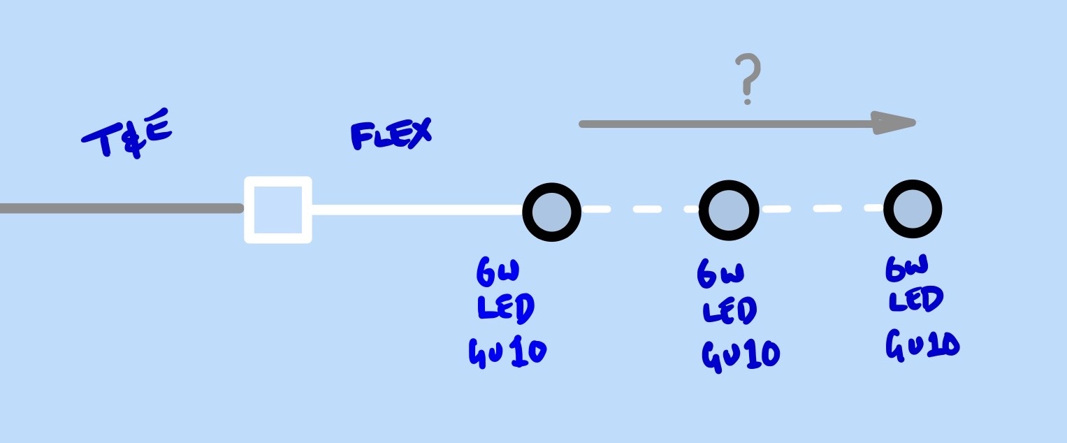

After I’ve transitioned the first fix T&E to a white 0.75 heat resistant flex, I need to tidily run it maybe 300mm to the top of an exposed beam.
I’ll run it along the top of beam maybe a metre where I plan to have a single 6W LED GU10 light.
In the event I need to ‘daisy chain’ another light (or even two) from the first light - would this be okay ?
The ‘daisy chain’ legs would be no more than a metre each.
Thanks D

Thank you - @Sureitsoff?
I’m using them for task lighting over a (kitchen) worktop.
Good to know I’ve got some flexibility to add.
Best D

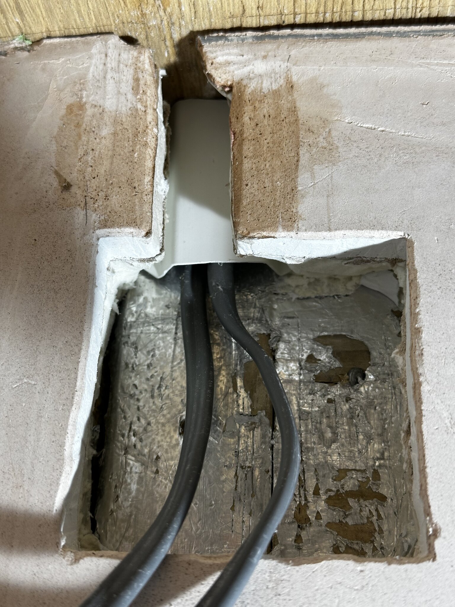

Further to original post and helpful advice (@Sureitsoff?, @pete01 & @EFLImpudence), I’ve cut in three back boxes to my plaster board on stud wall. I’ve made small vertical drop channels of about 65mm to feed the First fix T&E down into each box so my electrician can fit / wire the flex-outlet plates and wire up the lights.
I’ll pop a small section of plastic cable protector in channel, over the T&E then fill it level. Would I need to worry about clipping such a short 65mm drop before I fill it ?
Thanks D
It's not really a protector - just a guide and/or a holder.
Not if it or just the cable will stay in place without clipping.

Agreed, the only protection you might have using capping whether metal or plastic before plastering is from the plasterer`s trowel or a slight protection from accidental damage by others.
I usually took care of my own plastering but if not I only worked with plasterers and other trades who would use due diligence in all things and would expect the same from me.
Members of the public - well that is something else
