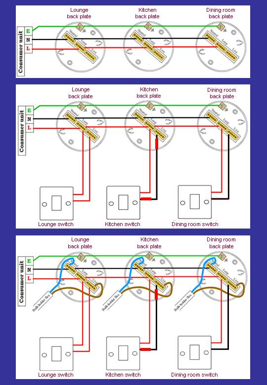

Lounge light gone off, random flickering on other lights apart from kitchen leds, there are no dimmer switches
From Wiki on this forum
lights tend to be daisy-chained ceiling rose to ceiling rose, a tester like this
may find which is last ceiling rose to be working, seems likely a junction box in the kitchen, these
are often used to replace ceiling roses when down lights are fitted. However, if down lights were DIY fitted, we can find wiring like this
which is just asking for problems. But at the moment my crystal ball
is playing up, so can't really help much more.

That depends on the reason for the flickering - if it's just due to a poor connection somewhere, then that is reasonably safe. If the flickering is due to a short somewhere, then that could potentially be serious. With the lights on, if you listen carefully, with them flickering, you may be able to hear where the problem is located.
