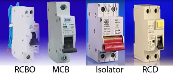

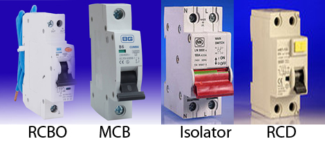

Post a photo of your 63A device and your 6A device and I will explain the difference.
BTW a stock photo from a catalogue is useless. We need to see your own photos from your own installation.

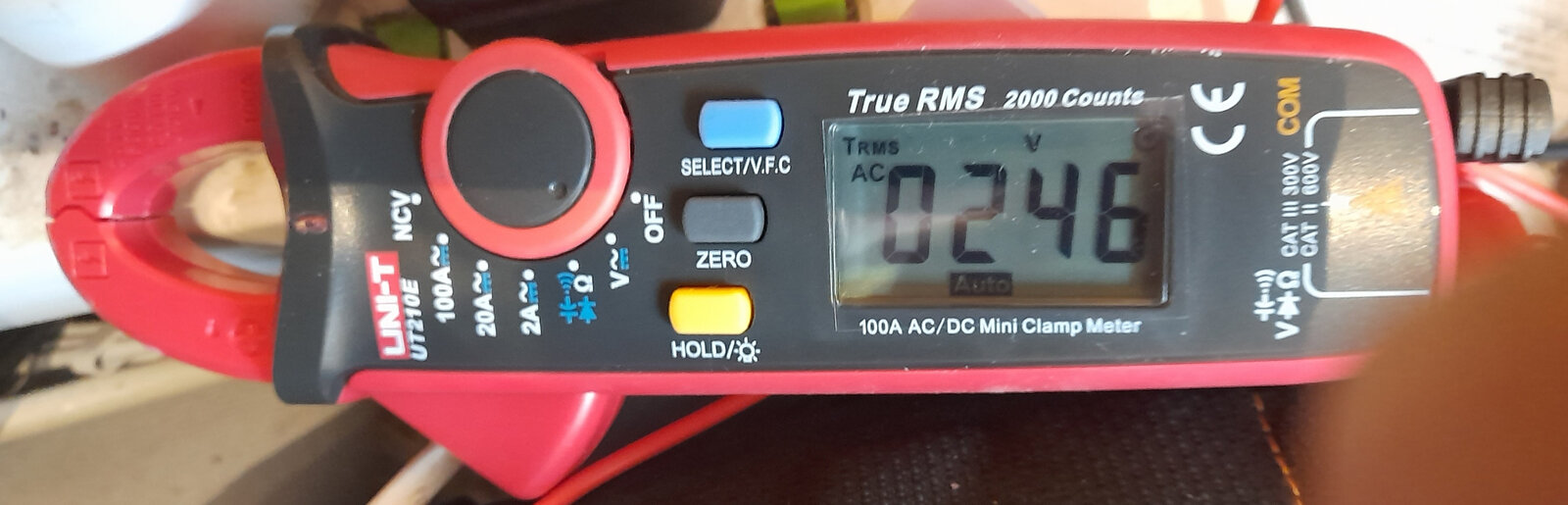

This should help identify what trips, there are three tools, the RCD tester RCD tester.jpgtests the RCD but it is unlikely to be faulty, the clamp on Testing voltage.jpgcan test when live, and the insulation tester VC60B.jpg when dead both testers cost around £35 each but they also need some skill to use them. So the start point is look for water ingress. This is most likely cause, the problem is the insulation tester used 500 volt DC and the house uses AC and the clamp on will only work when it has not tripped.
AC current will always have some capacitive and inductive leaking, so there is a limit to how much can go through a single RCD, so a 30 mA RCD will trip between 15 and 30 mA most likely around 26 mA and up to 9 mA is allowed with AC linking so you have in real terms between 6 and 16 mA before it trips with a installation near the limit.
With RCBO's we are looking at a larger fault before they trip as less background leakage. And when they do trip we loose less, but they cost more than MCB's so once over a 4 circuit consumer unit is fitted you can save money by having multi MCB's on one RCD, with my 14 way board could save £150 but I feel that is nothing to the loss if one freezer defrosts. But when done on the cheap, one must expect them to trip every so often.
The problem is when the leakage is from the neutral to earth, as this will increase with load, and makes fault finding harder. But seems likely simply due to water and a small drain hole will likely cure the problem.

However the RCBO (Residual Current Circuit Breaker with Overload protection) is also an RCD (Residual Current Device) and the item marked RCD ( is actually a RCCB (Residual Current Circuit Breaker (without Overload protection)) which is also an RCD (Residual Current Device).
