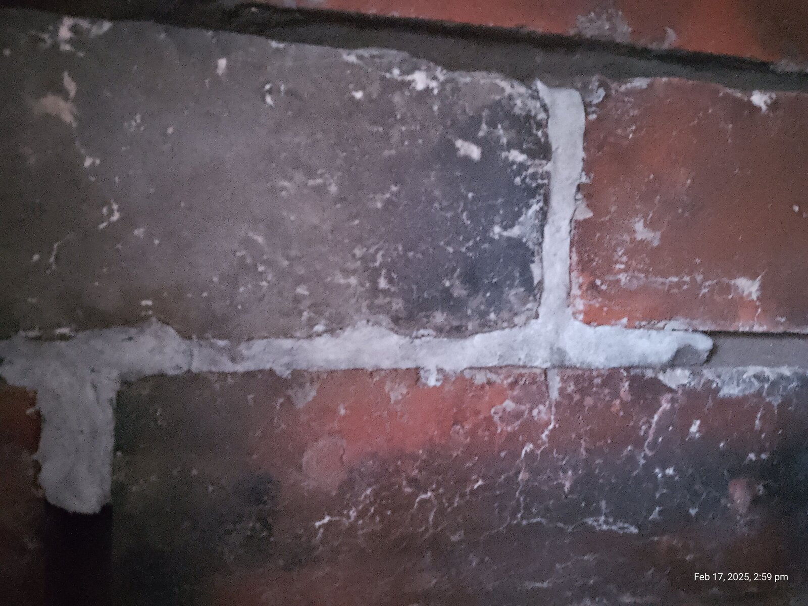

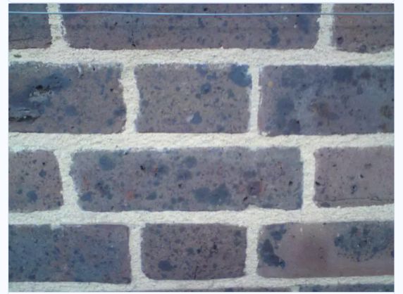

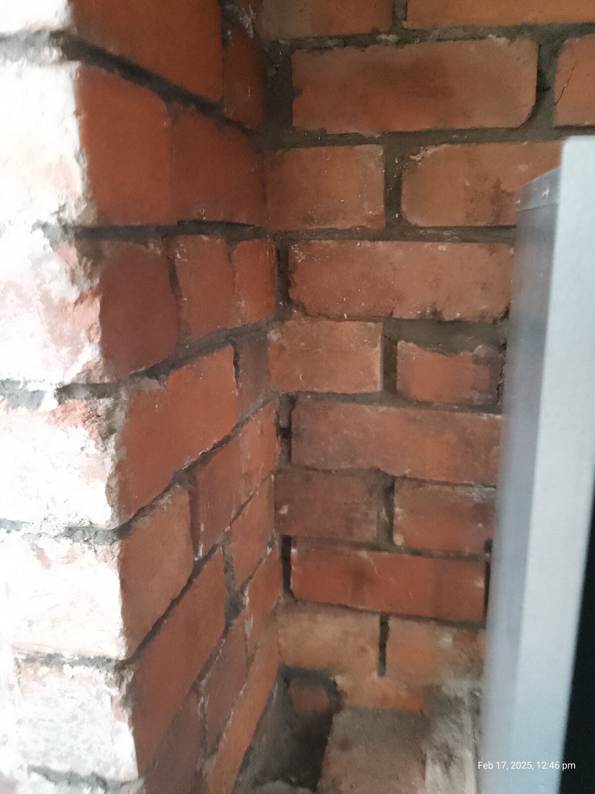

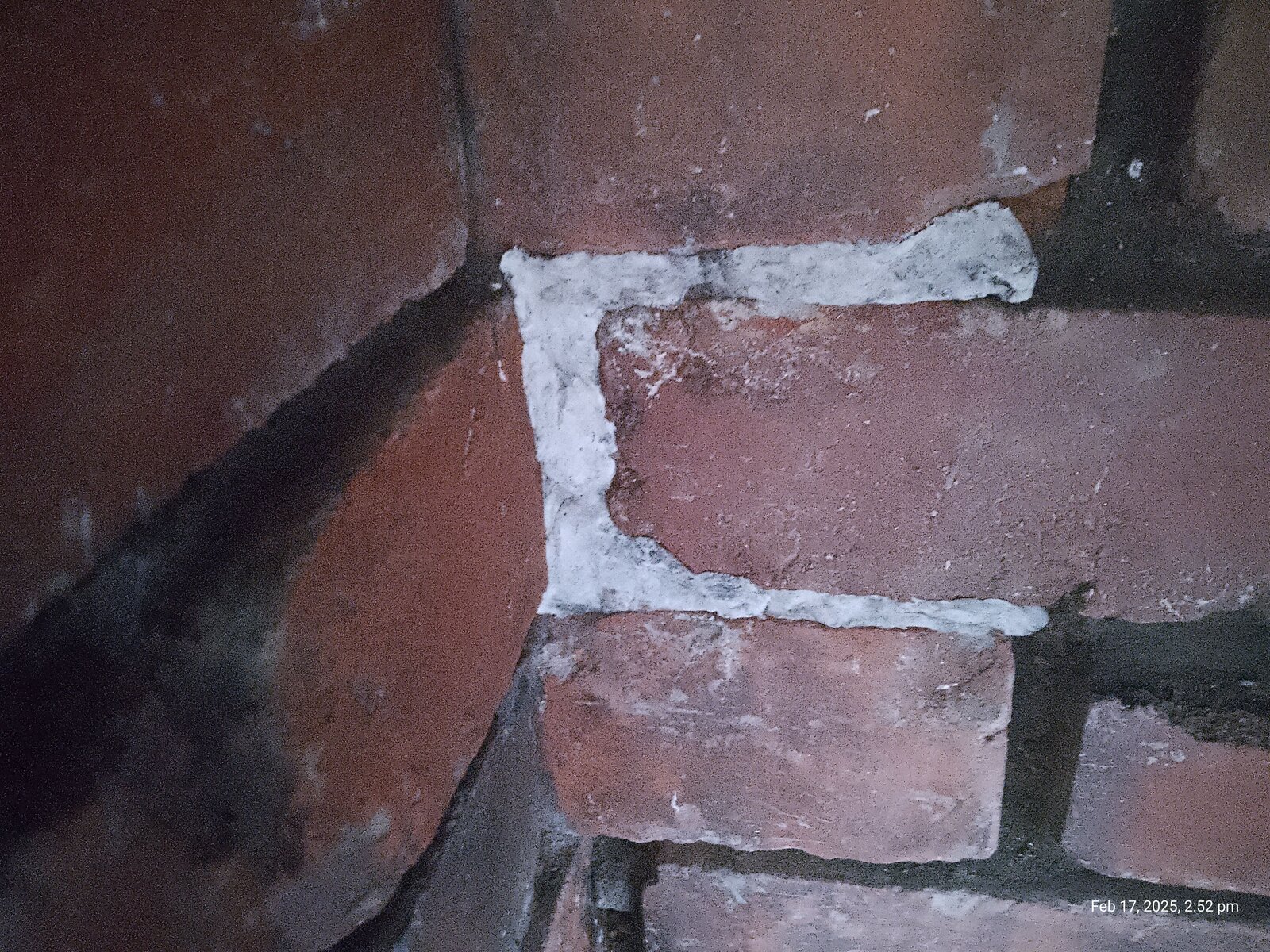

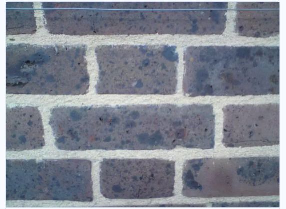

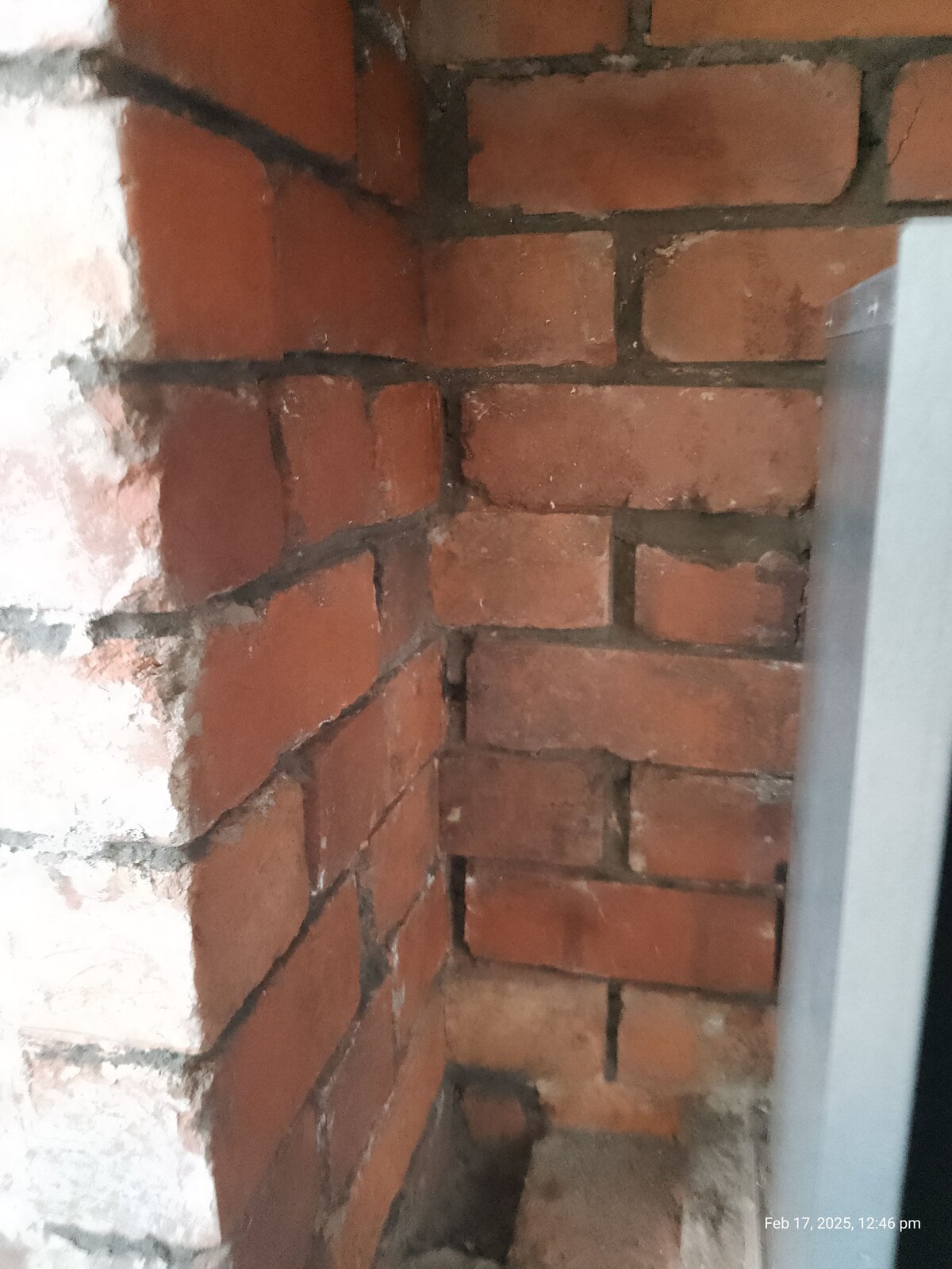

So following advice from a previous post I've decided I'm going to attempt to point my fireplace brickwork using a lime mortar type product. I've cleaned the brick the best I can. It's quite uneven with varying joint thickness but hopefully I can make a half decent job of it. I've used a bit of the kids playdough to show the kind of finish that I would like to achieve. I think I can generally blend this to the unevenness of the brick.does anyone have experience with what would be best product to use and application technique. Ie do I use any type of unibond before application or wet it all down first . Also do I keep it damp once applied. Only ever used sand and cement mortar so any advice would be very much appreciated

Damp down the brickwork before pointing, and then keep misting it for a week after. There are various tools you can use like pointing trowels, finger trowels and a hawk etc. Might be worth watching a video on utube.

Cheers. I've watched numerous videos. Think the best option is hydraulic premixed. I just can't seem to get a video of how to achieve this type of look. I presume it's just applied as carefully as possible keeping it off the brick and then not sure if it would be scrapped or just whacked with the brush
