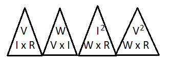

A few months back I was helping my grandsons homework and he showed me a pic of the triangles the teacher had drawn on the board
V, W, I², V²
IxR VxI WxR WxR
He was struggling to use the third and getting the wrong answers, you try getting a youngster to believe the teacher got it wrong
V W I² V²
IxR VxI WxR WxR
Am I the only one who dislikes this notation?
The usual notation in physics is
P = V x I etc.
and
Power = Work done / time
P = W / t
Perhaps we should just use the SI units instead?
W = V x A or, V = A x Ω
V, W, I², V²
IxR VxI WxR WxR
Hopefully this works better
