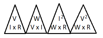

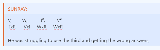

V, W, I², V²
IxR VxI WxR WxR
He was struggling to use the third and getting the wrong answers,
you try getting a youngster to believe the teacher got it wrong
Why?
It's obvious that the last two can't both be right - otherwise I² would equal V².
Incidentally, why does it space the text correctly in the quote but not in the post?
Ah, it only did that in the reply box; not the post.
Why?
Hence my second version with triangles.
Tonight I looked through the selection of photos of the white board on his Ipad again, probably 40-50, initially her values, then got each student to nominate 2 values from I, R, V & W. Then she (actually a very young and attractive she) guided them through working out the other 2 values.
Apparently; 25A and 100W = 4V using 2nd & 6.25Ω (should be 0.16Ω) using 3rd but 4V and 6Ω = 0.67A using 1st & 2.67W using 4th.
also; 1A and 15Ω = 15V using 1st & 0.067W (should be 15W) using 3rd but later 15V and 15Ω = 1A & 15W using 4th and allegedly none spotted the similarity or error
I worked through those 2 with him

There were other examples, IIRC 100V/10Ω vs 10A/1KW,
however there were several examples with 1Ω which actually makes no difference to the result if equation 3 is wrong.

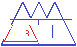

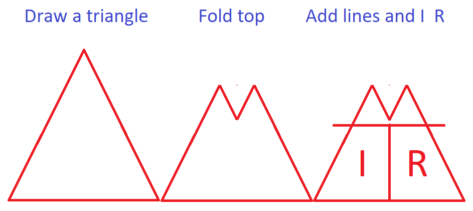

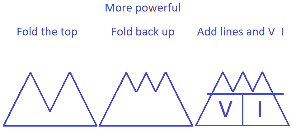

Experimenting
Thanks Robin but I'm going to need more info
Code:
  V
IxR   W
VxI
Code:
 V   W   I²  V²
IxR VxI WxR WxR
[CODE] V W A A I x R V x I I X I I x I[/CODE]
Well it looks like I've got there but it seems one has to remember a fair bit while typing.
As to whether I remember how for next time is... now was I going up or down stairs

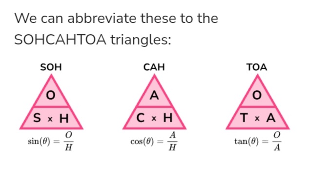

The very first time I learnt the triangle method was:
Promptly followed by:
Then I sat doing homework with a friend and we did this:
to save a step in our calculations and showed that symbol in the working to demonstrate the step taken.
So that you can see all three equations at a glance.
That's presumably the idea, and it's quite a common 'tool' that is used.
