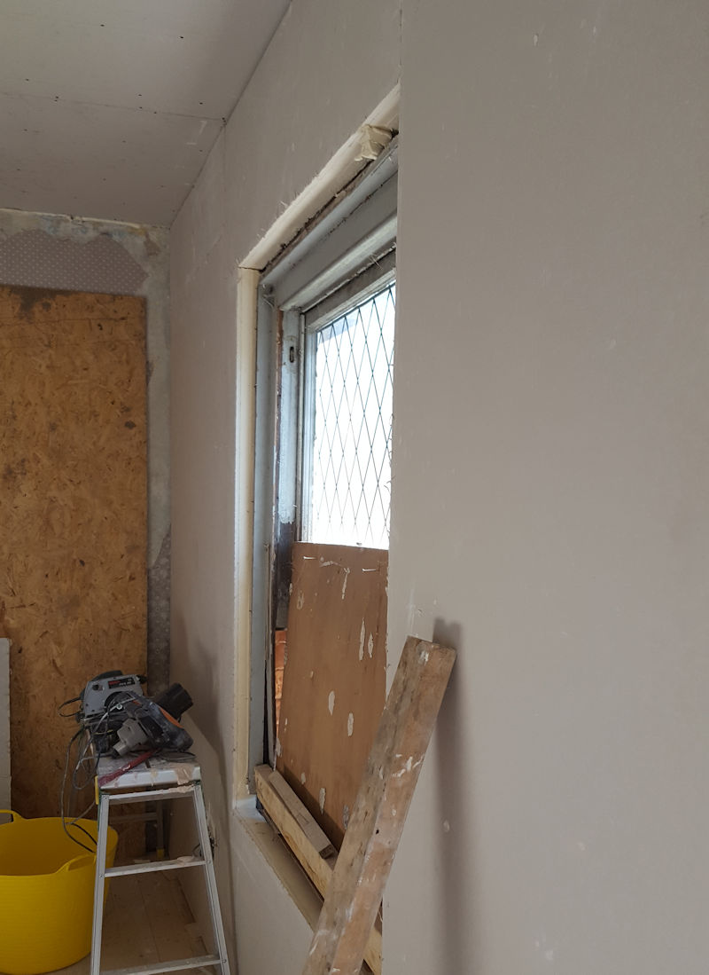

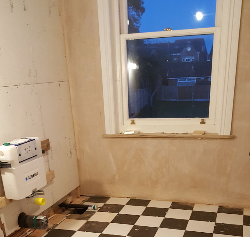

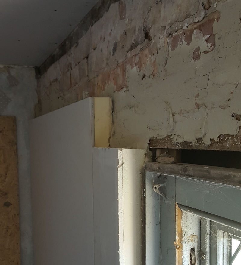

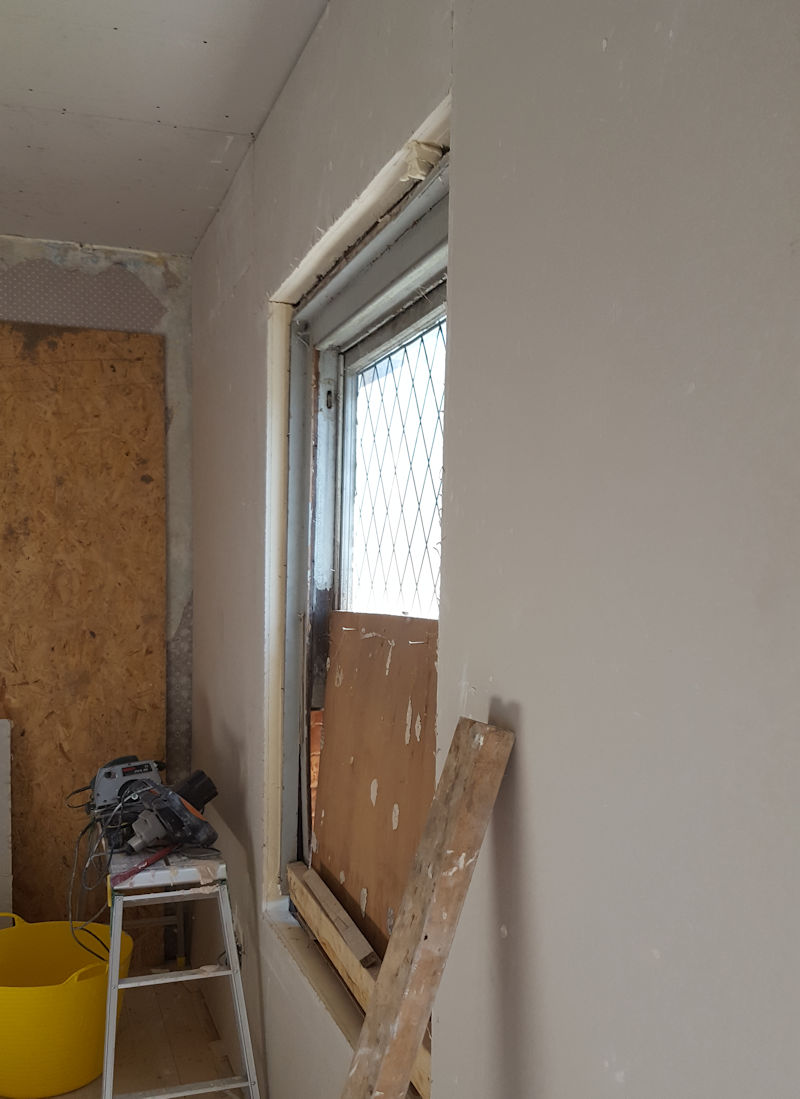

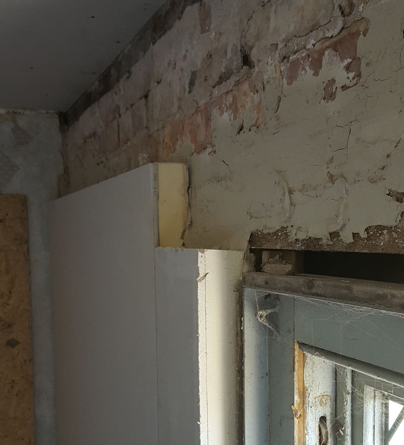

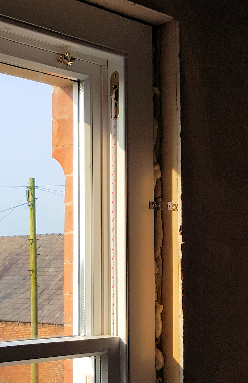

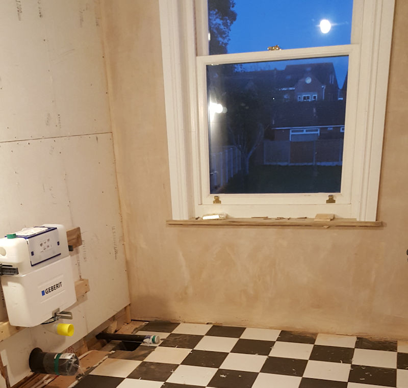

I used loads of Everbuild Dry Fix to fix insulation to walls, then plasterboard to insulation - not moved yet. I also did my own test, sticking a strip of plasterboard to a but of wood, then tried to pull it off. Didn't budge.
Here's one of the bedroom refurbs I did: https://photos.google.com/share/AF1...?key=dDkzRm83QWU4SVRGQ0N3aUhPaktjbmRseWM0OFV3
This was the 2nd of 3. First was rough, last was amazing. Had a plasterer board the ceiling and skim the walls, but did the rest myself.

You did a nice job, but I dispute the much cheaper. At my merchant 60mm PIR is £21, 12.5PB is £5.6, so £26.6. Add in another £3 or so for the second layer of foam fix and its close to £30. 72.5mm insulated PB (Siniat Xtratherm) is £37. (all +VAT). The insulated PB is dead flat and goes up like lego onto dabs, which is far more forgiving than foam on an uneven wall. The other advantage with using PB adhesive is it stays where its put once knocked in to place, whereas foam - even the proper adhesive type, will expand and push away if not held in place. Each to their own, but unless everything is flat and true, installing two different layers with foam adhesive to me seems more hassle than it's worth. Foam has it's place, and I've used loads, but it isn't a universal solution.
£37 is a good price for that. I did order some from my local builder merchants, but it was very flimsy and low quality insulation (no idea of brand) so sent it back and went for separates. At the time, 30mm bonded to plasterboard was about the same price as 50mm kingspan + plasterboard. Prices probably changed since.
