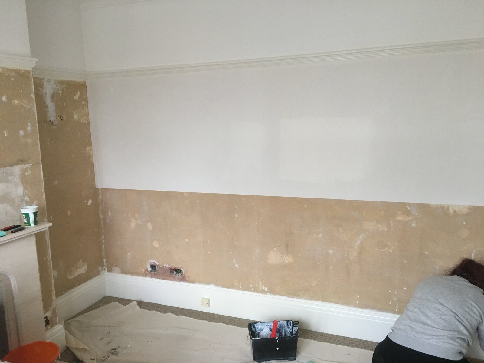

Why cause extra work, no need to size, use Wallrock fibreliner cross line 1m sheets, long pile roller sleeve and use Wallrock ready mix paste simply paste the wall and hang. Then paint

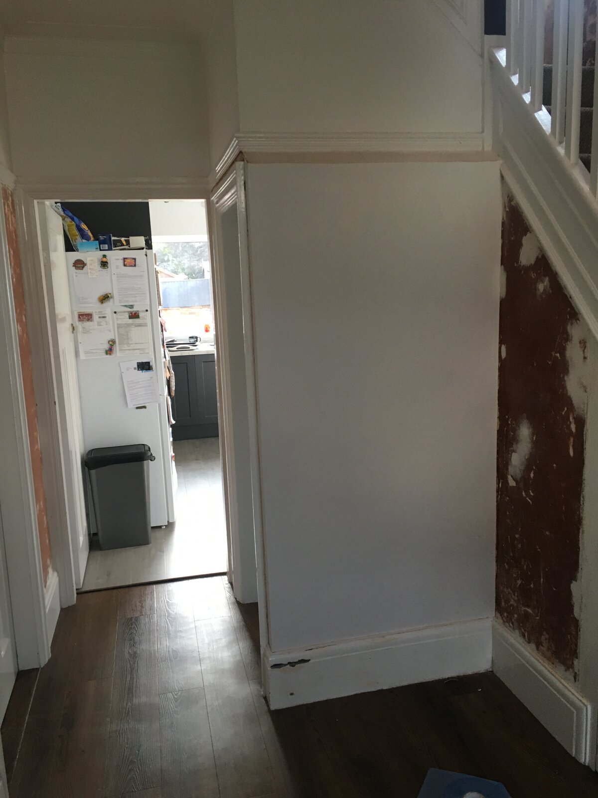

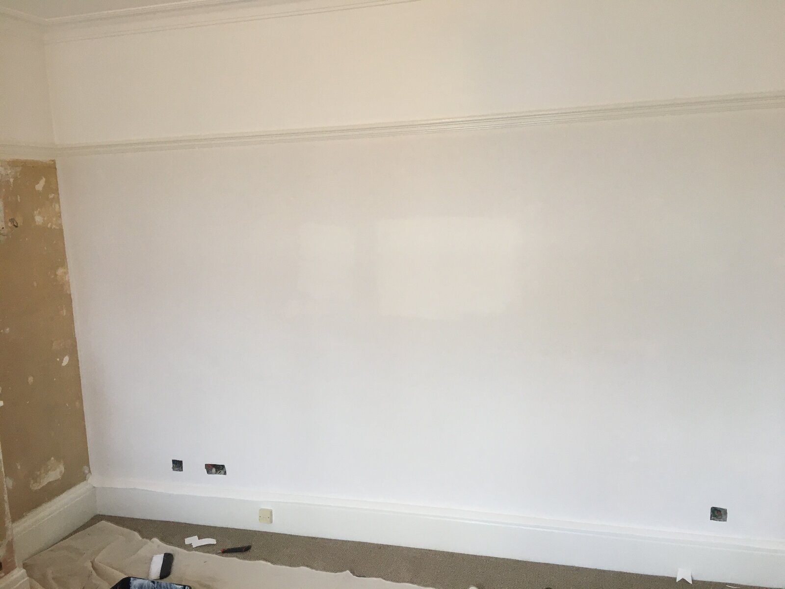

sizing is the best way but last 3 rooms I didn’t have size one time so did without and had no issues and since then no issues as when I x line it rolls out nicely, but with the 1m lengths you only get 1 join below the picture rails, I have had a couple of times has issues with grit where I hadn’t hoovered the walls sufficiently. I have a couple of bits on the room I showed you which I am going to cut around this time and skin with toupret and a fine rub down with 400/240. Normally I get a flat plastic card and tap them out before painting. Literally just trim the pieces 20cm longer and get the lining on the wall paste brush lightly no need to over brush it then wet damp sponge down the corners a couple of passes caressing into the corner then a long steel ruler or can be done free hand a small while later with a snap off knive snapping regular on each cut. Once dry a thin bead of caulk doen the edges and quick swipe down with wet finger and good to paint. Once u get the paper in position for the first couple of feet correctly it sljust rolls out but be careful to make sure you get the paper on the right way. Also on a couple of jobs have struggled to get the butts up nicely as been awkward locations such as behind a curved rad in a window so toupret filler rubs doen like a dream can be used and fine sanding you can’t even tell once the Matt emulsion goes on, I still have to prep it same as yourself, sanding and filling it’s not magic solution to that.

Nice example if cross lining below picture line in most old properties straight across the rail the cut the bottom one 20cm longer on skirting and into corners you can get nice butt joint across then wet the corners and top of skirt give it 2/3 mins then brush into place and press into corners then trim with knife once painted looks better than plastered walls if prep is done right
