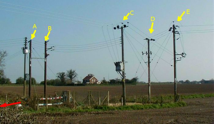

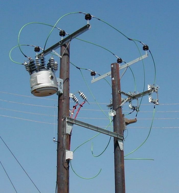

In rural areas the DNO's are using radio-controlled sectionalizers more and more to enable faults on the 11kV network to be isolated more quickly from a distance and power restored quickly to those on unaffected feeders. Here's an installation in progress from near to where I used to live, must have been about 7 or 8 years ago, possibly a little more; you can see the antenna for the control receiver mounted on the left of the pole in the second picture.
