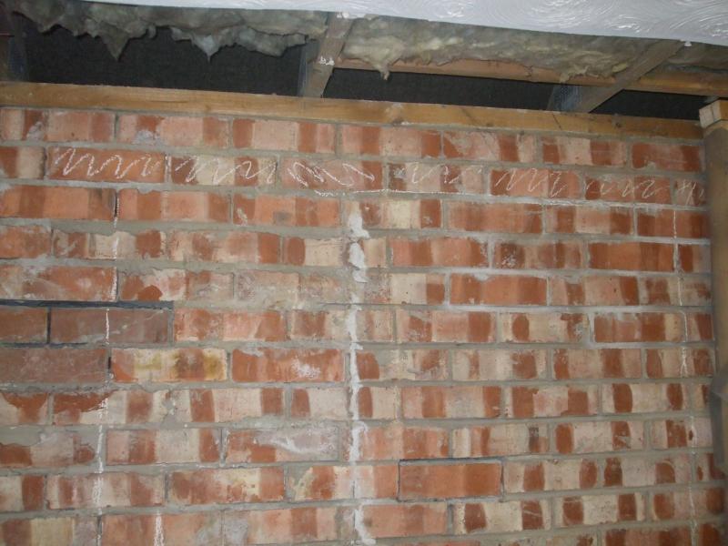

Hi all,
I have a couple of lintel questions...
I am opening up a hole in my garage wall to install French doors. The opening for the doors will be 1200mm so I am intending to install a 1500mm lintel. It's a single story attached garage so the roof is quite low - there is only one course of bricks above where the lintel will go before the roof joists.
Hopefully the attached pic explains better...
So my questions are: -
1. Is a steel-reinforced concrete lintel sufficient (70 x 100 x 1500mm) or do I need to worry about point loads with there only being a single course of bricks above?
2. Are steel props with strong boy type attachments the way to go, or can I get away with just propping the ceiling joists on the inside?
All advice/comments welcome...
Thanks.
Yes it should be fine unless your roof is something out of the ordinary.
I personally would just use the acros with a scaffold board on top supporting the required joists/rafters. For 1 course of brick I wouldn't bother with strongboys which you'll have to end up re-bedding on top of the lintel anyhows. :D

Somebody else mentioned to me (typical, after its done) that the lintel should really be more than 70mm high as there is only one course of bricks above. However surely the 70mm one is better than a double-height one that has the wall plate sitting directly on it? I can't really go any lower, as the top of the wall is already quite low so I'd be stooping to go through the door.
Do you think BC are going to have any issues with what I've done?
Cheers.
There are issues regards single course concrete lintels and the fact that their strength is reliant upon the self-arching assistance from a body of masonry above.
The worst that can happen is you will need to replace the lintel. This can be done retrospectively so i would say suck it and see. The roof ain't gonna collapse.
Cheers, wouldn't a double course concrete lintel have the same issue though, especially as it wouldn't have any bricks at all above it? Or is it just an issue with single-course lintels?
Thanks - I'll stop stressing (no pun intended) then. I think I'll carry on and get the doors installed. My worry was that BC would force me to lower the lintel and I'd have to replace the doors.
Out of curiosity, in the worst-case scenario, what would I replace the lintel with, a double-course concrete one, or a steel one maybe (bearing in mind its a stud-wall inside).
Thanks.
Worst case is they ask for a 140dp lintel with no brickwork over or catnic box lintel.. but i highly doubt they will..
