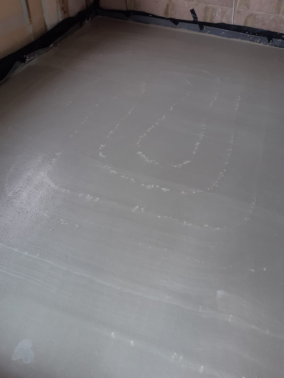

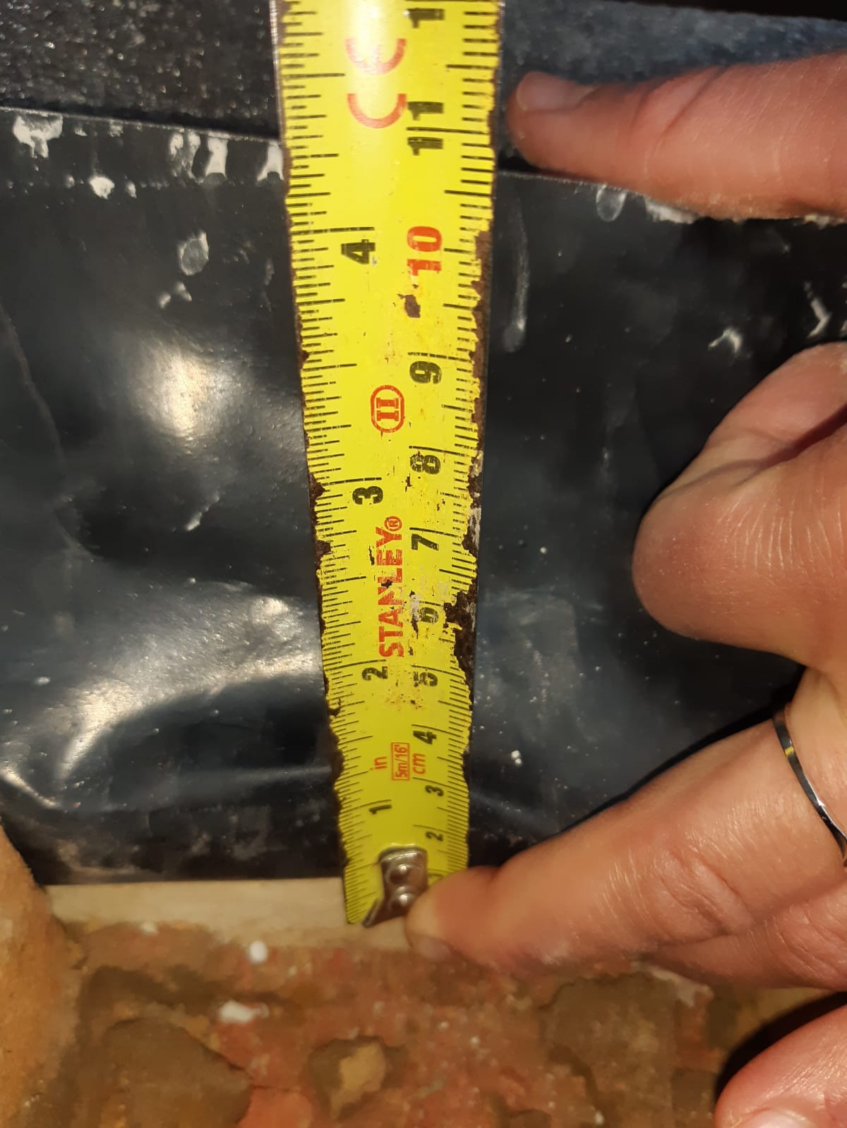

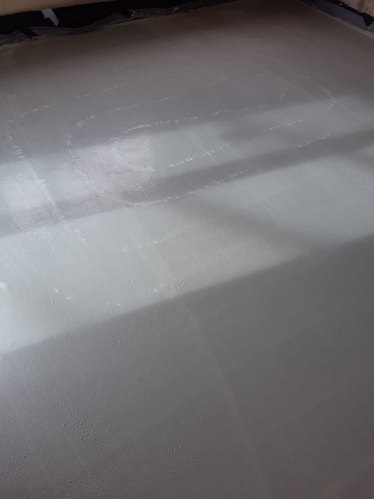

the liquid screed provided by UK liquid screed LTD is very shallow. it was installed on Friday and was told not to check for at least 48 hours. however when I had a look today I noticed the under floor heating pipes of my sitting room are showing in nearly 2 third of the area., see attached pics. I contacted the company now and hope to hear from them. I am rather worries as the building reg inspectors will inspect the floor this Friday. my question is what is the remedy for such a case so that I know what to expect from the UK liquid screed LTD.

How thick were you expecting it to be?
FYI, I had 65mm squirted in and it didn't have any bubbles where the pipe coils are, I also used trays though, not clipped straight on.
If you are under I would think you could add another layer, but the screed guys will know more.
30mm seems thin to me. I'm not aware that there is a 'regulation' thickness but it obviously has to be suitable and functional. In these cases you would have to go with manufacturer's specification - for both the underfloor and the screed. Starting point for me is find out the product manufacturers and look up their specifications? I do have a recollection of a 35mm screed on a job a year or two ago - so it's not a million miles out.
As for solution - you could add a latex finish over.
I thought the whole point of pumped liquid screed is it can go much thinner than sand and cement.
Doubt the building inspector will be interested in the screed
Not really, cs bonded screed can be as little as 20-25mm. The advantage of liquid screed is in the placing and finish and that it is particularly suitable for underfloor heating applications because it encompasses the pipes more efficiently than cs screed. The question here is if 30mm is sufficient for the heating function?
many thanks for your in put guys. UK liquid screed has come back to me and they re assured me that they have at least 40mm in that area. the also said that the screed they provided can work even at 20mm. most importantly they took full responsibility to handle any complains from the building controller. based on this I am satisfied pending the building reg inspector visit.
