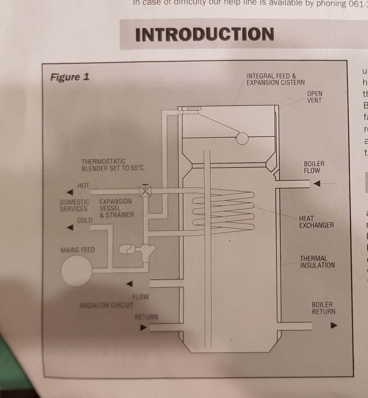

I have a Vaillant ecotec plus 418 boiler and my system is the image uploaded below. I will get a picture of the wiring in the boiler asap. I have a primary circulation pump that runs constantly when the timer control is on just circulating the thermal store to the boiler and back and a second pump that circulates the same thermal store water around my central heating system and back to the store. My hot water is mains pressure heated via a coil inside the thermal store.

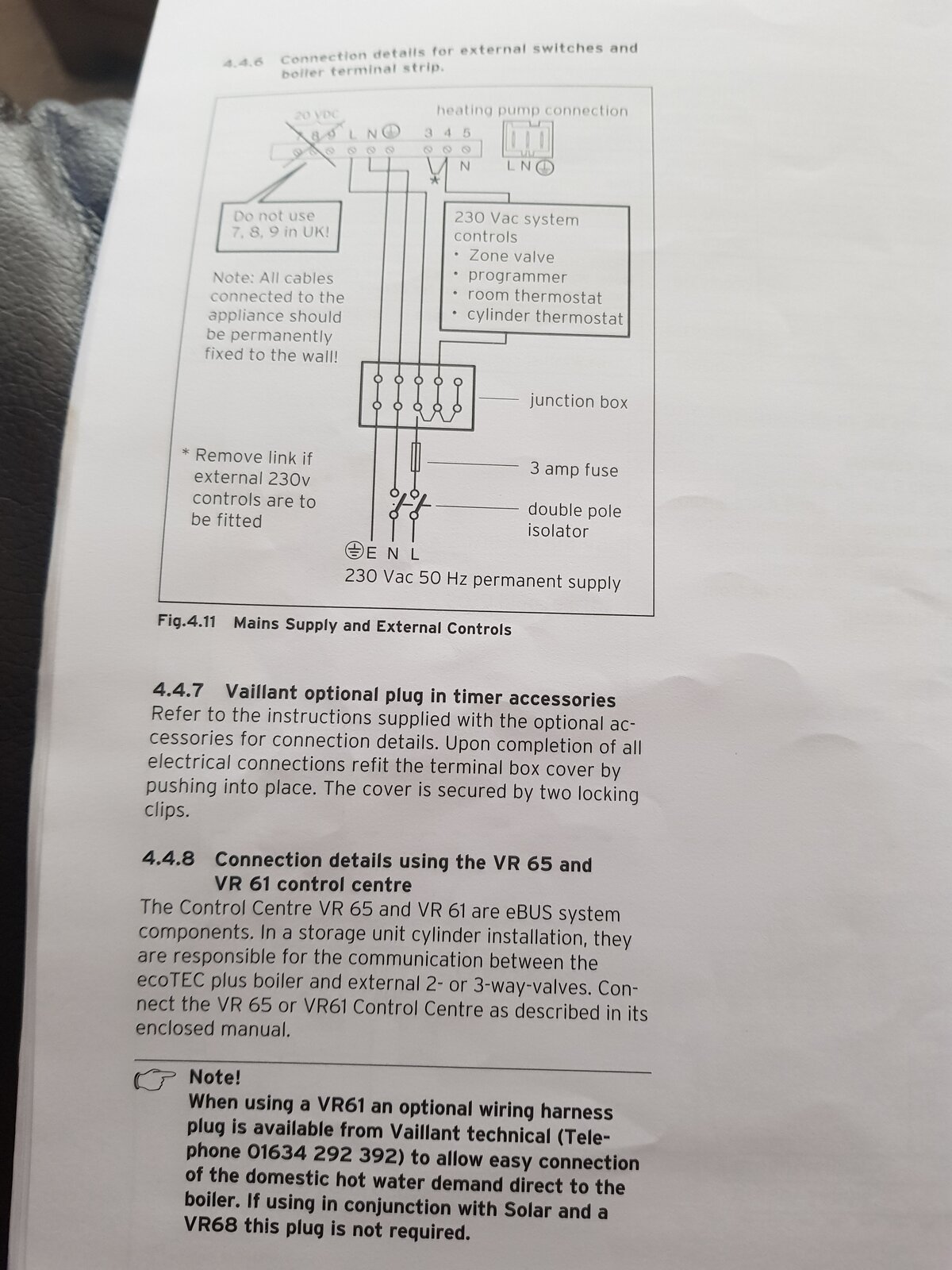

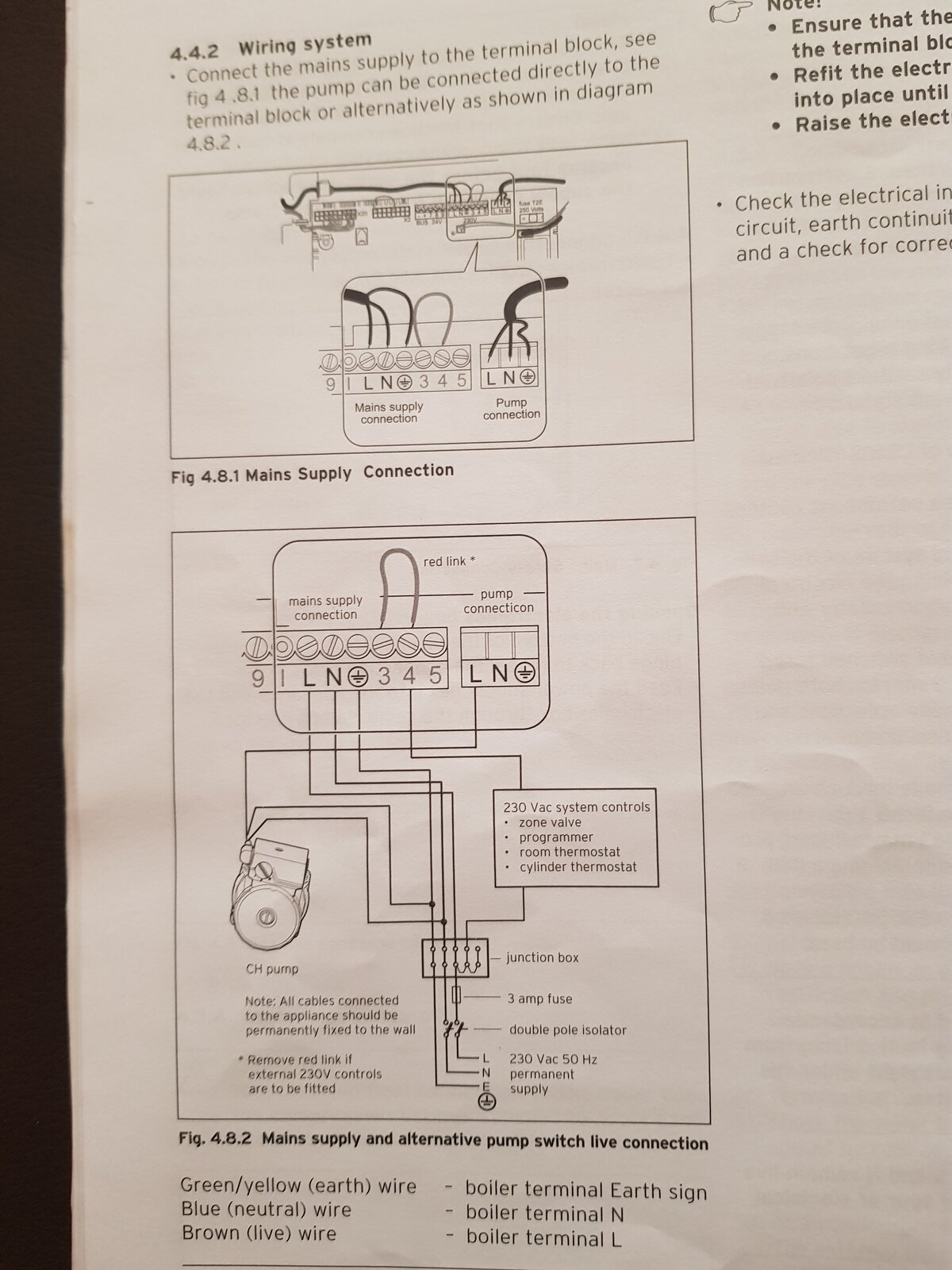

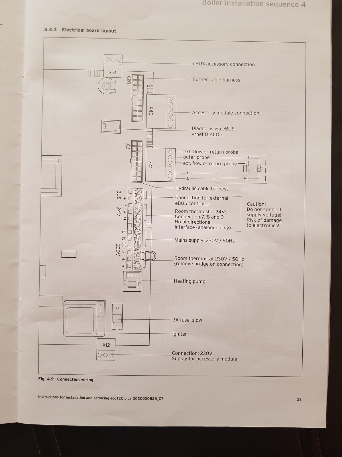

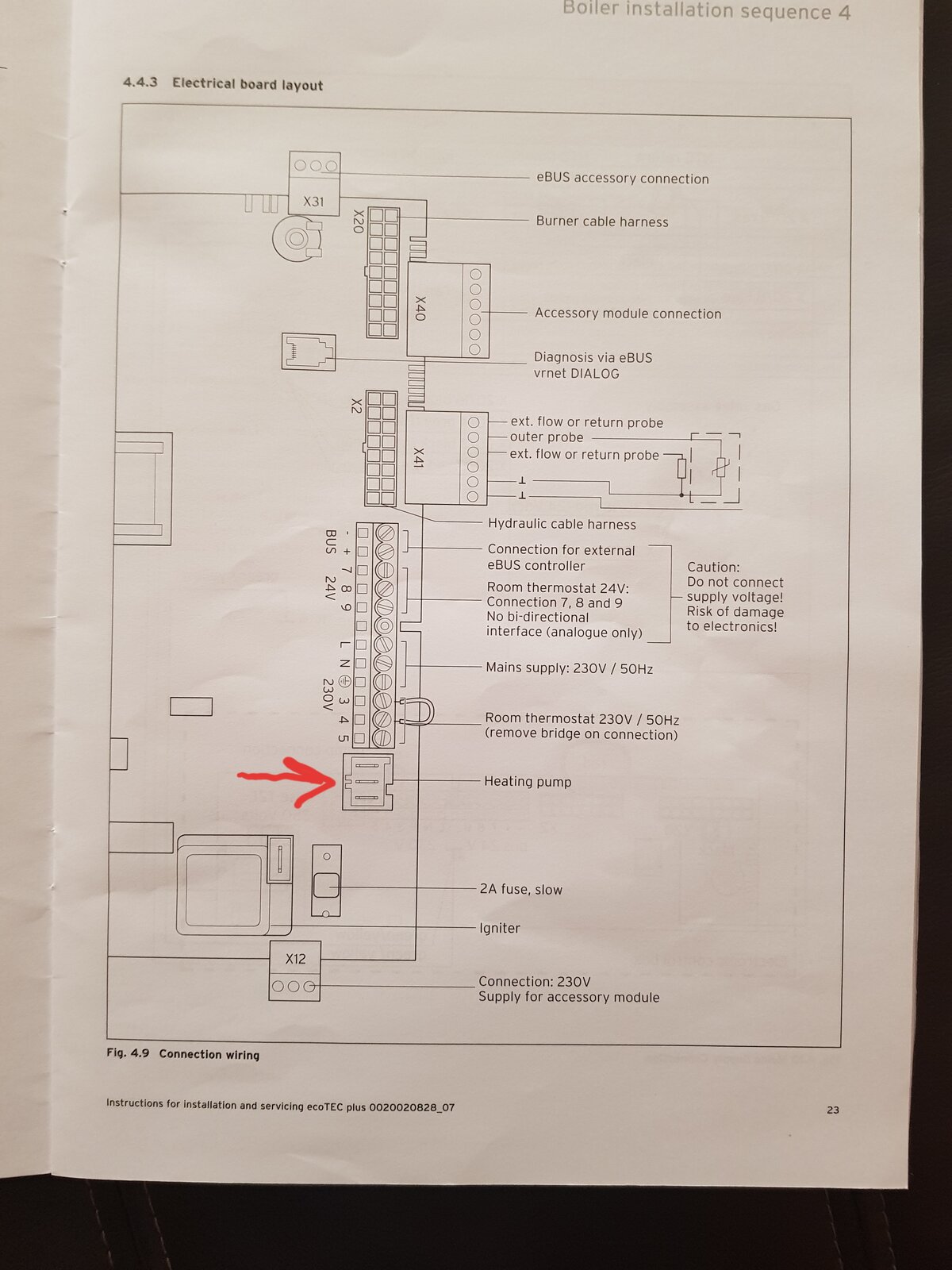

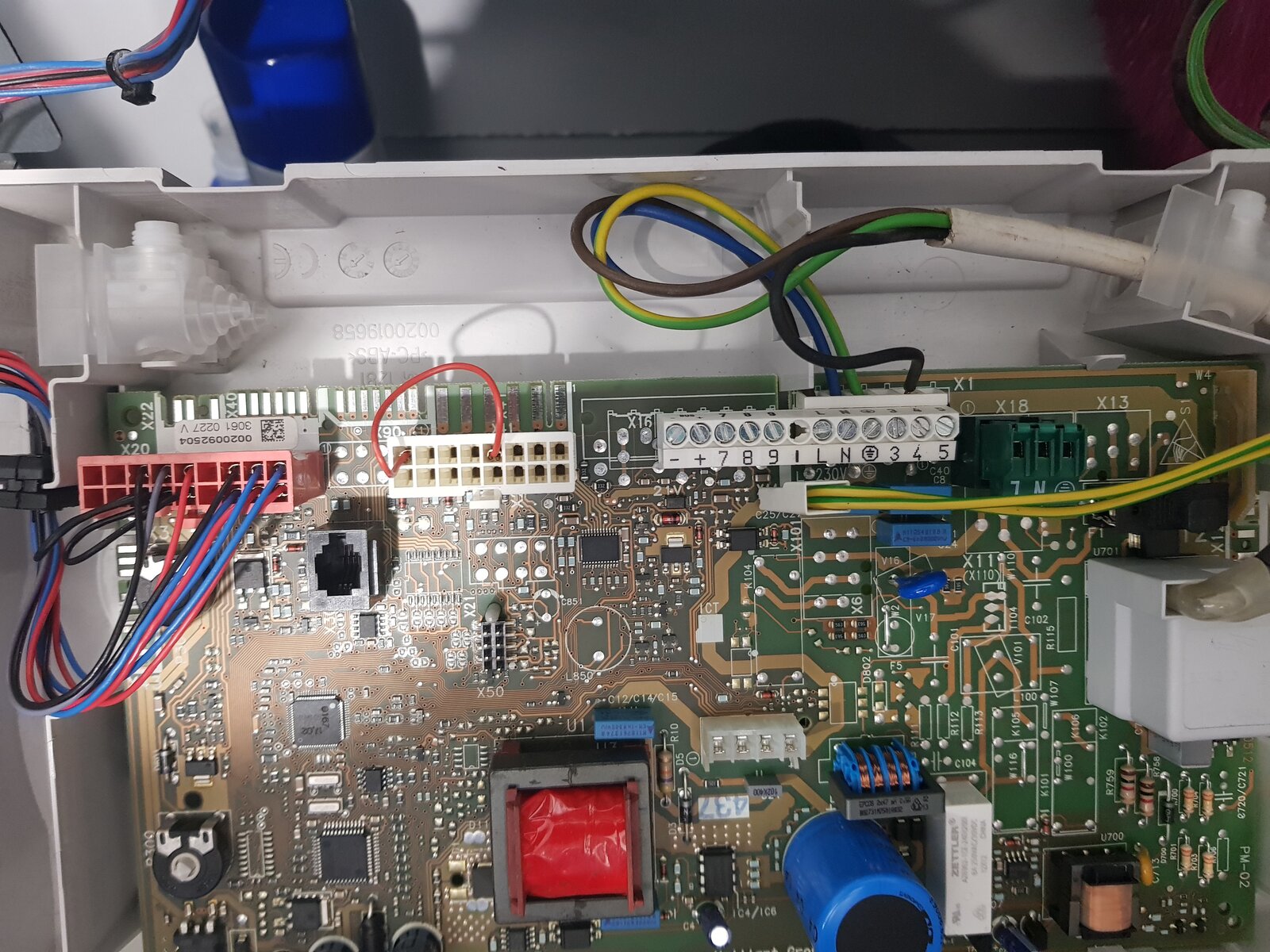

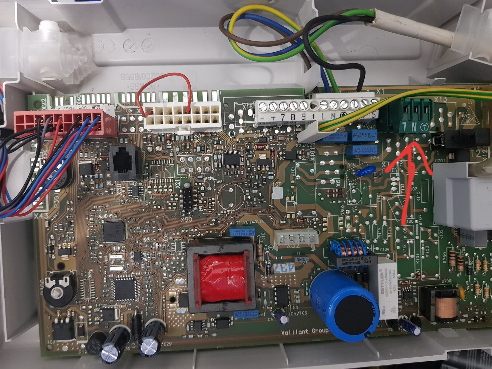

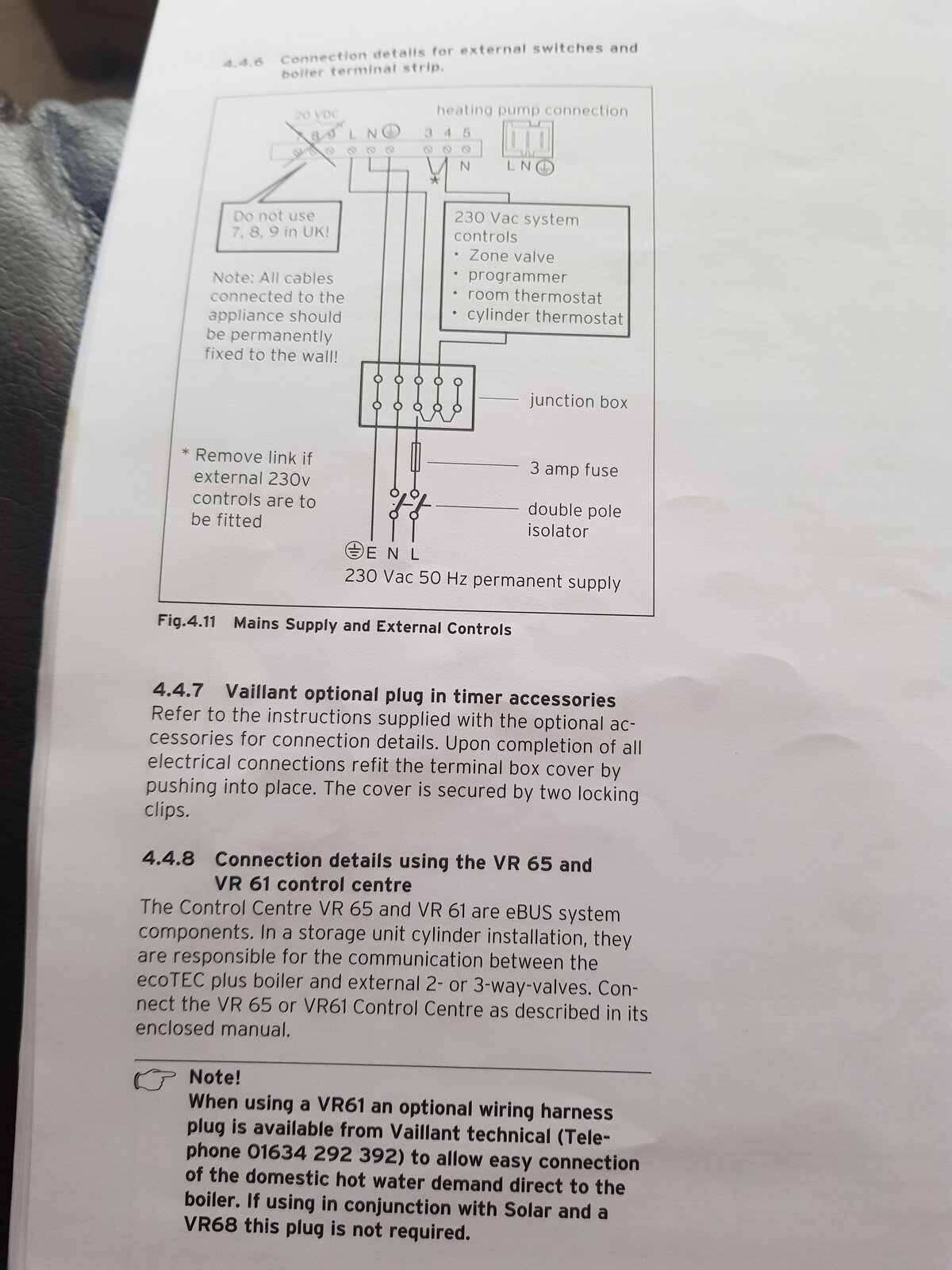

I've attached images of my electrical board and the current wiring also two pages from the manual. I've timed the pump again tonight and it runs for 4mins36secs once the timer switches the boiler off, exact time as before.

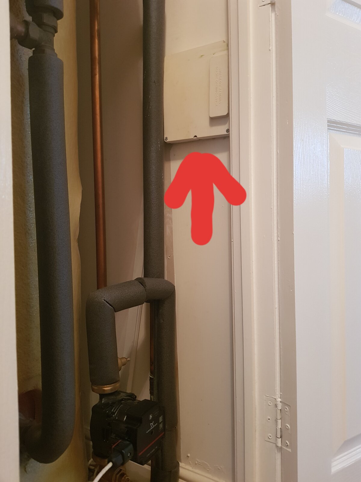

Pump is wired into panel indicated with arrow, I can remove front tomorrow if required but granddaughter is in bed now and dont want to wake her.
Think the answer will be in yon wiring centre...out of curiosity do you know if the controller, motorised valves etc predate the boiler or was the whole system redone 7 years ago? I can see why the engineer told you what he told you- you're lucky they've done the job under warranty, whoever wired it hasn't followed MIs by the look of it

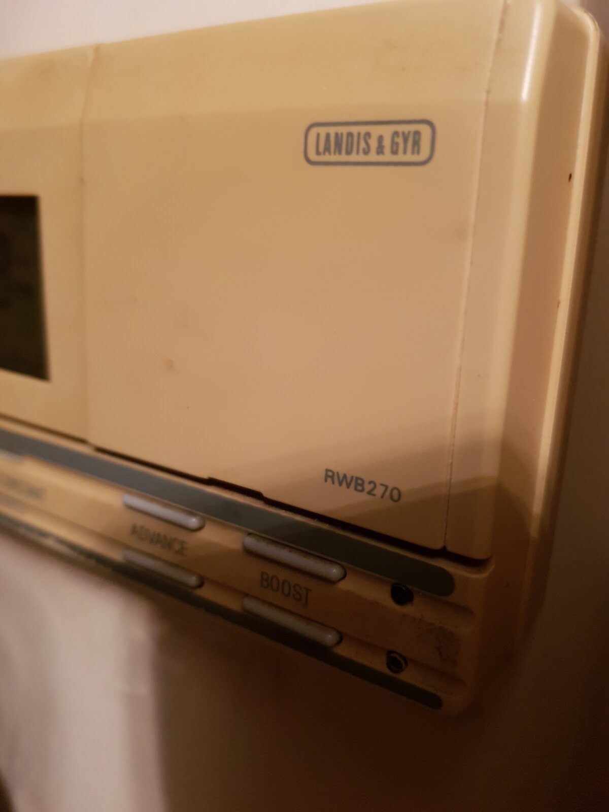

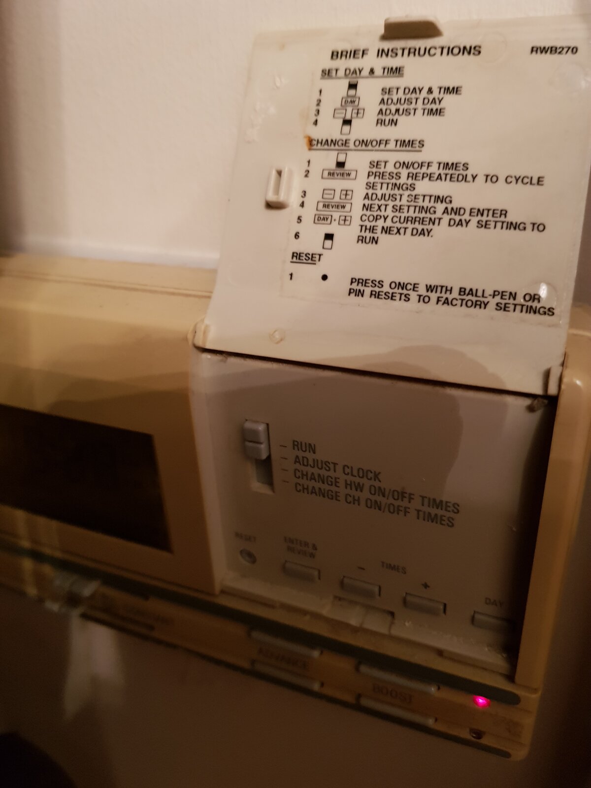

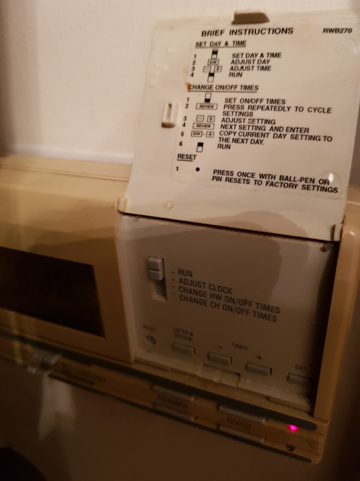

That sounds right, its always much easier to start from scratch than to work out someone else's control scheme. Back in't day the boiler did what it was told by the controller (bit like old cars- foot on throttle=fuel and air to the engine). Nowadays there'll be a wee computer in there (just like your modern car- foot on throttle tells the computer you want to go faster, it has a look at whats going on & decides the appropriate action). Do you know the make/model of your timeclock? (Again just curious)

Do you realize that the manual you show is not the correct one for your boiler? The PCB does not have a terminal block for the pump, while the manual shows one. It's proably because yours is a different version of the 418 boiler. If you can provide the GC Number (on the data plate) we can identify the correct manual.

Sorry for the delay, I've attached images of my timeclock. Thanks

I'll get the number tomorrow but the manual I have has the boiler model on the front ecotec 418 plus and I thought the images below are showing the terminal block both in the manual and on the actual board?
